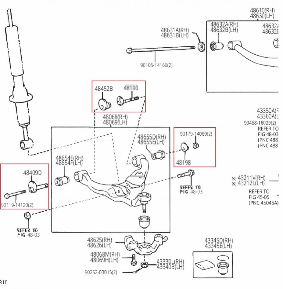

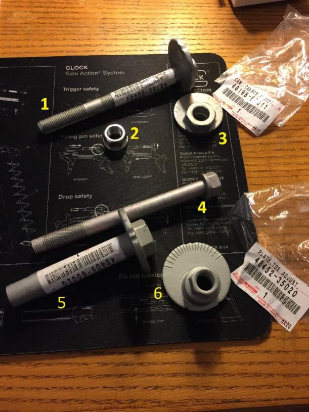

OK, I can confirm the same parts listed above from the dealer. Here's the info with all part numbers and a diagram with parts in red. This is the list for one LCA, double the quantities if doing LCAs on both sides. I ordered these online through the dealer, so it saved a little money. Total for both sides comes to $151.08 after tax.
1. Camber Cam Assembly 48190-60020 - $13.03
2. Cam Nut 90179-14069 - $1.75 (invoice says 90178-A0001, both work)
3. Camber Adjust Plate 48198-6011 - $12.56
4. Control Arm Bolt 90119-14120 - $7.42
5. Toe Cam Sub Assembly 48409-60020 - $16.57
6. Toe Adjust Plate 48452-35020 - $17.67
#2,3, and 6 should be salvageable...save about $30
cant remember if i could save #6...it could potentially be saved depending how the bolt is cut and if there is enough bolt to possibly vice grip
