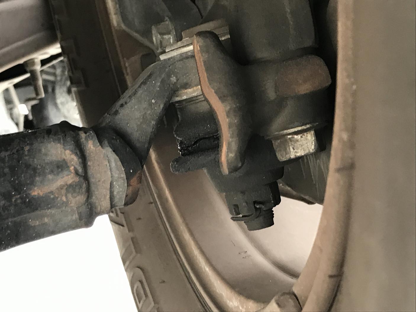

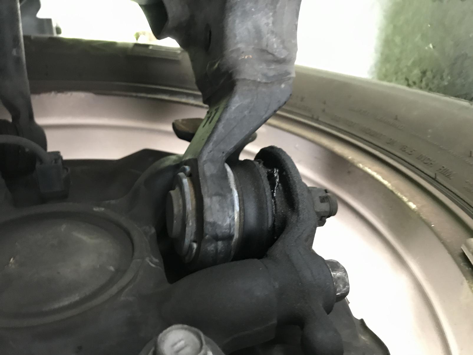

Here are some pics. Looks like the boot is just ripped.

it doesn't look too bad. I would check to make sure the joint is still tight and smooth, then just replace the boot.
the nice thing about these, unlike the previous generation, it wont disconnect from the vehicle when it goes out.

Thanks for checking, I appreciate it!
Yeah, I saw/read up on some horror stories 3rd gens went through with their LBJ... catastrophic for sure.
