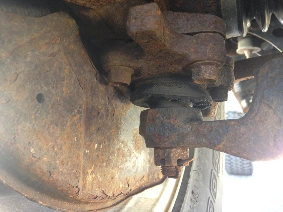

Trying to find out if it is normal for the arm to be greasy like this. Lifted the tire, tried pulling through the bottom, didn't look like it had any play inside. Boot seems to be intact
I'd say its probably expected to see some evidence of grease after a few years, but if you're seeing something similar to the pic on pg 1 of this thread, change them. As several members have said on this thread: why mess around when its a safety issue? This is a known issue with 4Runners and Tacos---- better to be safe! If you use OEM, you'll probably never have to replace them again---- and really, this job is easier than changing plugs---- hit those bolts with liquid wrench and let them soak for a few hrs, Smack the side of the TRE arm on the BJ with a sledge, pop out the TRE, and drop those bolts! Some have said, replace the bolts---- probably a good idea, as someone on here had one break, .....and you're done.

Yeah... that's no good! Be sure to get a tie rod puller and a sledge, that sucker is not going to come out without a fight with all that rust!
Get a pitman puller (maybe that's what you are referring to?). I hope you didn't mean a pickle fork, they don't seem to work as well. Slap the pitman puller on it and hit the side of the LCA mount with a hammer and it should pop right out. Mine were just as rusty and this worked like a charm.

Trying to find out if it is normal for the arm to be greasy like this. Lifted the tire, tried pulling through the bottom, didn't look like it had any play inside. Boot seems to be intact.
Thanks for checking.
With that many miles on it (probably original LBJ) you may have an issue with removing it from the lower control arm. All my ball joints were seized into the control arms. They all functioned properly but I couldn't get them removed. I ended up having to use a machine press after cutting the ball joints. Another guy I meet was able to get his lower out by undoing the nut a couple of threads and putting a Jack right on the ball joint with the strut still in. This will use the springs tension to press the ball joint out of the lower control arm.
