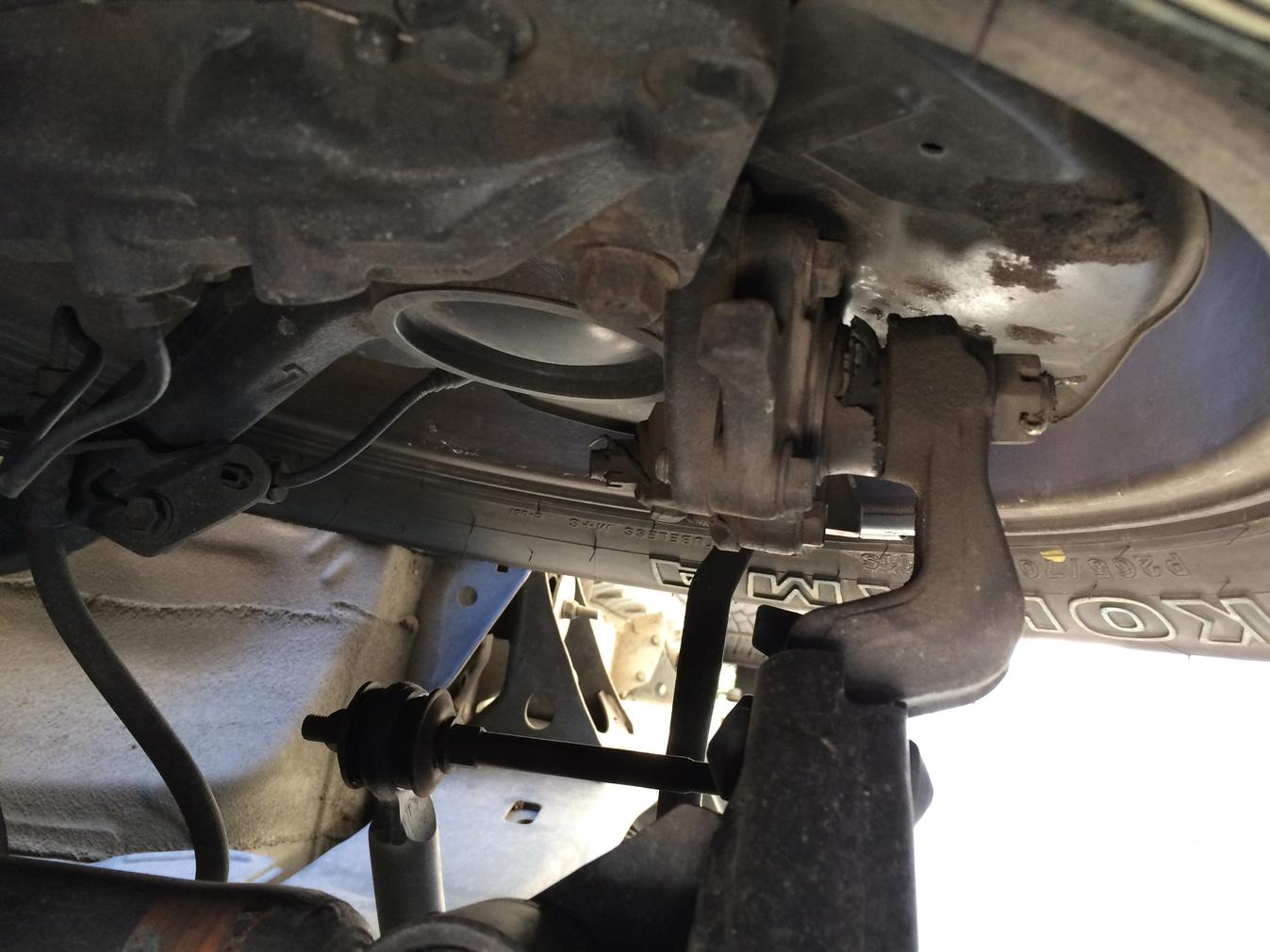

Mine need attention real bad they appear to be torned
