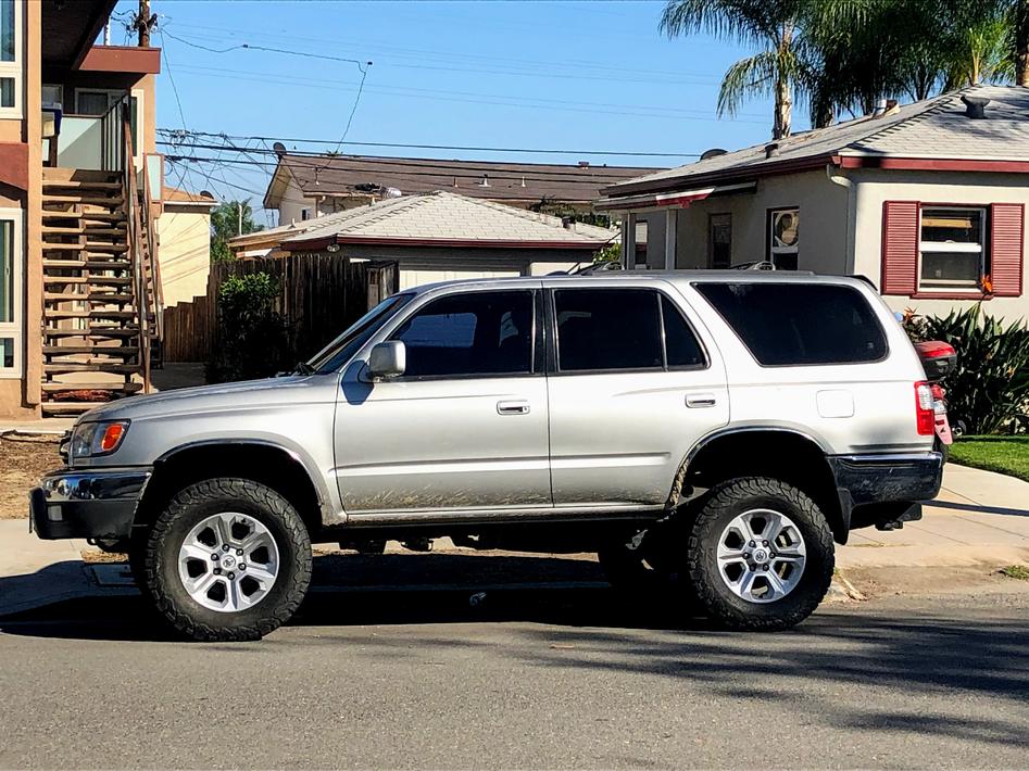

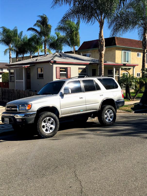

bringing this one back from 2013! I got the same thing going on 25" in the rear. I have the cone bumpstops in. is it safe to take them out? 22" in the front 25" in rear that is will a full size 265 75 16 KO2 in the spare spot. I mean it has not settled yet. so maybe 1/2 after settling.
worried that taking cone bumpstops out is not a good idea, and also will alignment be an issue with 3" of rake?
Oops forgot pics
