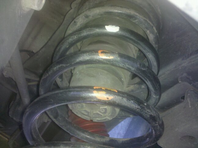

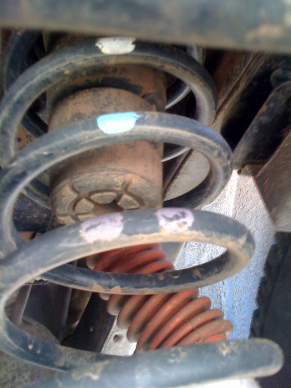

so these are prob mine then...
the 1st pic being Driver side, 2nd pic passenger

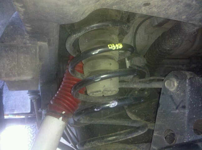

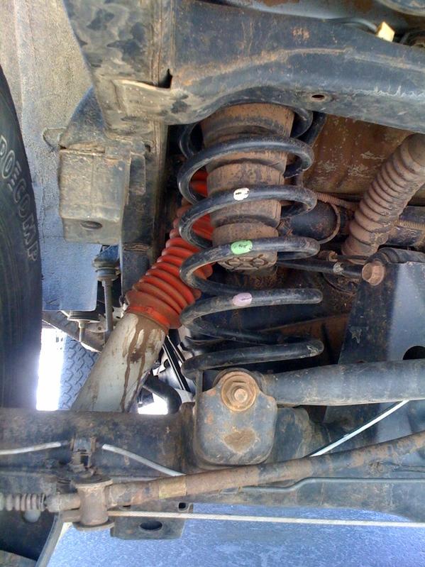

Drivers side then passenger side
i didn't get a picture but i have purple green white on the drivers side and orange orange white on the passenger. i think there is a little gangsta lean to the passenger but its not bad. i was at 34 inches ground to fender before the lift and i am now at about 39.5. i did have sagging springs though so i would say i got about 4.5 inches of lift
