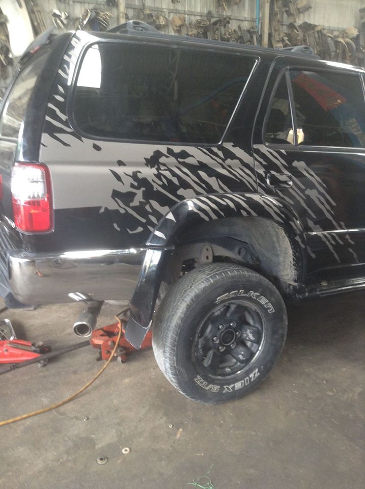

Hi I did my swap this morning.
I swap with my rear with a Front LC Coil and LC stock rear Shock.
Looks SUPER hight. Is this too hight?
I'm looking to do lift the front also.
What is the maximum Spacer that I can lift withe front stock 4runner strut?
3"? Do you need to do anything else to lift this front?

GOT-DAYUM!
If you're going THAT high I'd hop on over to millerpka's 9 wrap build and see what he did with his front. My only other recommendation would be an SAS. Do you drive like that!? :wow:
I would just get springs instead of spacers since you're so close anyway. You can get 3" eibach springs for around $160/set and adjustable tundra Bilstein 5100's around $200/set

You need to change the whole Strut right? You cannot fit a longer Springs on a stock front shock no?

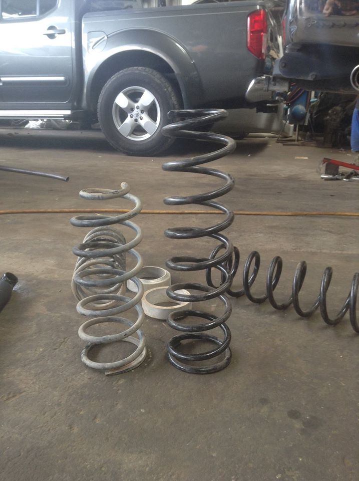

Here is the height of my rear now. It's around 25.5 inch from wheel hub. Is this acceptable to ride in high speed? like around 60 miles?

Looks like you got 9 wraps. 7-8 wraps are preferrable. Is your rear brake line tight? Be careful that doesn't break, because you have a ton more droop now.
For the front you want Eibach or TRD setup on Tundra Bilstein shocks.
