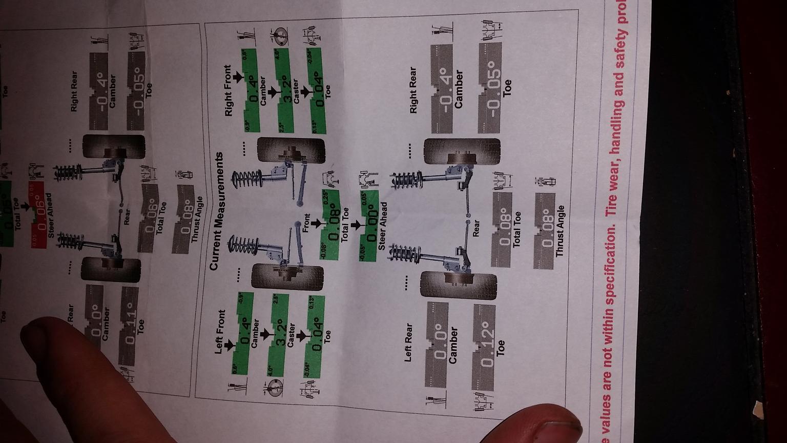

Also the before and after shots of the alignment

Does this seem to jive with what I have for specs on my alignment?:
"IMHO what you want is a touch of negative camber (which should be easy) and fairly equal (R to L). I consider it to be ok if the L side number is a hair closer to zero than the right. It'll equal out with the drivers weight and full fuel, speaking of that get it aligned with around 1/2 a tank.
-The toe-in should not be near zero even though that's "within spec". It needs a touch of toe-in for stability.
-The caster should be the highest positive value (within spec) they can achieve AND be equal. So, what will happen is they'll need to determine which side can achieve the least amount of positive caster and then match the other side to it."
The reason I ask is now I am getting ALOT of rubbing after my alignment that I didn't have before.

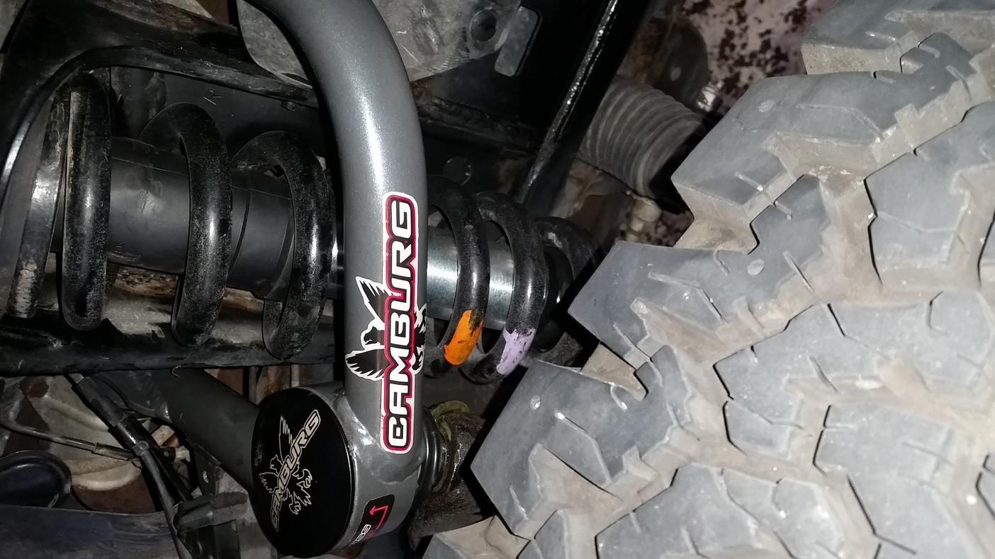

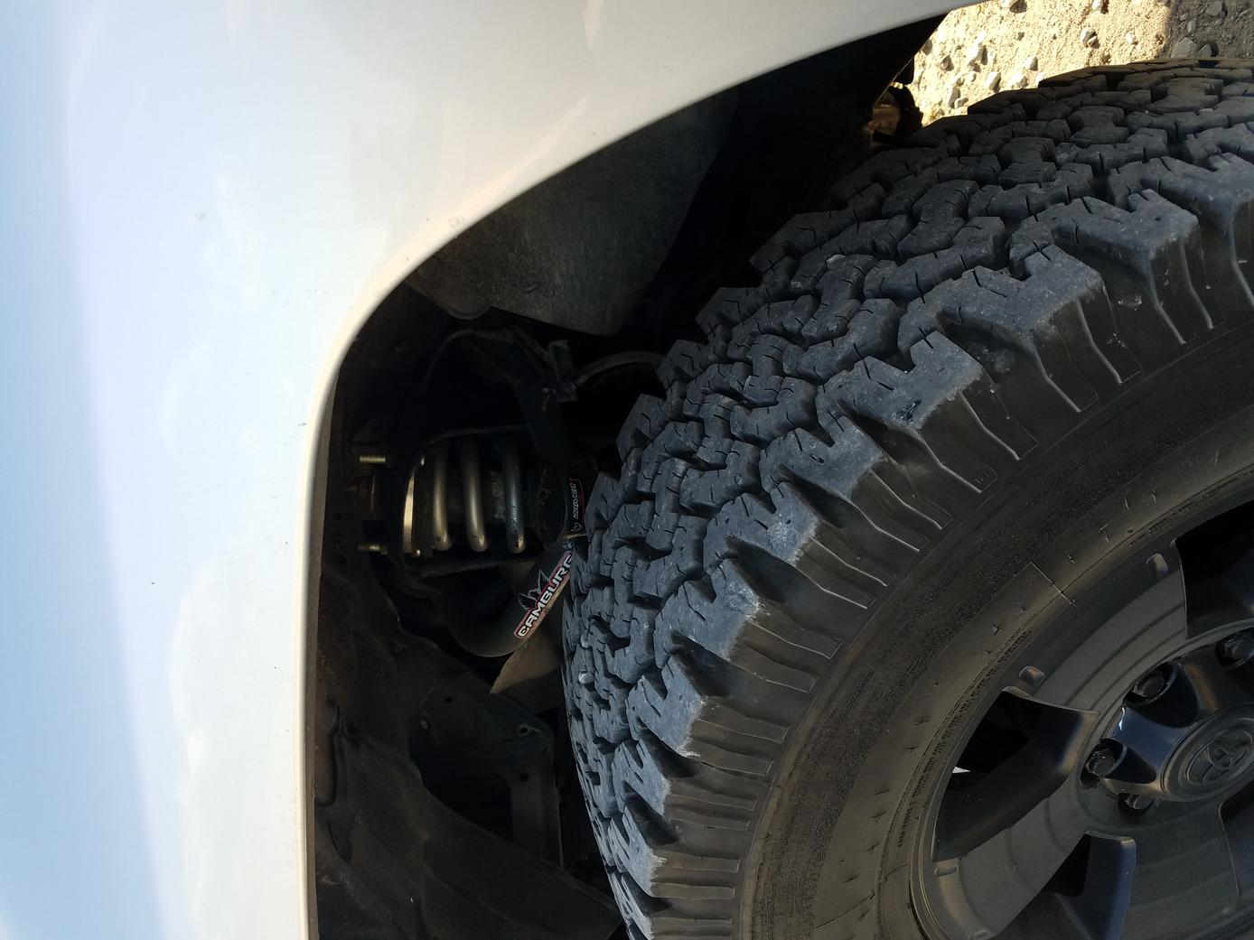

I installed the FJ springs, Bilstein 5100s and the Camburg UCAs.

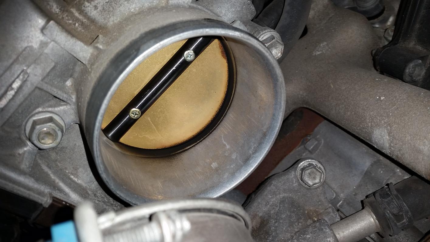

I also cleaned the throttle body....man was that thing dirty.

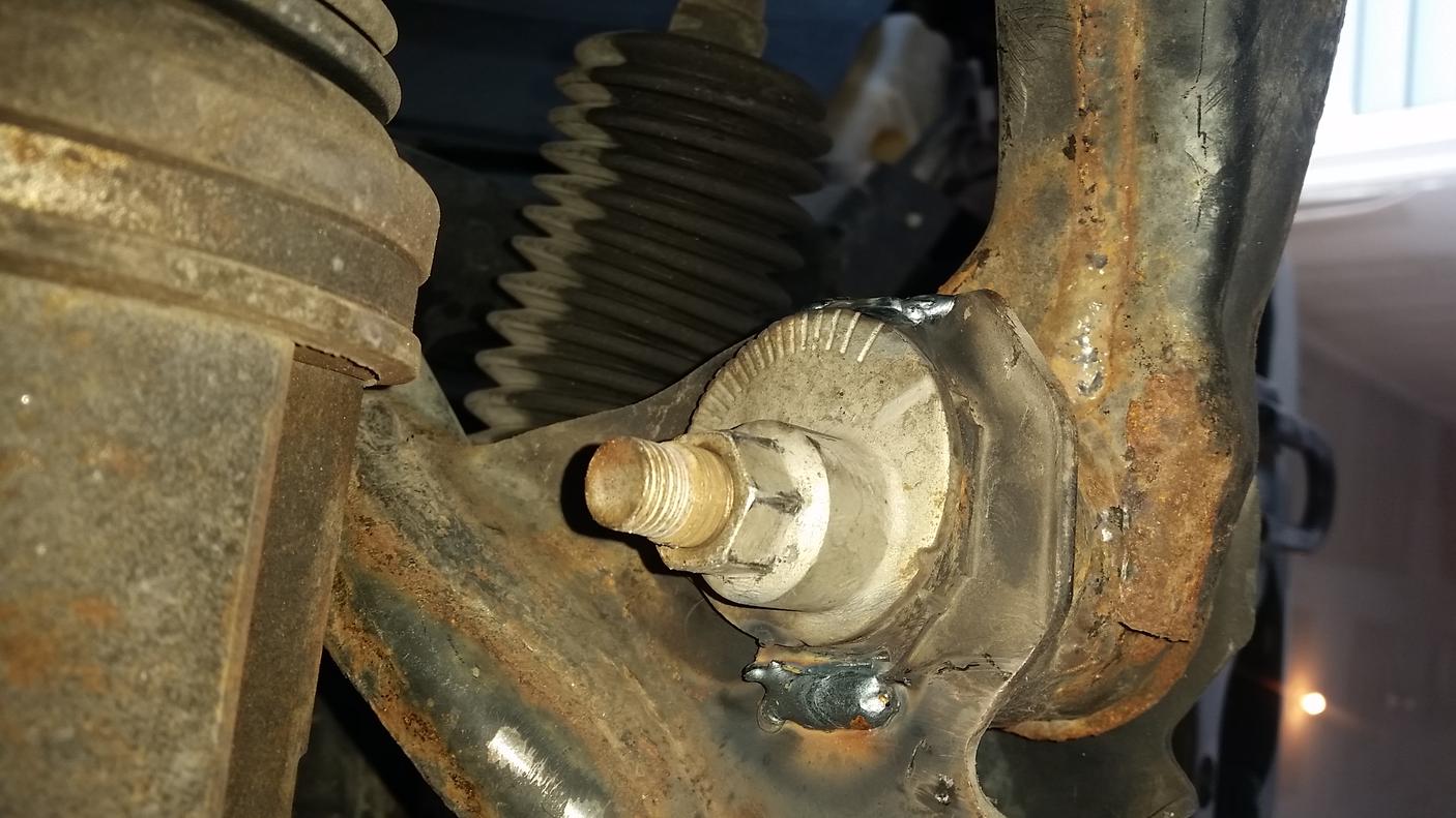

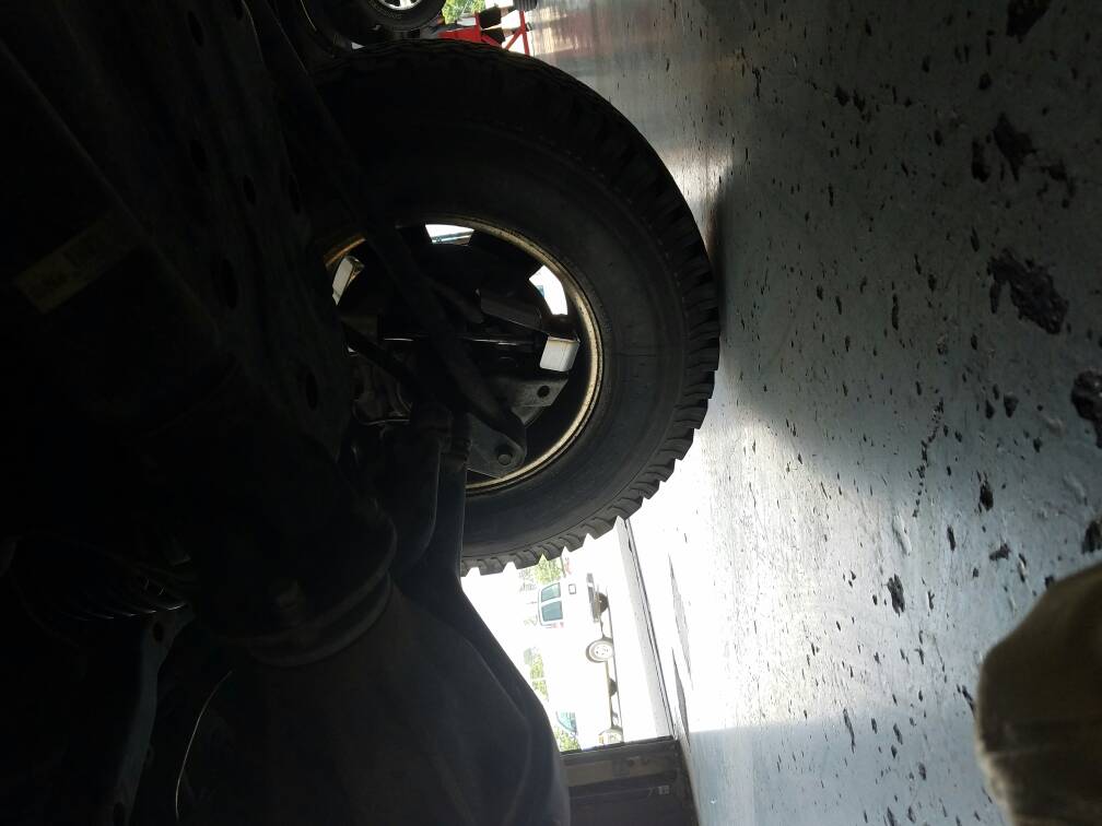

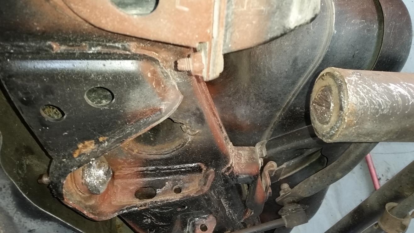

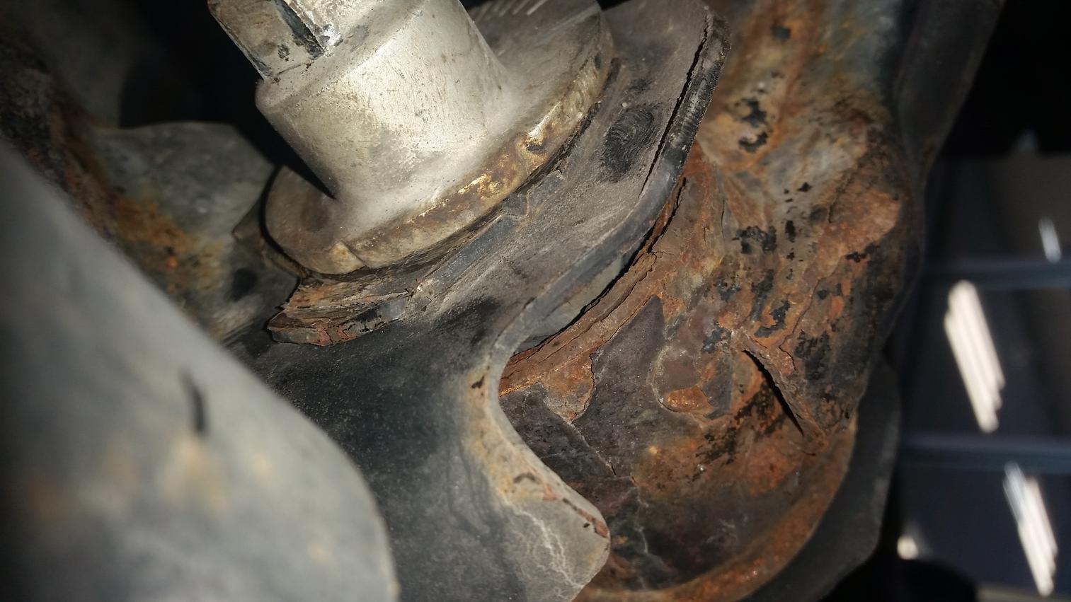

....and of course nothing is easy.....went to get the alignment and the tabs were bent flat. They were bent back and a bead dropped behind it. I also got under the truck and with the angle grinder hit all the rust I could and put some preventative on.

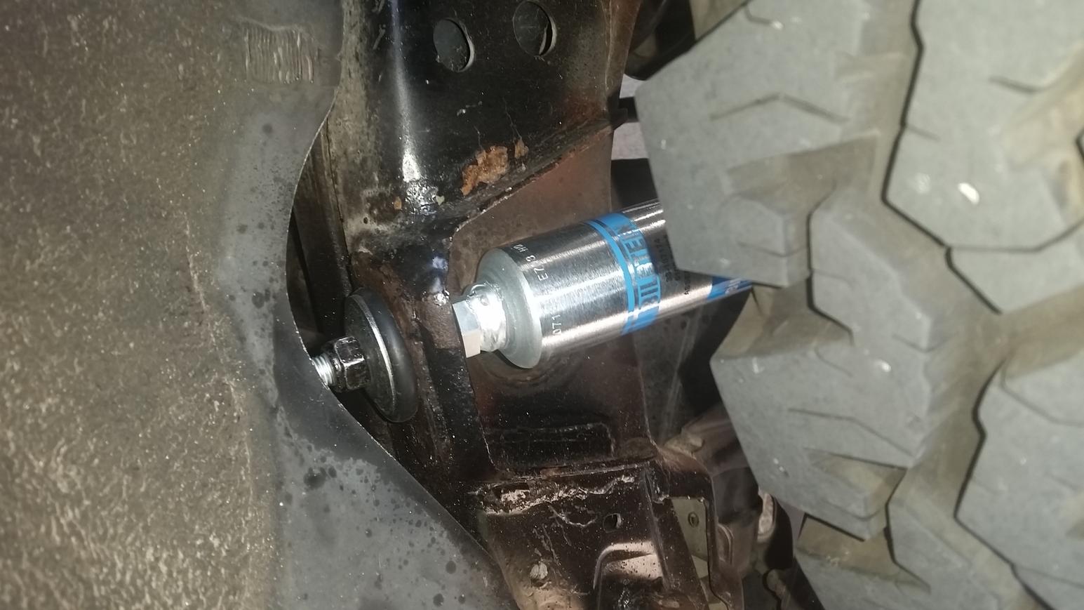

Installed the rear bilstiens today....what a pita when things get stuck.
I also think these might have been the original shocks haha

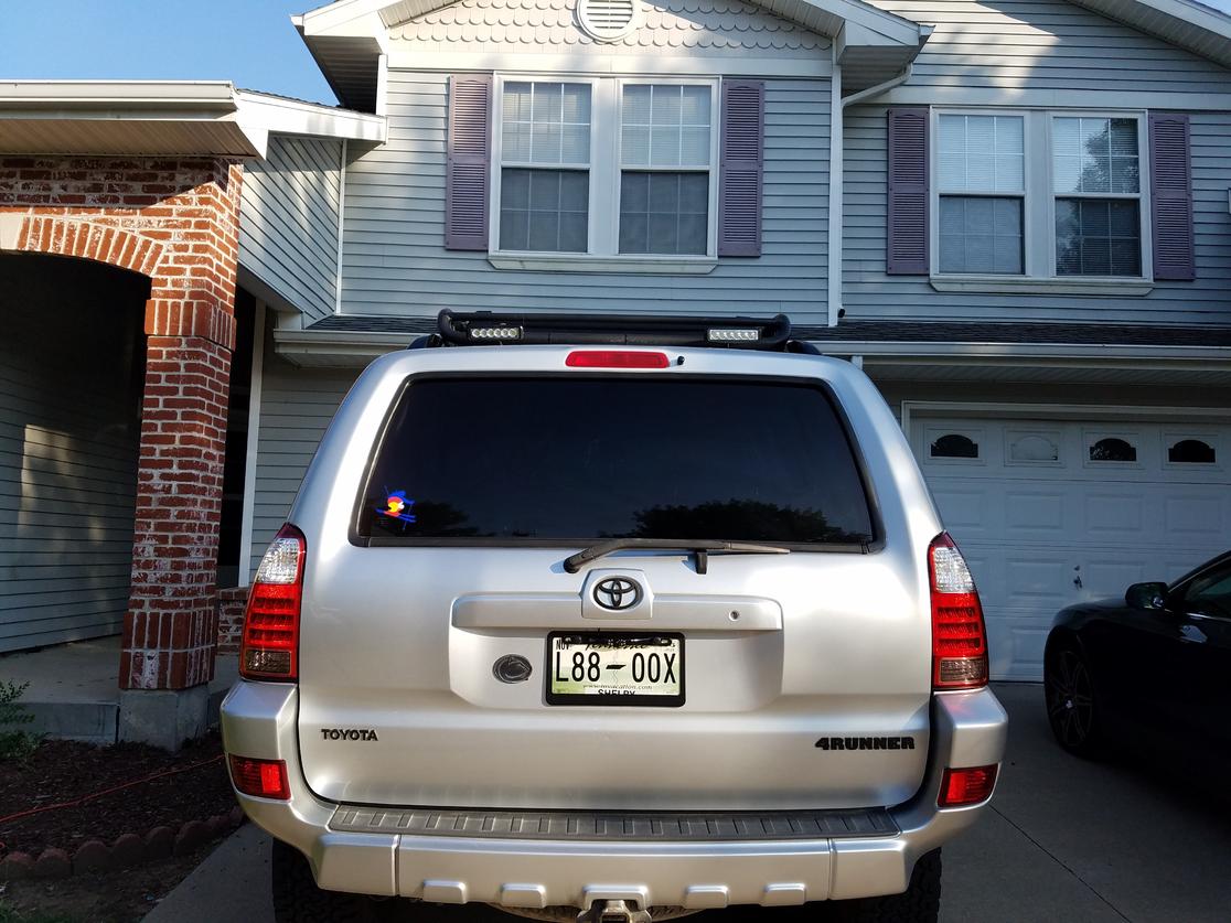

- Installed a Black Oak 42'' curved combo light bar with custom mount.
- Installed reverse lights on the roof rack.

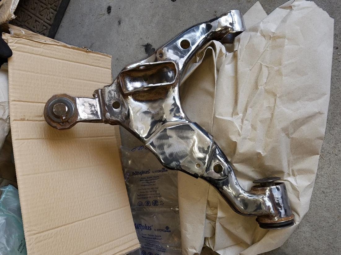

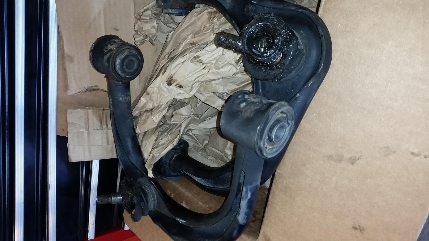

- Received used control arms I will prep with paint and new bushings and swap out old ones with (thanks [MENTION=117708]blackoutt[/MENTION] !)

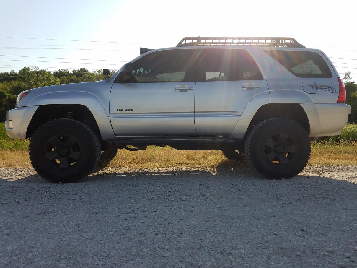

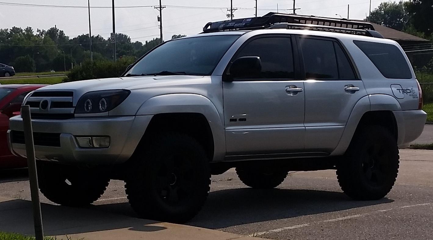

Installed the new lift and took some pictures.
Also found a deer!

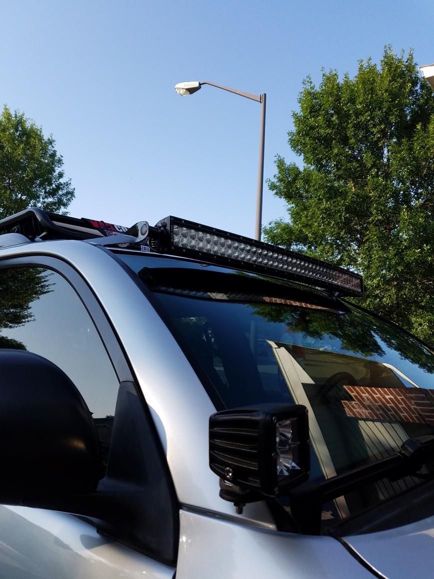

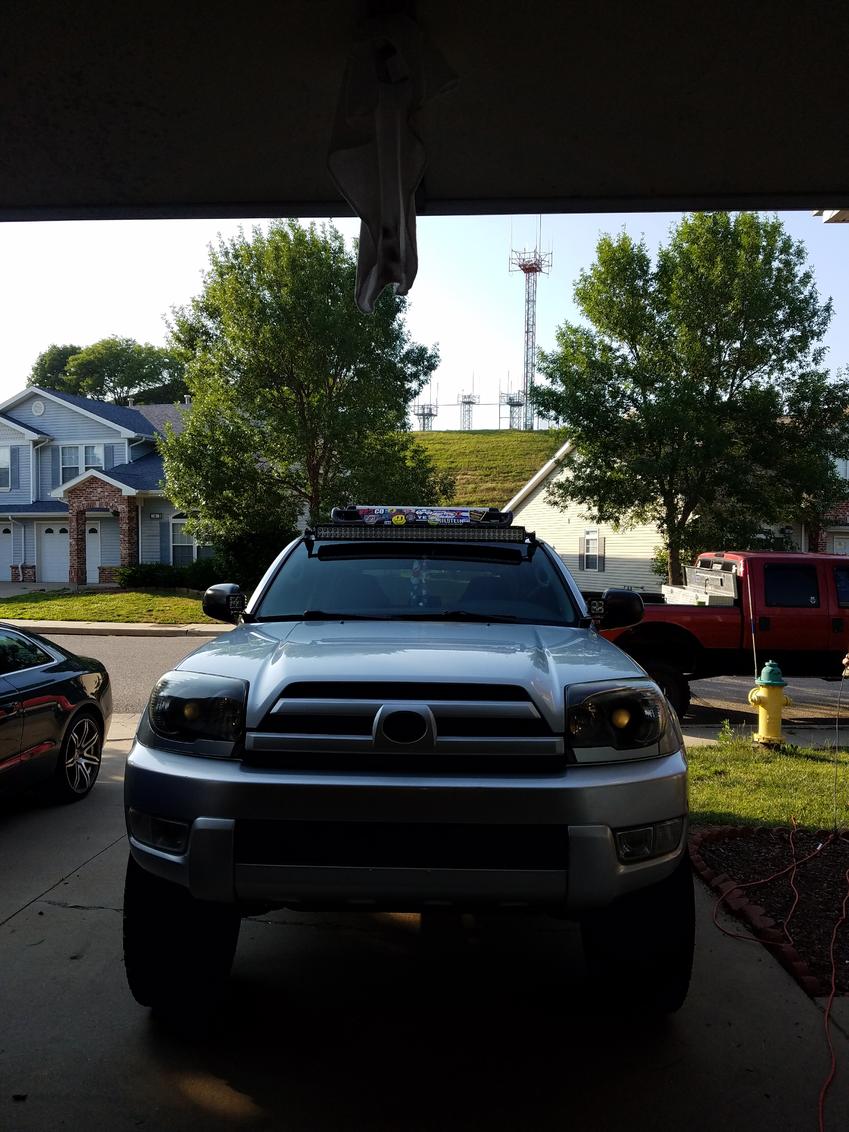

Pics of the light bar.....headlights in the first photo and light bar in second.
