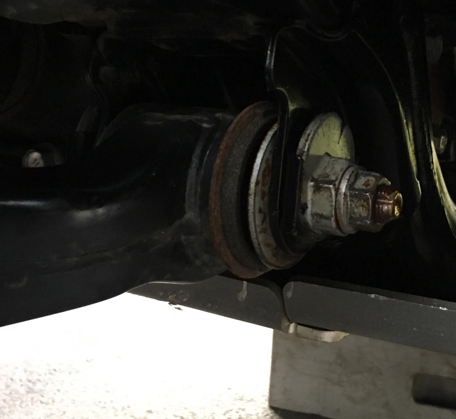

Need some help. Did a lift install last week on my 19 Pro. I had problems with the driver side rear cam bolt. I loosened it using an impact on the rear nut. It loosened and the cam plate backed off. I put back together so the cam plate is in the same position as the plate on the other side of the bolt. I then used a wrench to tighten the bolt back down. I cannot get the nut to tighten all the way. It seems stuck. I tried turning the bolt side and the nut side but it won’t tighten all the way. It’s popping while driving. I’m concerned that the nut and bolt will need to be replaced. Looking for ideas to get it tightened. I’m having an alignment but I want to resolve the stuck bolt before thy appointment. Dumb question but should I tighten and loosen from the nut or bolt side?
Since my inspection is due, I’m Wondering if I should get it inspected at dealer and ask them to fix the bolt. Maybe they’ll warranty it?

Doesn't the cam plate in the picture spline to the bolt? Pull nut back off make sure the cam plate splined onto bolt and retighten. Might even pull bolt side out a bit and push back in make sure everything is seated properly then tighten nut.
For whatever reason I can no longer get the bolt or nut to loosen up. It’s stuck. Debating cutting the nut with a cut off wheel and splitting it with a chisel. Pissed my entire lift install is f-d up by this one bolt. I’m now realizing that I may not have the cam plate seated right and maybe it got screwed up by trying an impact to tighten it since I couldn’t get it tight by hand.
Any tips?
