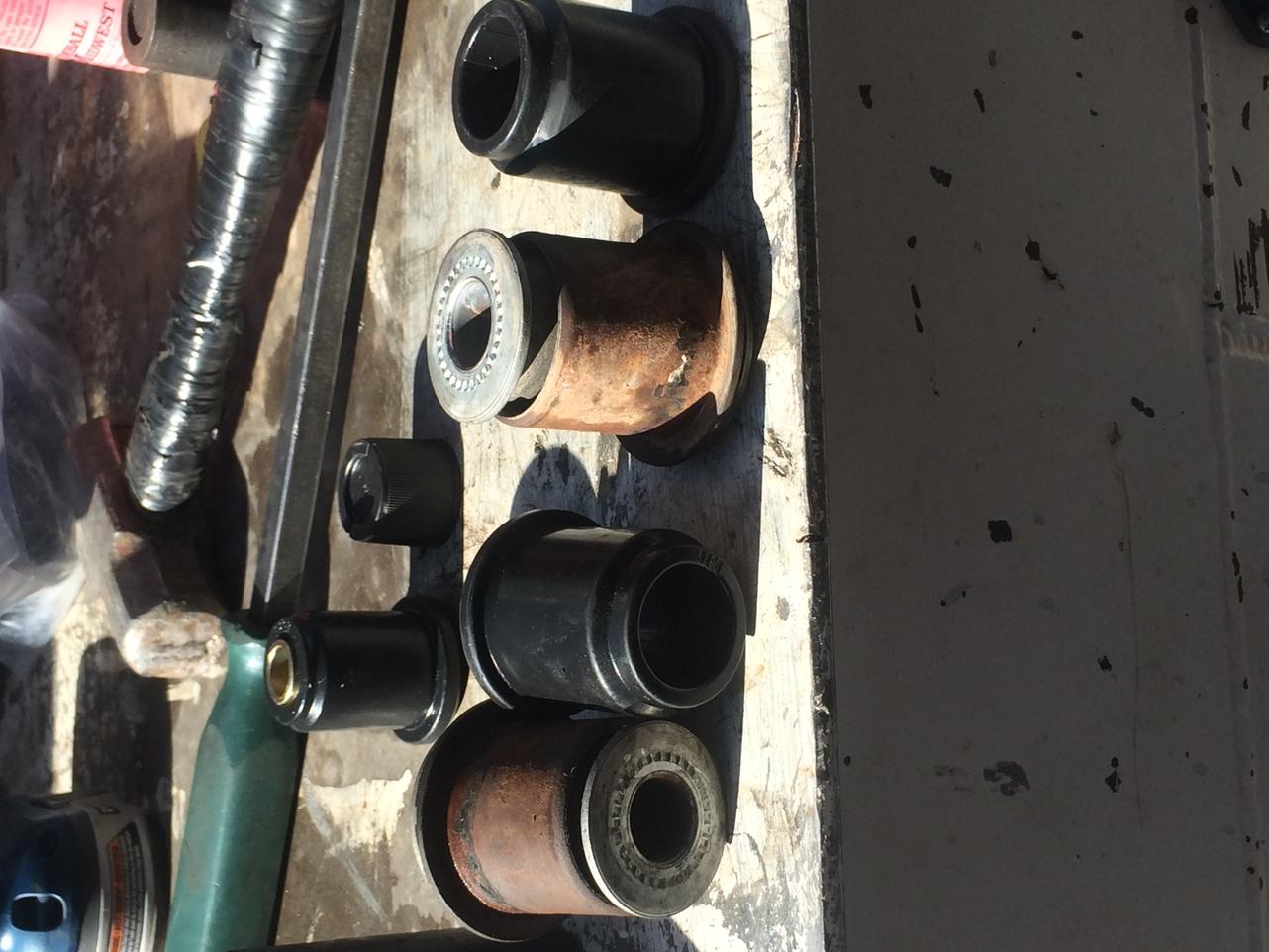

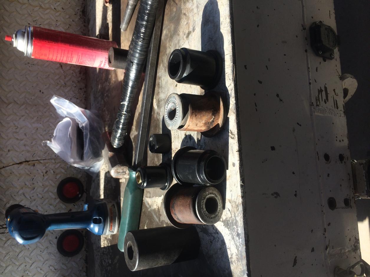

okay so im went to replace my LCA bushings and im kind of at a loss. I searched for a thread on how to disassemble the actual bushing from the sleeve. I got them out of the LCA no problem but im not sure where to go from here? Anyone have a write up on how to chane the oe parts to the new poly bushings?

put main part of it in a vise then use 2 pry bars or big screw drivers on it and use the main metal part edge under neath to pry up on it it will come off real easy me and my dad just did on mine but i dint take any pictures or make a write up. putting the washer back was a little bit harder due to having to use a hammer to get them back on. but take off is very easy.
Thanks that's what I was looking for...but I destroyed the washer getting it off :/ these are going back to summit and I ordered whitelines so I don't have to reuse the old parts. Thank you for the help tho. :)
