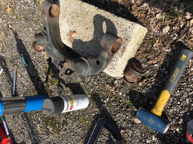

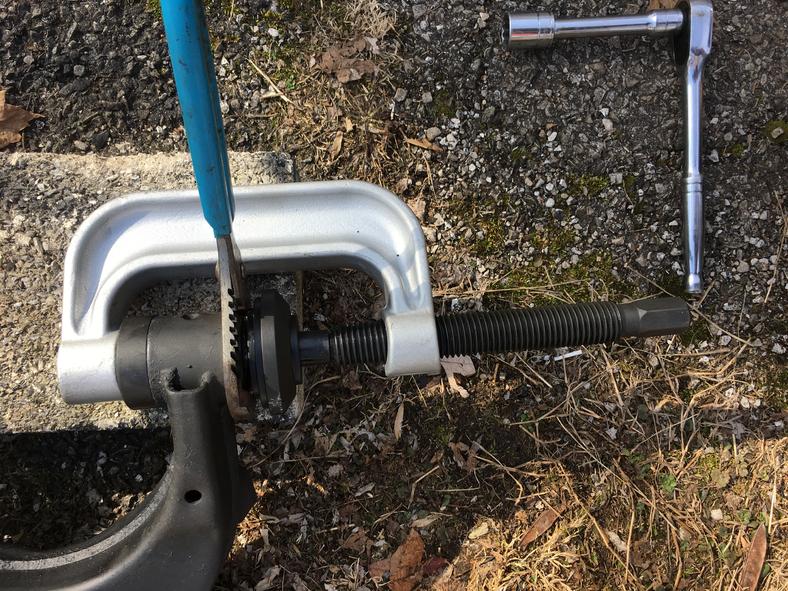

I bent both of my LCAs pressing out the bushings using the factory bottle jack, a lot of heat, and what I thought was a small amount of pressure. Given the headache this caused, if you don’t have a shop press, just buy new LCAs from Toyota. I spent more time ****ing with pressing bushings in and out and then wrestling with getting the LCAs in than I did taking the truck apart and putting it back together.

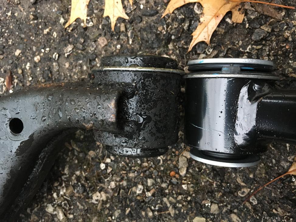

One side was still usable but I had to buy a new drivers side LCA.
You can see there’s not a huge difference but it was enough that the old LCA wasn’t going in the brackets with the washers. Thr old bushings were pretty well rusted in place, so if your truck has lived its life in Southern California you might not have any trouble with this but even if not, it saves so much time to just replace them with new parts. Seriously.
I should add that this isn’t a jab at Tim or Sean, since it’s hard to judge how much force you’re applying with a bottle jack with a video. Their videos have helped so much with this repair and others so I don’t want to come off as saying they’re wrong. Just that if you need to drive your 4Runner to work the next day, the peace of mind of having new parts is worth the extra cash.
