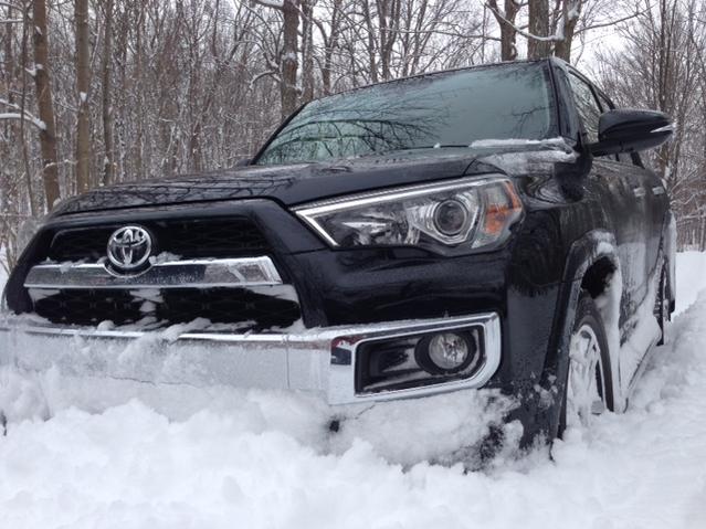

4H locked and unbridled, deep snow can't hold back an LE....though engaging first and second gear helps.
