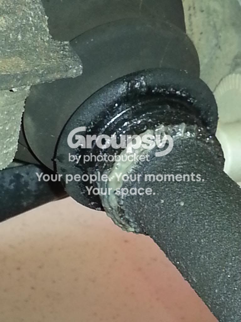

Noticed this while doing my oil change and tire rotation today. The boot itself looks intact, but this seems like a lot of "crud" around the seal.
Is this a problem?
Yes its a problem.
Fix is here.
Replacing CV bands - Toyota 120 Platforms Forum
I used 4 marine clamps like in the article and they have been running strong for 2+ years.
^^^What he said. I did the same thing with the same marine clamps and still good to go after about a year and a half.
The grease that's coming out of your boot looks pretty clean - like you're catching it early. If i were you, I'd just take off all 4 crappy clamps and throw some of those marine clamps on there and call it a day. I personally had to repack one of them with new grease (hardest part here was getting all the old stuff out!)
Goodluck.
My passenger front CV boot is busted...and the grease is really starting to cake up around that area. I'm gonna have to try those clamps
Well, guess my next project is decided. :P

I have the same question, it looks like both of my clamps are loose (I can slide them back and forth easily), and one of them is cut (it looks like one of the metal clamps sliced through it).
How can you tell whether you can get away with just replacing the boot, regreasing, or replacing the entire CV joint?

Will any marine clamp work or are there any auto shops that will have the right clamps? Trying to get this done today before I go on a 500 mile trip

so upon further inspection is seems the boot did in fact rip right where the front cv band goes. Time for new boots on both sides. What do you guys recommend for replacement boots. And is there anybody in SoCal that knows how to install these and would help me out for some beers or $$
Razz, Is your truck lifted? How much does lift affect CV boots? Are OEM boots still good for a 5100/Eibach amount of lift? Asking for a friend.
Toyota sells an OEM reboot kit for under $60. Boots, clamps, grease, etc. You could keep your OEM axles and try rebooting them yourself. The damage here seems minimal so you can probably bet that the internals are good, it really just needs new boots and all new grease.
Don't go to a local shop and let them replace with any old BS they have on hand or can get from Napa. Try to stick with at least OEM or something that has a good reputation (like CVJ above.)
