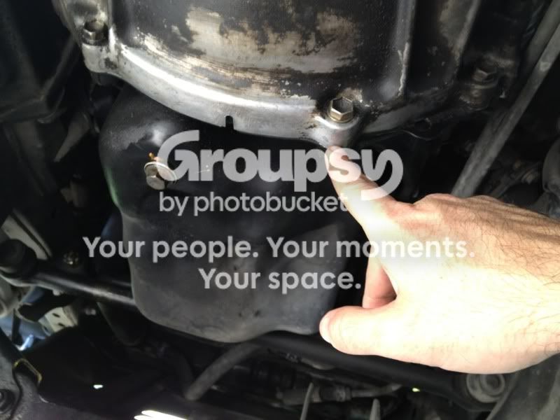

Heres a pic its accumaliting under the bolt

I had something similar happen, and about the same location of the drip. Turned out to be one of the transmission cooling lines had rusted through. Simple/inexpensive fix, and it was no longer leaking.
Check your lines - that's probably what it is.

I checked the lines they looked good, if the truck is just sitting there it doesnt leak, but it does after driving for a bit then coming home... if that makes any sense?
My guess would be transmission input seal or pump housing gasket. Possibly a bad torque converter, but highly unlikely. When it comes to leaking in that area and it isnt the lines more than likely the transmission has to come out for repair.

is the fluid its leaking red? if so then its the tranny if not its your rear main seal.
you can do the input shaft seal yourself its not hard same thing with the rear main you will just need time
Get some Trans fluid Dye from the auto parts store put in your trans drive around for a couple of days buy a black light and that will help you locate the leak, also check behind the straps that hold the trans lines to the bell housing I have seen the lines rot out from this area and if you can't find a black light find a Tech that has one put your vehicle on a hoist shine the light on the leakIng trans fluid and you should be able to find the leak this is what I would do first.

i dont normally do any crazy offroading, just a bit here and there when im going to a fishing hole or something. but today i went out with the intent of just doing some offroading...when i got back i saw oil leaking from the same spot. now when i checked it out with a flashlight it looked like the leak might be coming from the oil pan gasket...would that be normal for something like that to happen after roughing your truck around a bit on the trails?
not the oil pan gasket but the rear main on older vehicles is very suseptable to sudden desires for offroading.
it will also be at higher risk of leaking with old mounts like you engine mounts and tranny mounts if those are old the driveline will flex causing stress on your flexplate and inturn your crankshaft this will push on the rear main seal and when that happens the leaks begine
