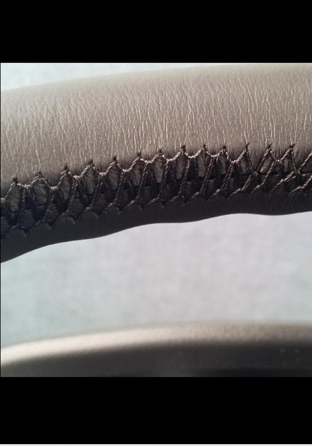

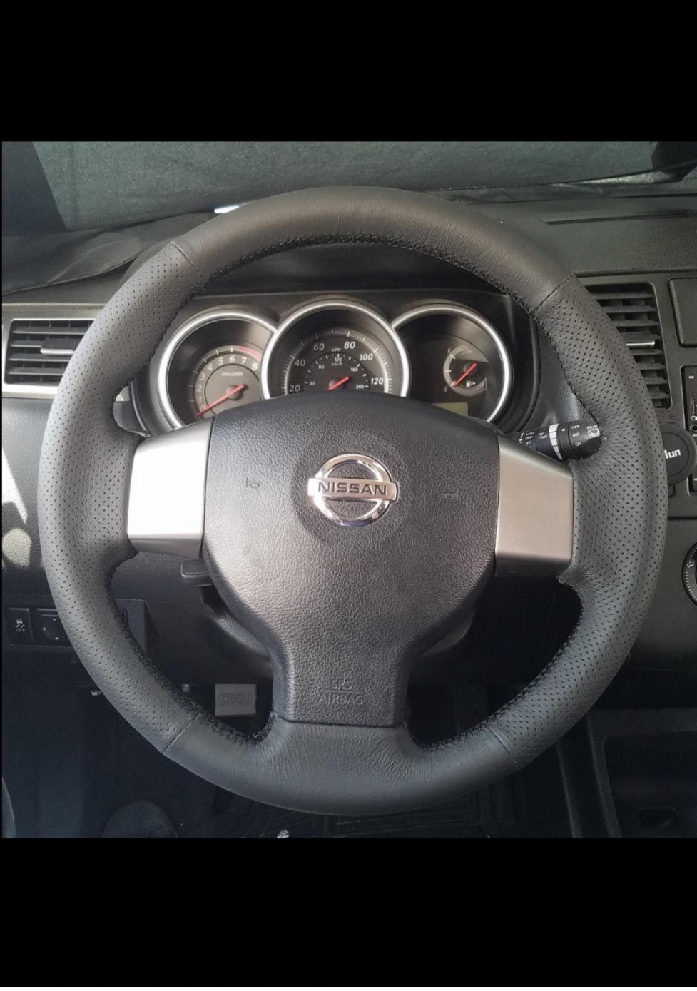

I saw a few done by Dallas, they came out very nice.
I did one of those sew on covers on my daily driver Versa and it came out pretty good. The leather feels so much better than the factory wheel rubber like material and it gives a good grip while driving.
I watched alot of install videos to see how it's done and took my time stitching it on. This was definitely a project, so set some time aside to do it. I'd say a few hours at least.
TIPS:
Before you start, set the cover in the sun or on the dash of the car for some time to heat it up so it has some stretch to it. Cold will not be your friend here.
Definitely use the double sided tape on the front and back of the spokes to hold the leather in place.
Do the longer sections across first when sewing.
Get a set of mechanics picks. They will help with pulling the thread tight for a good seam.
Don't pull too hard or you could break the thread.
Stitch a few inches and then go back and pull the seam tighter with the picks.
Remove the steering wheel. I started the job with the steering wheel in the car but not soon after, I removed the wheel and did it in the house at the dinning room table.

Looks professional. Well done! I ordered a mewant steering wheel cover off eBay for about $30 shipped. Will let you guys know how it turns out.
