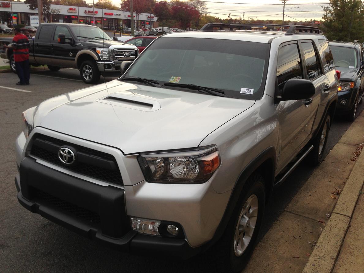

The Day I picked her up in VA

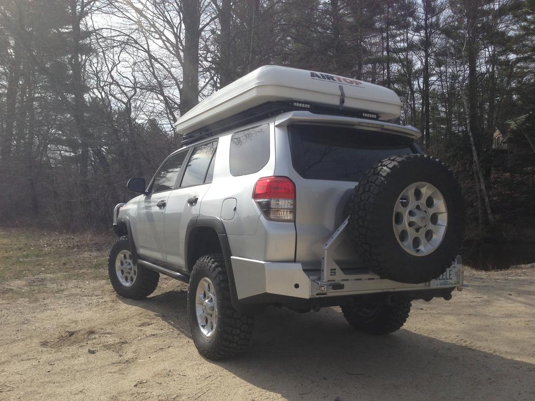

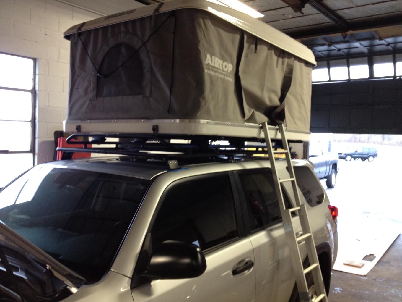

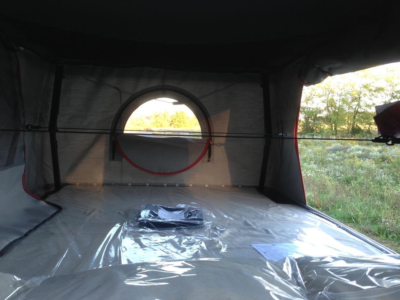

First Item was the Autohome Air Top tent (Med) with Gobi Rack

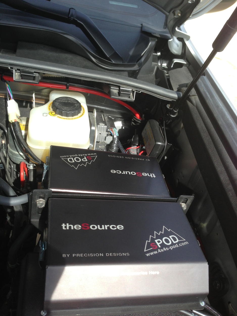

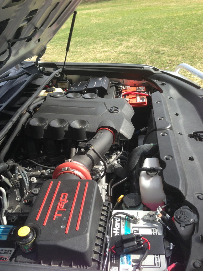

Next was all the wiring for all the goodies :) Went with two sPods for all the switches I have to run and a National Luna Dual Battery Kit. Had some Custom brackets made up and powder coated for the Aux battery sPods solenoid and ARB Compressor.

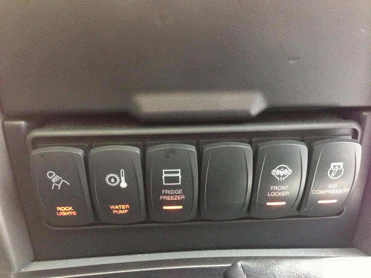

Here are the great OTRATTW switches. I'm still waiting to do a shower mod so that switch is for show right meow. ( "super troopers" )

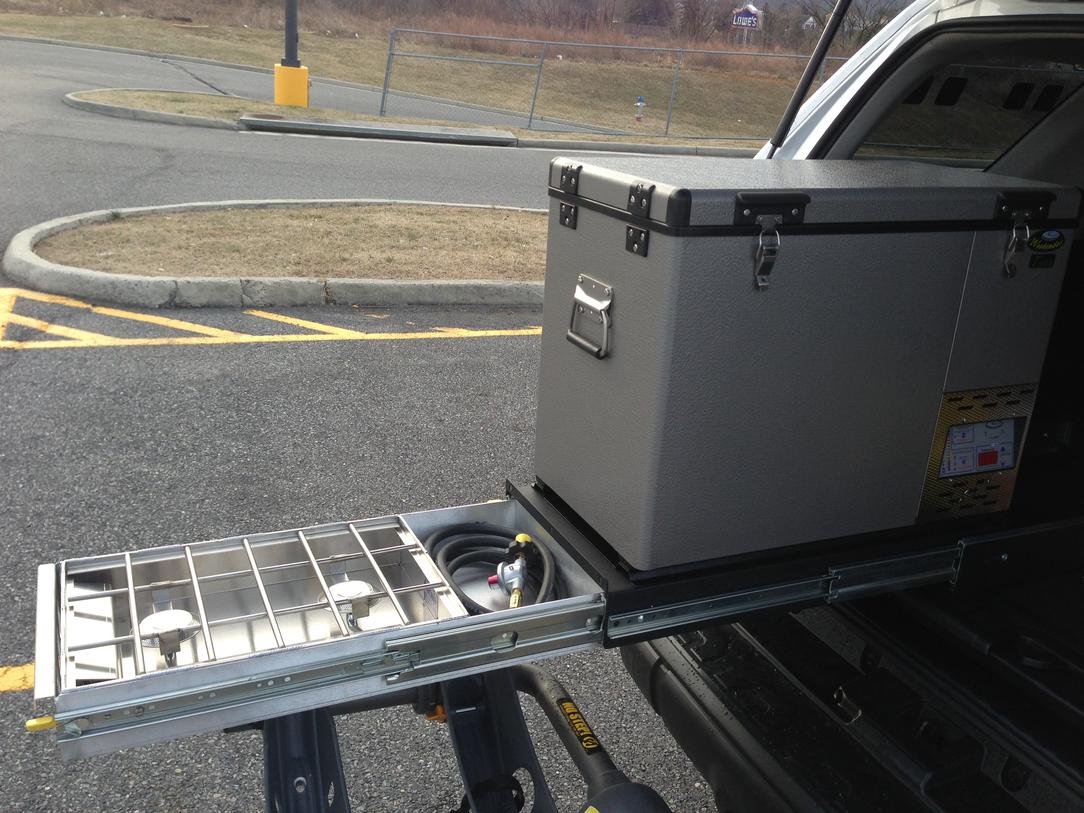

For comfort installed is a National Luna weekender fridge freezer on an AT combo slide with two burner stove.

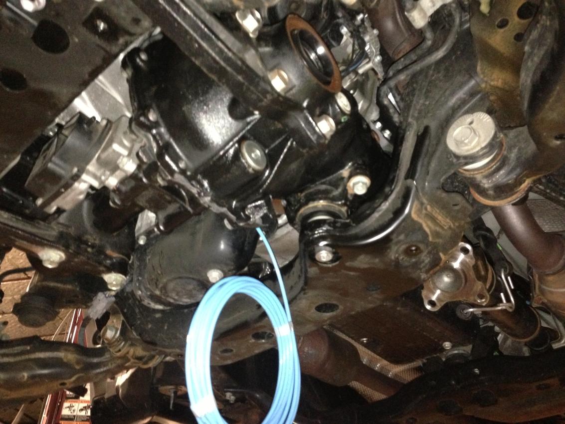

So once the fridge and combo slider went in it was time for phase 2
Since the compressor was already installed and the lift was in the works. The ARB front locker was installed.

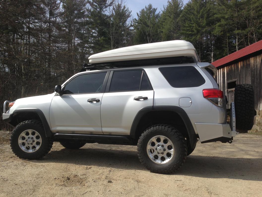

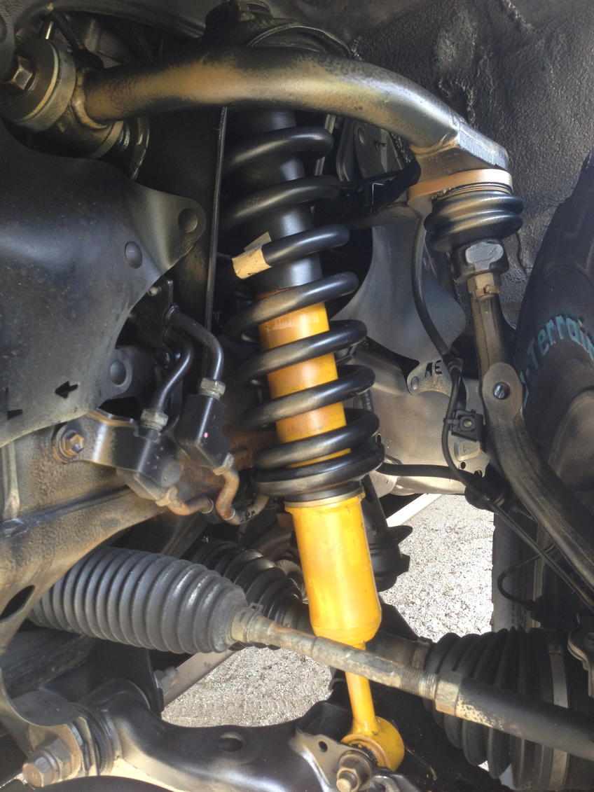

I went with a 3" OME lift with Heavy springs front and rear and BF Goodrich KM2's in size 285/70/17. The film on the metal is anti corrosion spray I use due to salt in NH.

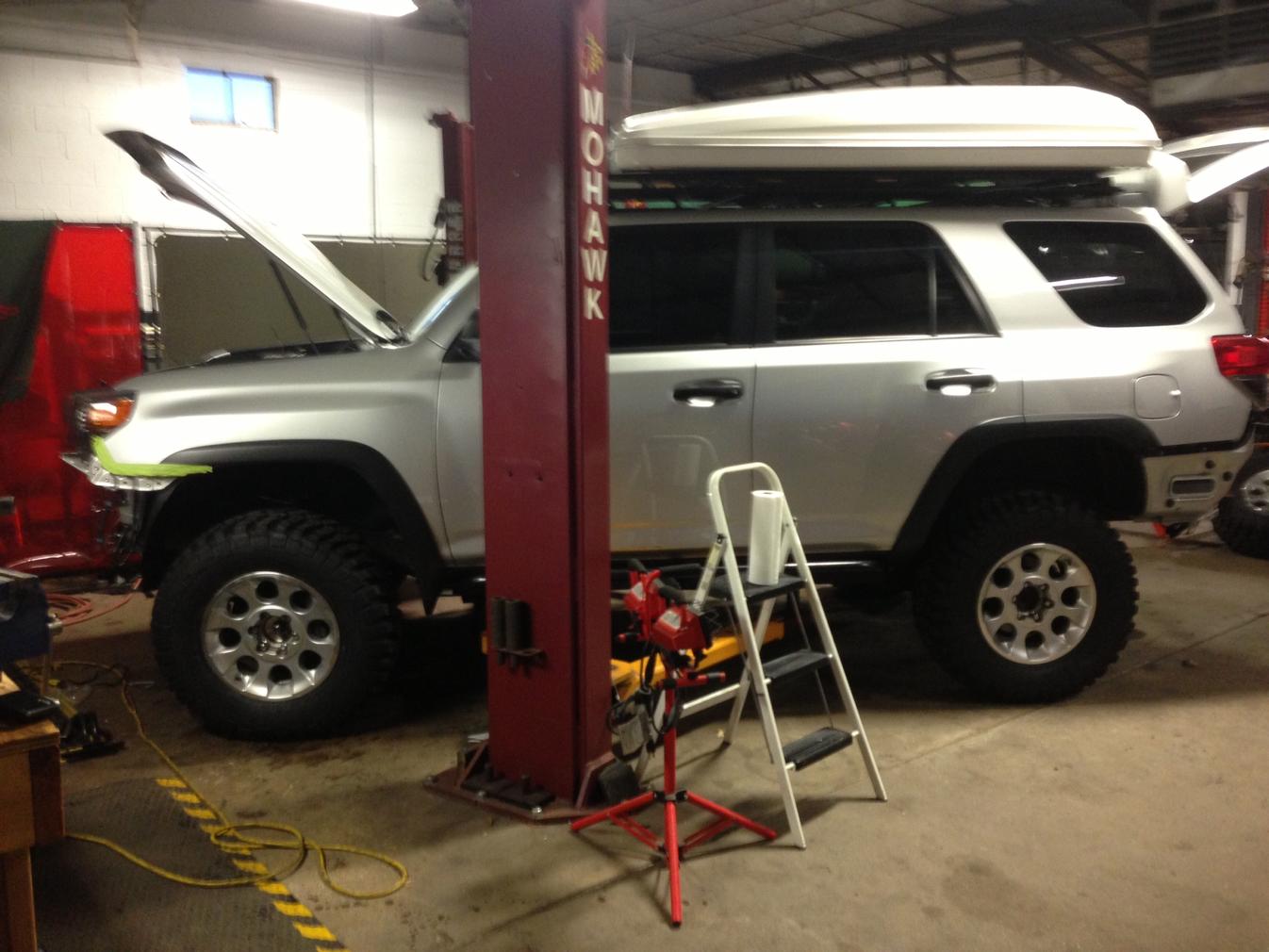

After the lift.

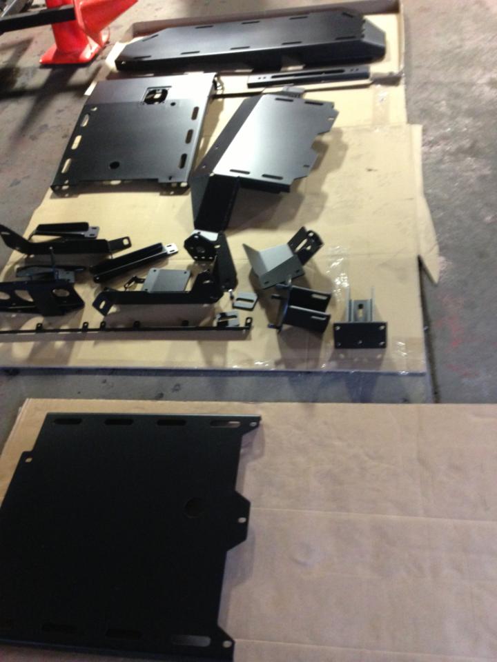

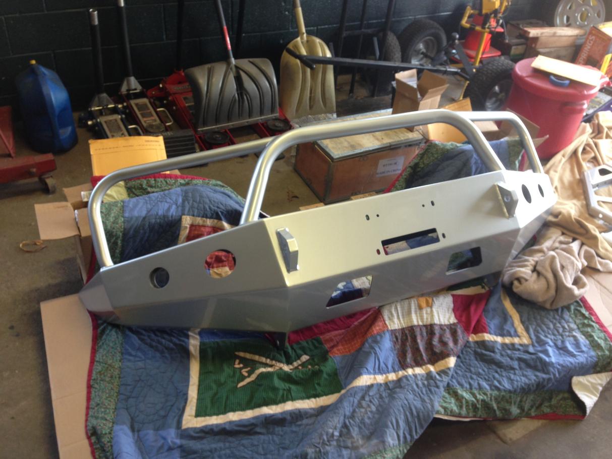

After the Lift, Locker and tires it was time to add some weight. Sliders and mounting hardware back from powder coat for front and rear bumpers
Front color matched waiting line-x

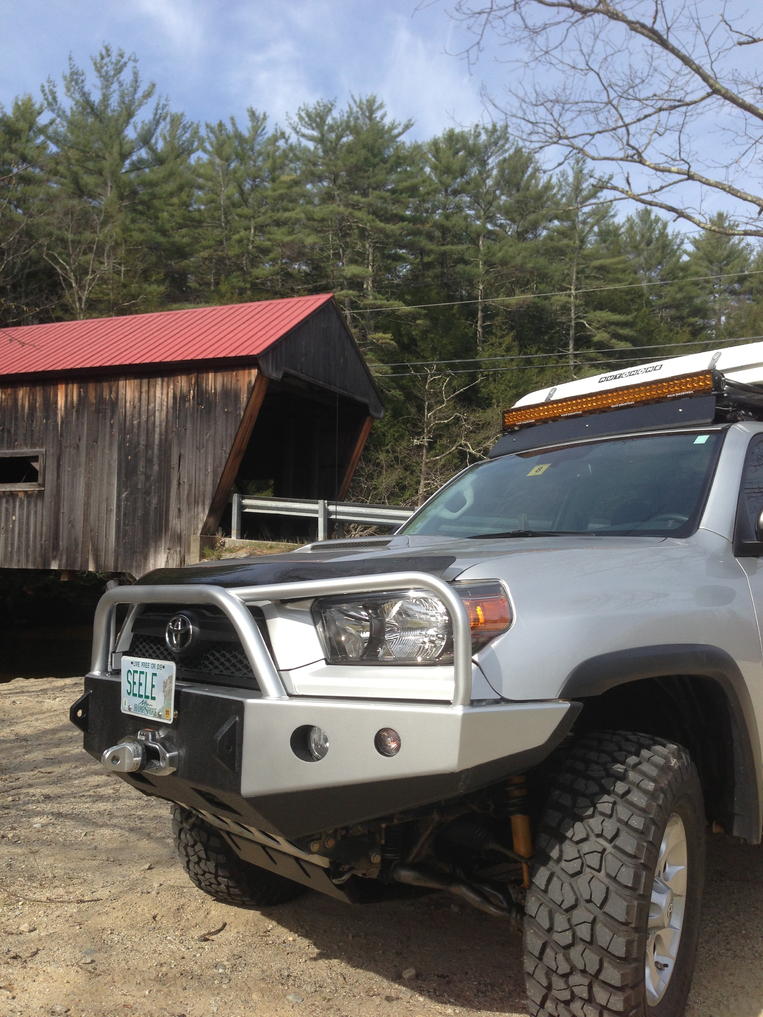

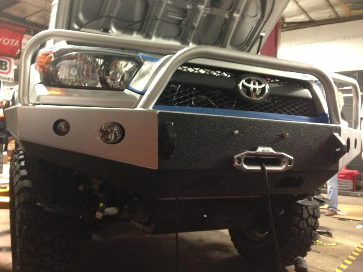

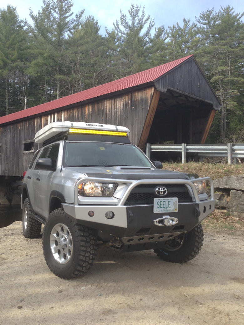

After paint and line-x Warn 9.5 XP-S with Factor 55 was mounted along with the front and rear bumpers.

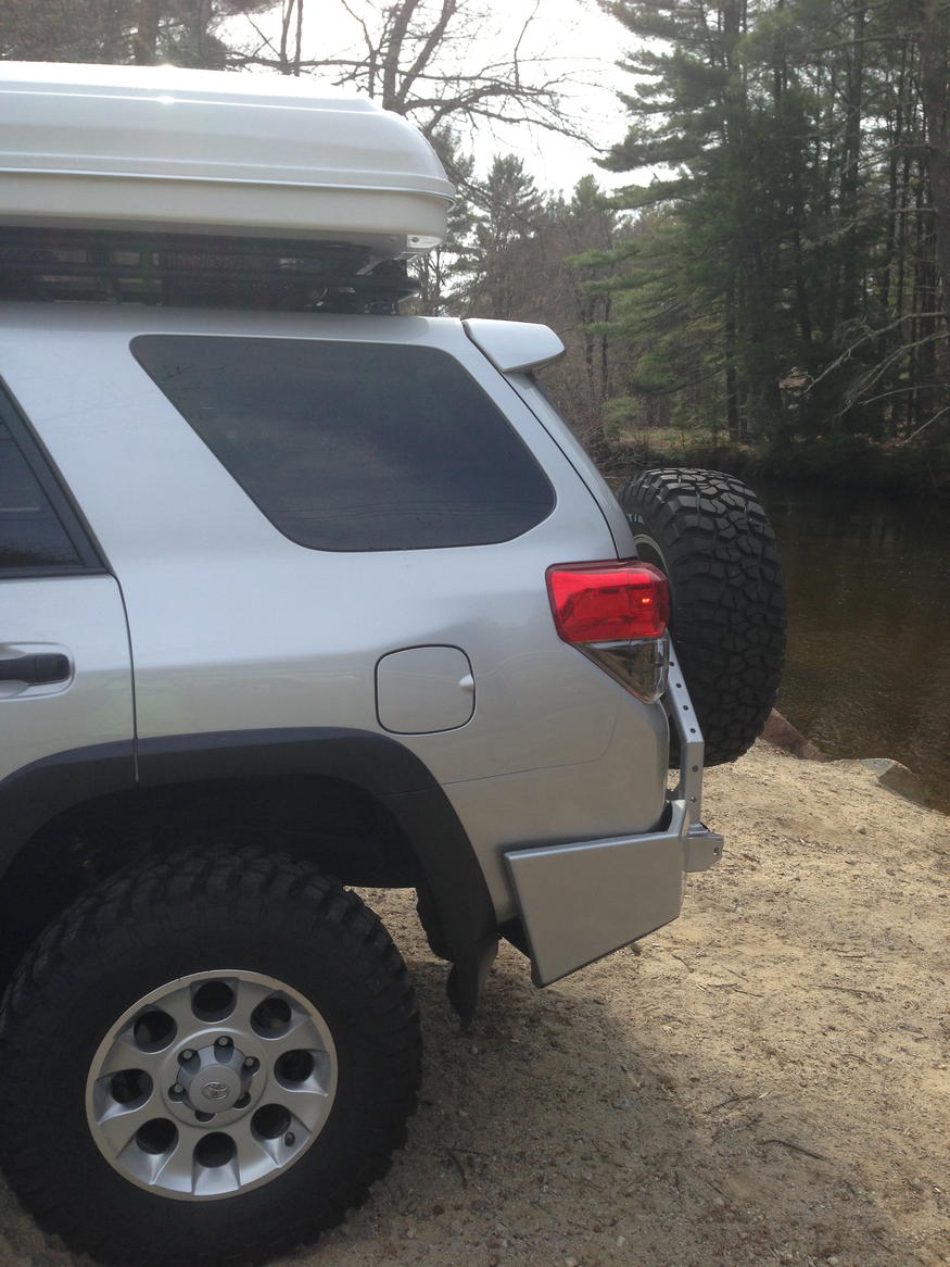

I had some requests for angle shots so here you go :)
The Boys in West Chester PA brought this project together since I was working away from home and living in a hotel. Thanks Pete and Matt!
Any info or write-up on the OTRATTW switch install. That's where I am planning on putting my switch bank in was wondering if you ran into any issues in that spot? Do you happen to have other pics from the install.
All very clean. Awesome job!
Wiring is not my specialty so I had the guys at Main Line Overland help me out. The recess in the console had to have a little dremel work to fit the switches.

Question, who makes that grill slideout for the fridge? I've been looking at the tembotusk loadspotter, but I like yours too.
YES! Love what you have done Alan!
Thanks Andrew, I bought the combo slide from Adventure Trailers in AZ. I also like the snow peak stove and grill. One thing to consider is boiling water on the combo stove. The steam goes up into the lift gate if you are using an open pot. I just make sure I keep water covered when bringing to a boil.
