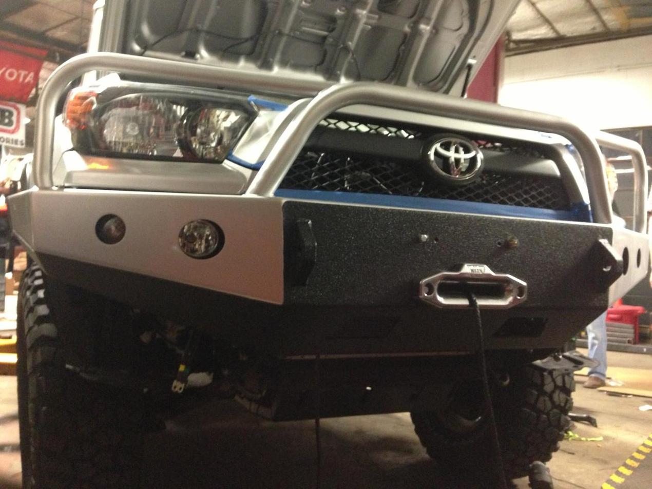

Don't know how I have not commented on this build but very nice. The color matched bumpers look very nice. Not a huge fan of the Shrockworks rear bumper but still looks good. Keep the build going.

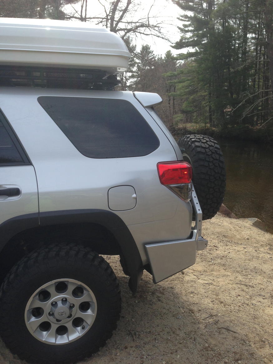

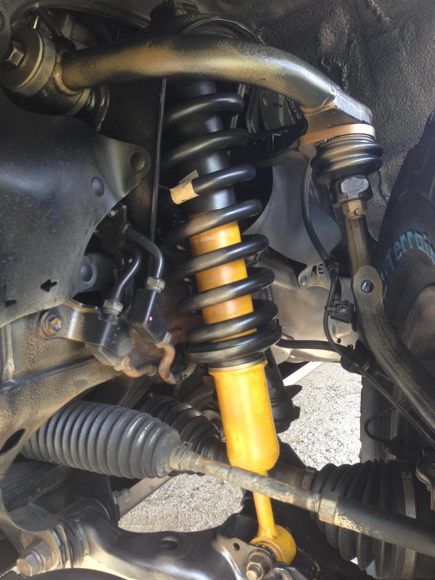

I went with a 3" OME lift with Heavy springs front and rear and BF Goodrich KM2's in size 285/70/17. The film on the metal is anti corrosion spray I use due to salt in NH.
After the lift.
Nice Build! Can you please tell me the name of the spray you used for anticorrosion protection. Thanks

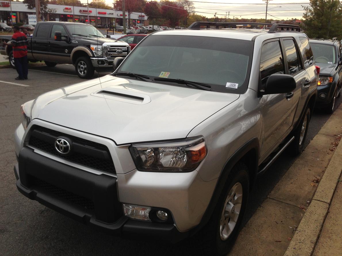

Thanks to everyone who inspired and shared their knowledge to help me with my build :)
The Day I picked her up in VA

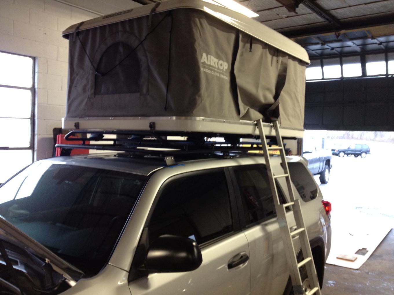

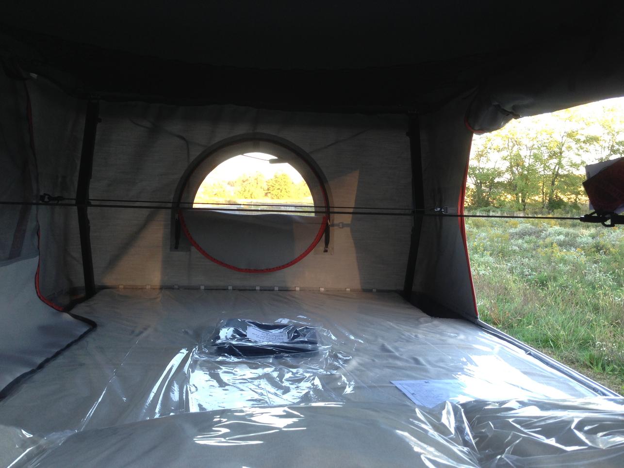

First Item was the Autohome Air Top tent (Med) with Gobi Rack

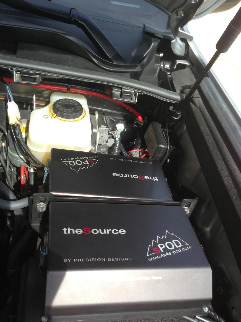

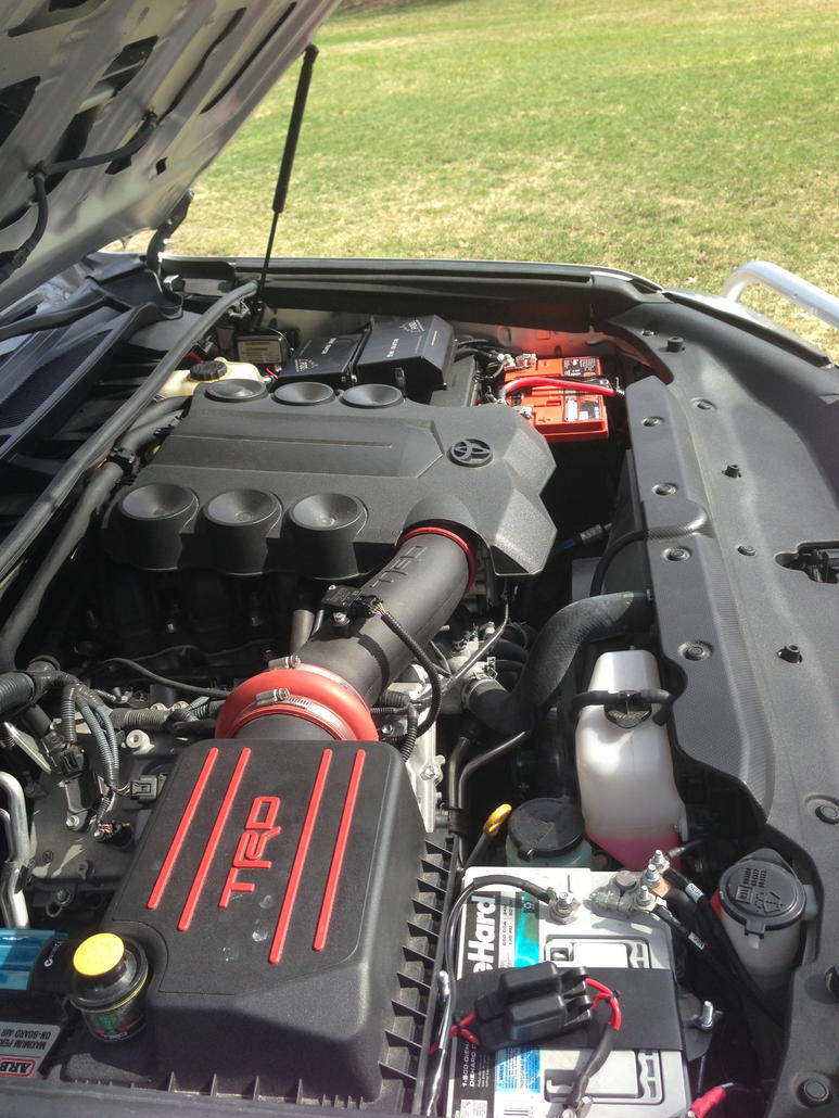

Next was all the wiring for all the goodies :) Went with two sPods for all the switches I have to run and a National Luna Dual Battery Kit. Had some Custom brackets made up and powder coated for the Aux battery sPods solenoid and ARB Compressor.

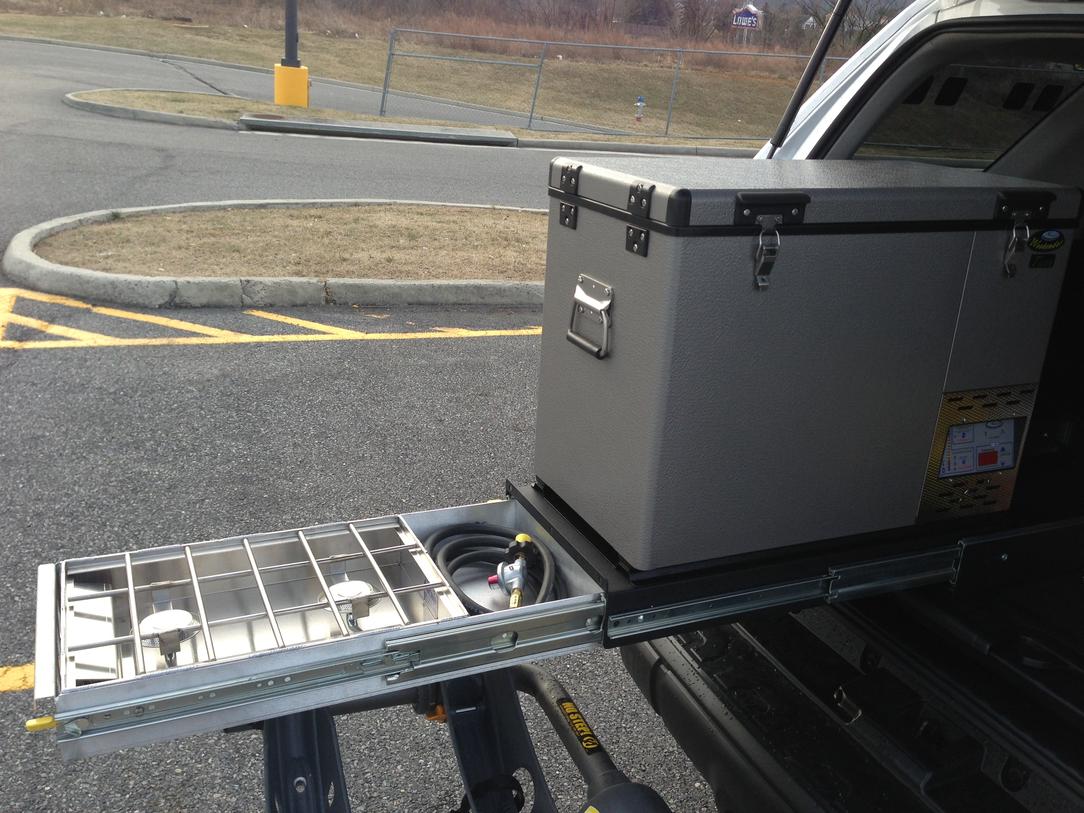

For comfort installed is a National Luna weekender fridge freezer on an AT combo slide with two burner stove.

What size Luna did you get? I am looking at the Socal Trailers slide.
Also what Ah is your second battery?
