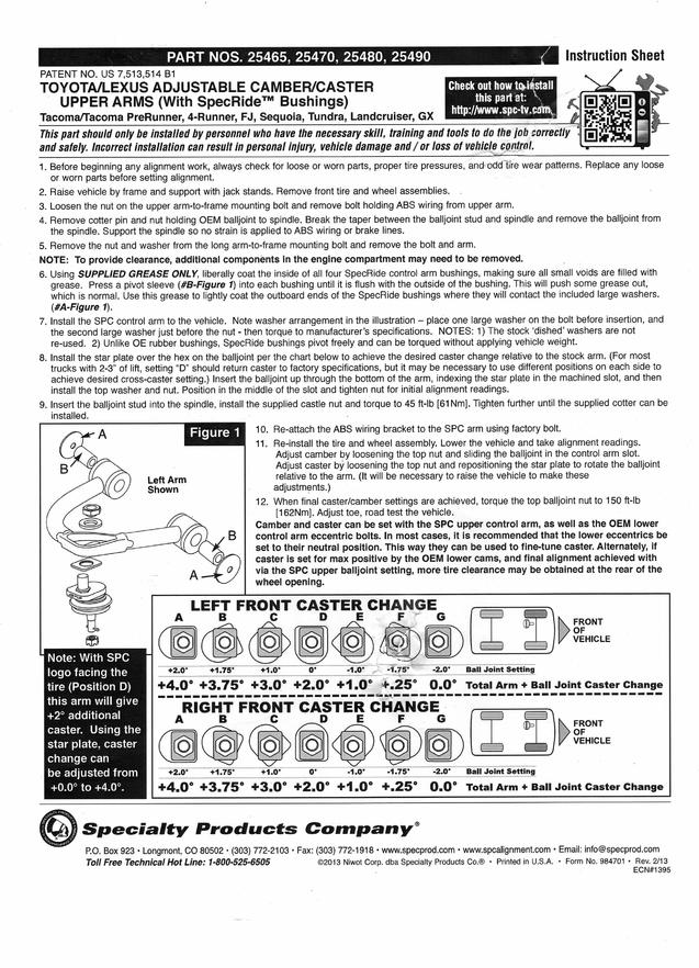

Not to nitpick but your upper ball joints are in backwards.
Not to nitpick but your upper ball joints are in backwards.[/QUOTE]
Do explain? I had a shop throw the lift in. dangerous?
I think what he meant is the round side should face in, but in your picture it's facing outwards? I scanned a copy of my install sheet from SPC for you to look at.
Personally, I would probably rotate it and make it point the right direction just in case...not sure if it's dangerous or not though.
With "SPC" letters facing inward, [MENTION=88437]Lebengeek[/MENTION] you probably won't get wheel alignment to spec. Didn't wheel alignment guy mention that?

I'll try to explain the ball joint "concern".
You upper ball joints are essentially installed "backwards". What this means is the offset of the balljoint is heading away from the vehicle. This causes positive camber (top of tire leaning out). Main Line, or whoever installed these, had to compensate for this with your lower control arm adjustment on the eccentric bolts. In your picture above (the one with the shock) shows the lower eccentric bolt maxxed out towards the outside of the vehicle. This moves the lower ball joint backwards. This will cause more negative caster. We want positive caster. Ideally around 4*.
If you look closley at your very detailed pic, you'll see both lower control arm eccentric bolts maxxed out toward the outside of the truck. This pushes the lower ball joint away from the truck. Most likely because they were trying to compensate for the upper ball joint that is too far away from the truck as well.
You are most likely not in a dangerous situation. Unless something was left loose. But that has nothing to do with ball joint location. You just don't have your truck aligned as best as possible. Especially with the quality of components you have paid for and had "professionally" installed.
