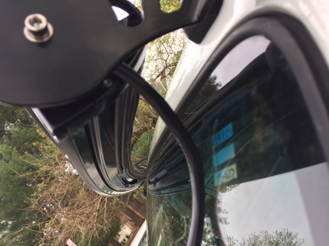

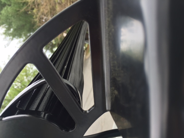

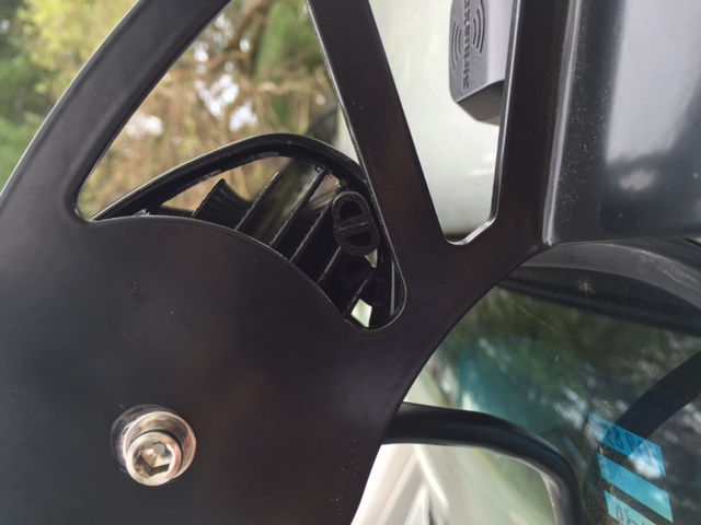

Fixed
Almost gave up on the bar when I figured i’d give it another shot. Went by home depot and picked up rubber weatherstrip tape.
Frost King E/O 5/16 in. x 1/4 in. x 17 ft. Gray EPDM Cellular Rubber Weatherstrip Tape-V25GA - The Home Depot
I came up short and was only able to cover up the bottom three fins completely. Since the weatherstrip splits in two with adhesive on both sides, I overlapped each fin, making sure there was no open space. Had a little extra leftover so i split it up between the last couple of fins.
With some trial and error, i tilt the bar up just a little and drove up to 55mph…
NO NOISE!!
I’ll probably end up buying another roll and to finish the bottom portion and to see if i could angle the bar down just a little more.
**Apologize for the crooked pics
