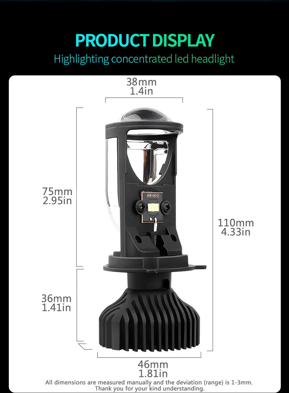

I'm one who doesn't think you can retrofit a LED bulb (2d light source into a housing designed for 3d light). Saw this mini projector a few weeks back that piqued my interest though (direct replacement for the h4 bulb, have to remove the glare guard inside the housing):
from here: AILEO Canbus 90W/Pair Lamp H4 LED Mini Projector Lens Automobles Bulb 20000LM Conversion Kit Hi/Lo Beam Headlight 12V24V RHD LHD|Car Headlight Bulbs(LED)| - AliExpress
plenty of other brands. Seems too cheap to be any good though and I've yet to see any other information about this type/size/style so I'm not in any rush to waste my money.
