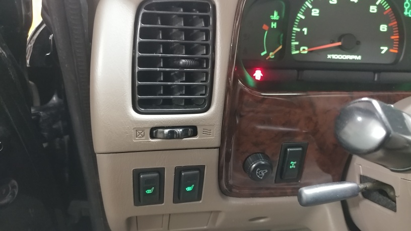

Just did my dash along with modifying a few switches with leds.
Looks so much better and now I can see my switches.

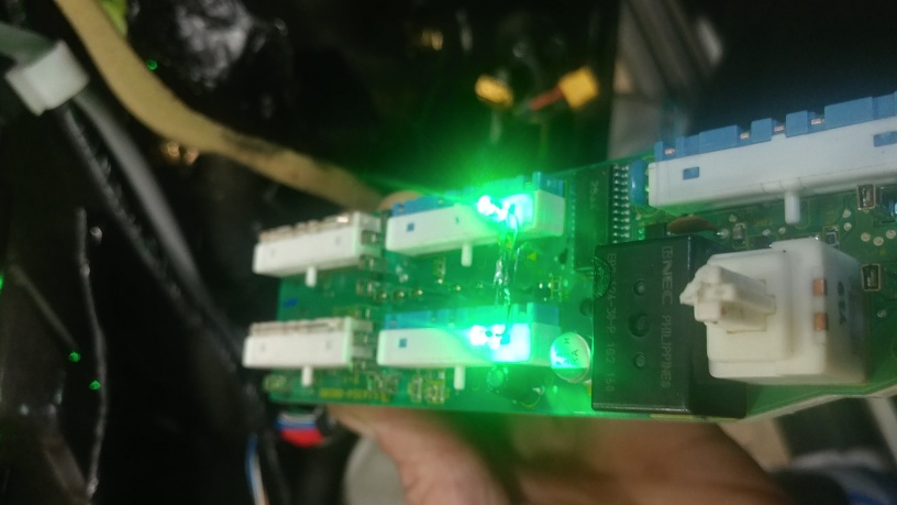

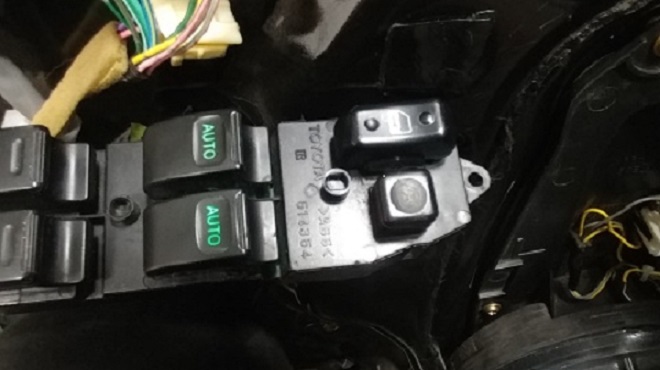

Hmm, was not aware you could do the window switches too. Might have to fix that! Was it easy enough? And what size bulbs? Never taken apart the door before
The window switches use one tiny led. I used two but you have to modify the switch for the pass switch to illuminate. You have to drill a hole under the lettering to let the light thru and install a clear lense to focus the light up. If you take off the switch rockers you'll see what I mean.

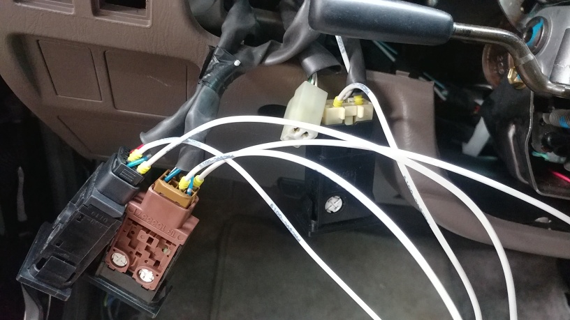

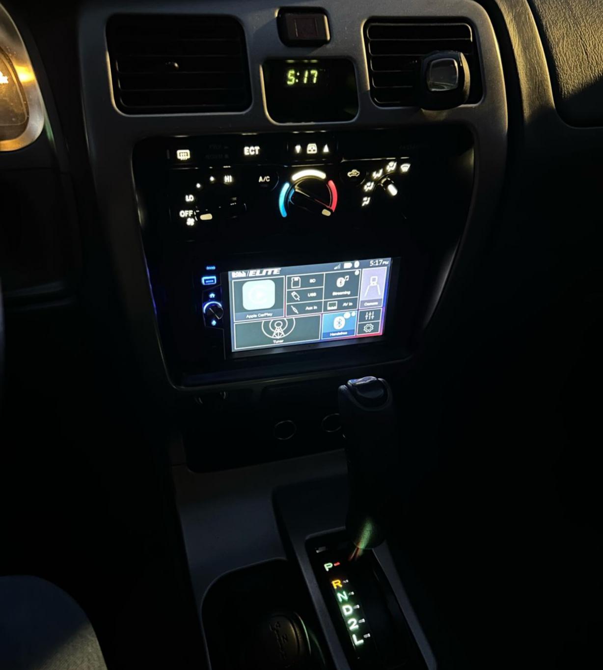

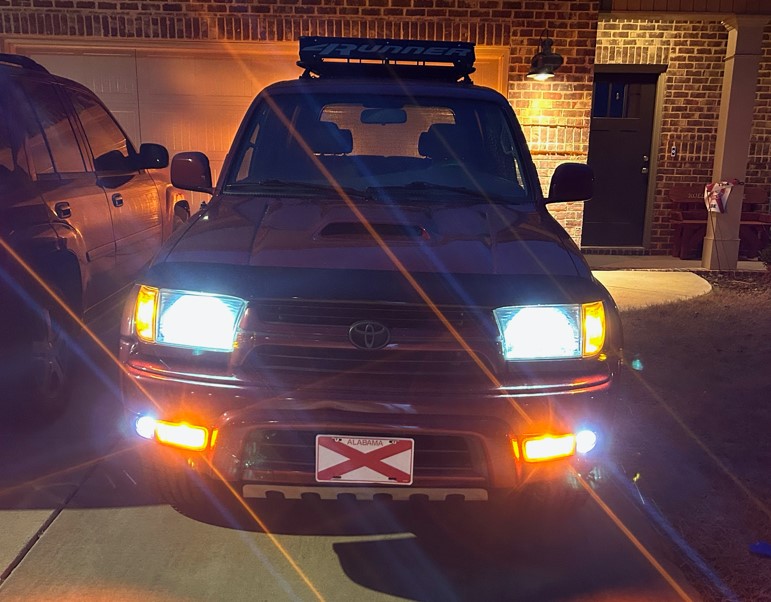

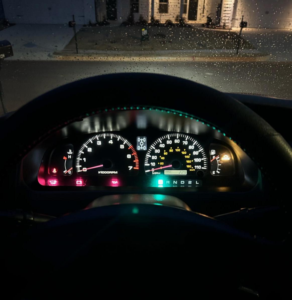

I just converted everything to LED on my 02'. I bought everything on Amazon and I will post all the links.
I was able to use the #74 LEDs for everything in the combination meter (except for the 4WD lights which I did not change). I have not had a problem with them going out. I would recommend buying some dimmer bulbs for the shift position. It is really bright. I'm contemplating on changing these back to halogen.

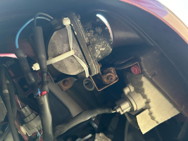

The biggest problem I had was swapping out my fog lights. I had to drill the small three bolts out of the bottom of the assembly to even change out the bulbs. The bottom cap is now strategically zip tied and its MINT (Roadkill fans know what I'm talking about). Every time I solved one problem another would arise. Needless to say, due to the elements, my wire connectors were brittle and the wires were toast. I ended up having to cut wires and splice my own connecters. The important thing is, they work!
If you swap blinkers bulbs, you will have to install an LED blinker relay to eliminate the hyper flash.
I hope this helps out. I will have pictures and links below.

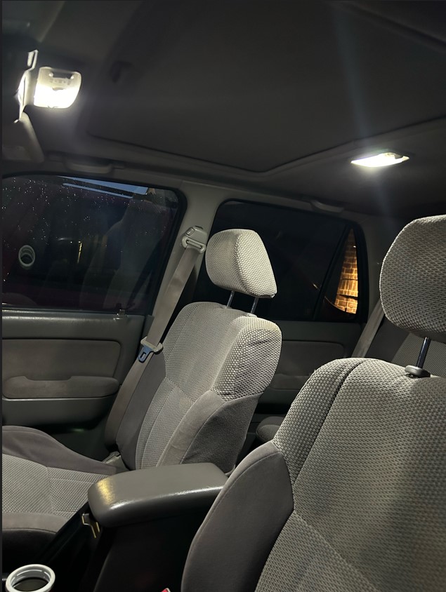

Interior lights, Tag Lights and 3rd Brake light:
https://www.amazon.com/dp/B078YL1NVN?psc=1&ref=ppx_pop_dt_b_product_details

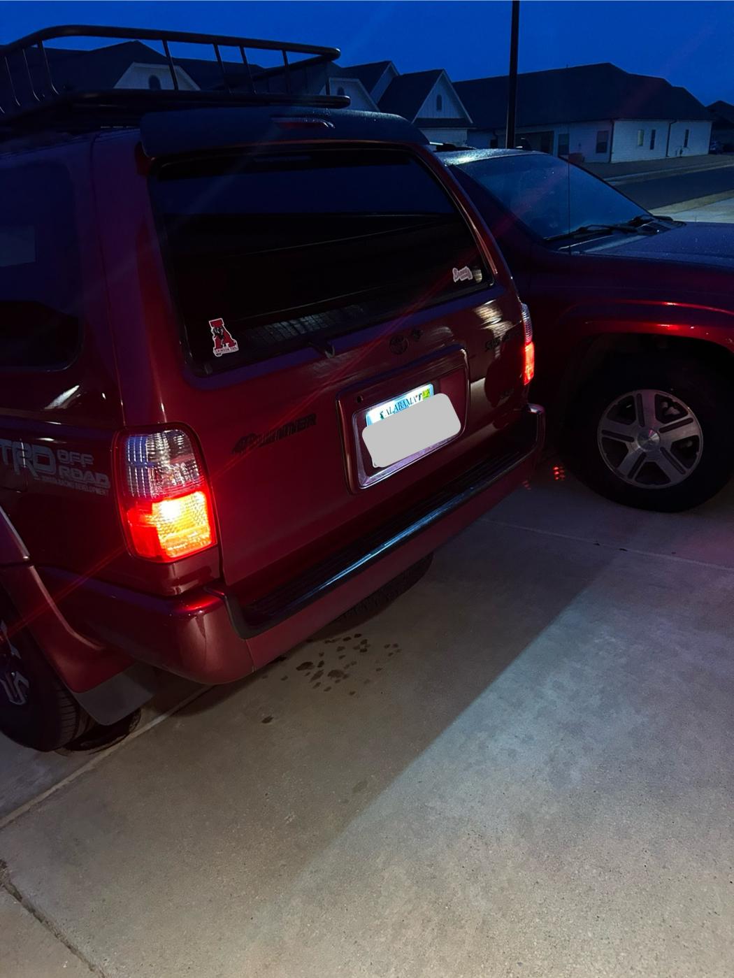

Front and Rear Blinker Bulbs:
https://www.amazon.com/dp/B07BXP49Q4?ref=ppx_pop_dt_b_product_details&th=1
LED Blinker Relay:
https://www.amazon.com/dp/B07QPSCPM7?psc=1&ref=ppx_pop_dt_b_product_details
Reverse Lights:
https://www.amazon.com/dp/B07M74ZNSZ?ref=ppx_pop_dt_b_product_details&th=1
Brake Lights:
https://www.amazon.com/dp/B071YZQGTS?ref=ppx_pop_dt_b_product_details&th=1
Head Lights:
https://www.amazon.com/dp/B0CMT2RQ93?ref=ppx_pop_dt_b_product_details&th=1
Fog Lights:
https://www.amazon.com/dp/B0CNVRY2K2?psc=1&ref=ppx_pop_dt_b_product_details

Two years ago I swapped all my interior dash lights for LEDs. I am in the process now (almost complete) of redoing everything. Let me explain why:
1. I went with all blue LEDs bc my vehicle is blue. Because some of the lenses are colored, the shade of blue can vary with the finished product. So that has been bothering me for two years. The blue NEO light bulbs for the center console also didn’t match perfectly with the dash shade of blue.
2. Some of the indicator lights are too bright with LEDs (especially the high beam and D gear lights).
3. After switching to LEDs, my TSC TRAC light came on. I replaced 02 sensors, ran Cataclean, everything to try to avoid replacing catalytic converter. Nothing worked. Then I just happened to stumble across a post of someone with a 2002 4Runner that had same issue and turned out it was the LED bulbs.
So to correct these issues, I used green LEDs for the large gauge dials, went back to halogen bulbs for all the indicator lights, and went with white LEDs for center console lights. This has gotten rid of the TSC TRAC warning light and in my opinion looks much better. It’s also much quicker with the halogen bulbs since they don’t have an orientation like the LEDs…you only have to put them in once.
I would highly recommend only using LEDs for the 3 large gauge cluster lights and sticking with halogen bulbs for indicator lights.
Just my 2¢. Hope this helps anyone contemplating this project.
