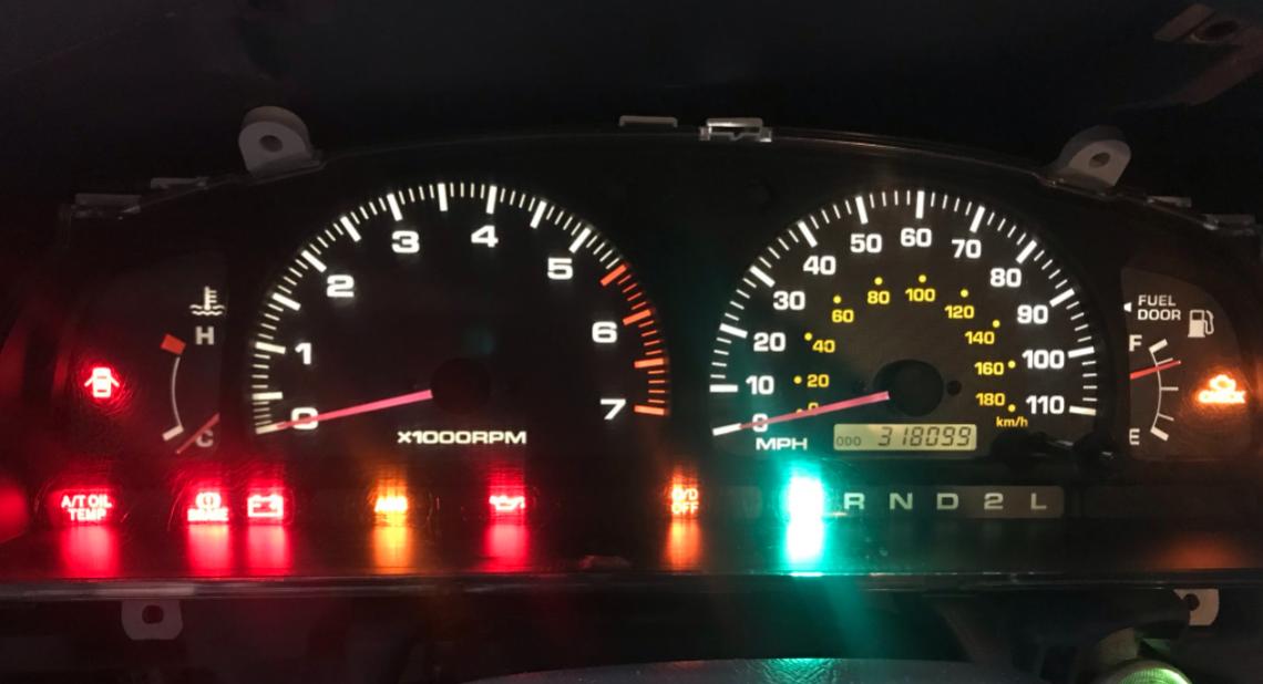

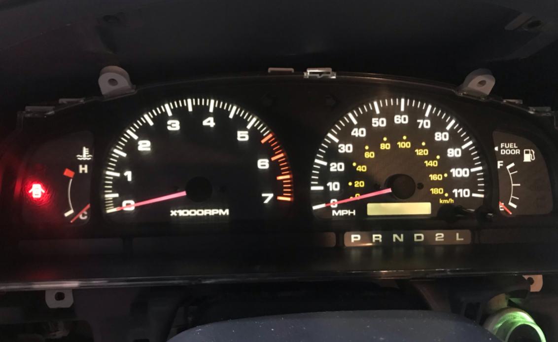

Here are a couple of shots of my 99' cluster. The backlights are 6K white's from VLED's, the rest are color matched VLED's. All bulbs, including the backlights, are 74's. The base that the backlights go into is a different color than the other, but it has the same writing on it (TOSHIBA T4 or something). Anyway, the 74's seem to be working fine as backlights with no hotspots. Others have reported the same.
VERY clean looking! I'd love to do a white dash but my climate controls have been converted to amber/orange and I'm not sure how it would clash. Not the biggest fan of having an orange dash due to CEL and low gas lights being very similar

Thanks. Interestingly, I had forgotten that I ordered a couple of the Samsung 24's linked elsewhere in this post so I'm going to throw them in maybe tomorrow and do a comparison to see which looks better. I'm very happy with how the VLED's came out though.
