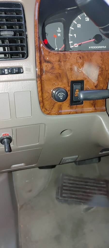

You can see the rheostat in the image below next to the RR DIFF LOCK button. It's easy enough to skip while checking things because you can check thinks without putting that trim back on. Without that connected the dash lights will all work, but all of the backlighting of gauges and things on your center console won't work without it. I think the auto climate control backlighting still functions since that is on all the time rather than being switched.
Ahhh, I see. I was hoping it was something simple like that but if I’m understanding right, it wouldn’t be the rheostat. I’ve never had to unplug it. I’ve only pulled the cap and taken the nut off to be able to remove the trim. It stays plugged in and hanging loosely.
Even while testing lights, I turn the pin back and forth and all the center console lights dim and brighten.
