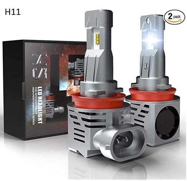

I replaced my low beams with the light bulb below labeled H11. So, far they seem better than the factory halogens, they are a lot whiter. I have not had the time or need to do a lot of night driving, but in a few trips around the neighborhood they seem better than halogen, not as good as HID. I can report that the fitment was perfect !!!, 15 minutes to change them both.

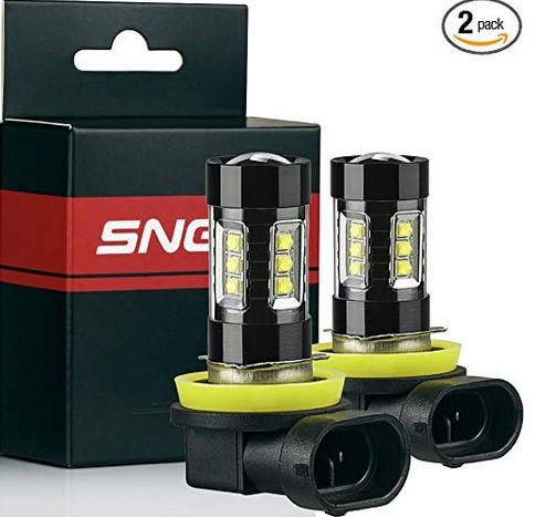

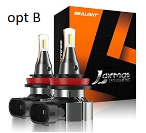

Is there any consensus or opinions as to which style H16 bulb:
opt A - LEDs are all around (360 degrees) or opt B - LEDs are at 9 and 3 o'clock (like the newer style LED H11s) is better or more preferred.
lastly some of the Amazon reviews for the 'all in one' style of the H11 I used
(H11) imply they used it for both the headlight and the fog light.
It seems some of our posters are running the H11 as an H16.
q. Are they too bright ? (blinding other drivers), how is the pattern ?
from my fog lights I'm looking for a wide side to side coverage that is under the low beams.

from what I have read you want to buy the LEDs with the left right diode. not the all around. then when you install you want to make sure they are on the horizontal plane and not vertical.
