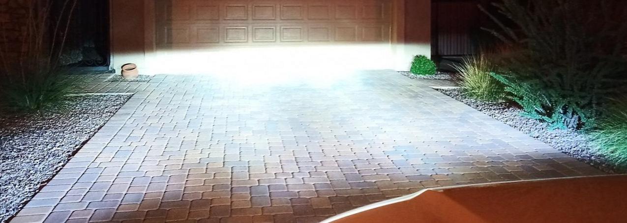

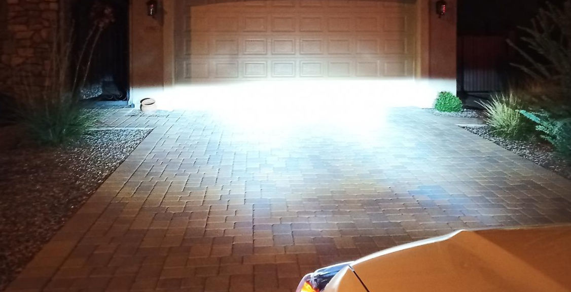

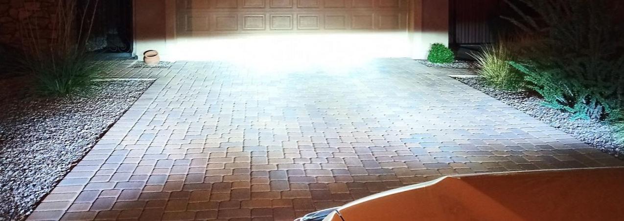

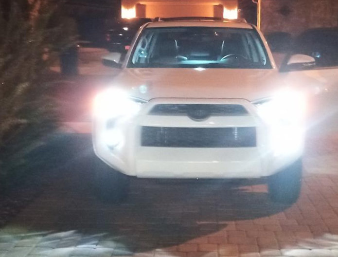

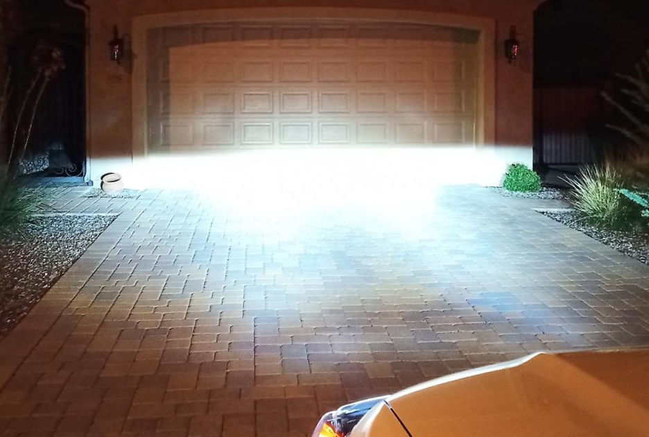

These are not the best photos - but they'll have to do for now.
The first 2 pictures are of just the headlights.

the next 2 pictures are of the headlights and the foglights.

the last picture is taken from 15 -18 feet back.
the headlights have a clean cutoff (my driveway slopes upward slightly), the foglights pattern is UNDER the headlights with a wider illumination pattern.
when approaching the vehicle (from another vehicle) there does not seem to be a blinding pattern, so far i have not been flashed.
