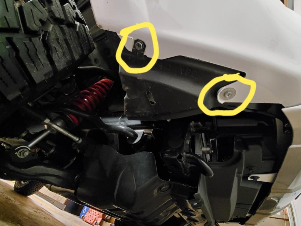

Lay on the ground (passenger side) remove (2) 10mm bolts holding up the plastic stuff directly under fog light area. this allows you to bend back the wheel well and have full access to the fog light. for whatever reason they put a shield there, I pulled mine bottom center towards rear of the runner and 3 clips popped out, put the shield on the ground, now you can see everything you need to see. 2 screws and the fog comes out. 1st time I tried I cut the hell out of my hand because I didn't know to pull the wheel well back, read others are pulling the bumper (thats not hard by the way) but what I said above takes no more than 5 minutes to change the fog, maybe 10 1st time around

For those that missed my post. No need to pull the bumper.
Remove (2) 10mm bolts shown in pic. Push wheel well away and you'll have full access to the fog light. The cover over the fog? Grab it and it pops right out. Simple, easy and your done in 3 minutes.

Love the fogs, super easy install to boot. The passenger side only required removing the two bolts from the bottom and then folded the liner back and over the outer tie rod. That fog splash cover literally pops off with a minimal pull and then hinges upward to release. 2 screws on the fog, voila removal complete. Did the drivers side just by reaching up from the bottom and removing the fog light screws.
Might have taken 25 minutes total

Thank you for being the 1st I'm aware of to admit the passenger side does not require bumper removal or busted knunkles to get at them. take those two bolts out and it opens up with free and clear access!
