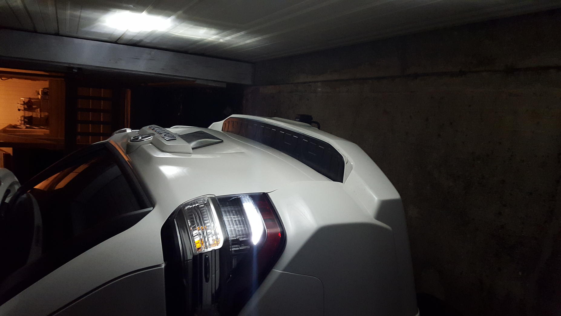

hi, i bought the yitamotor leds from ebay and they came out great. does anyone know where i can get HID's for a 2016 & 2015 4R (wife and I's)
I decided to go with the Phillips for reverse lights because they are brighter.
