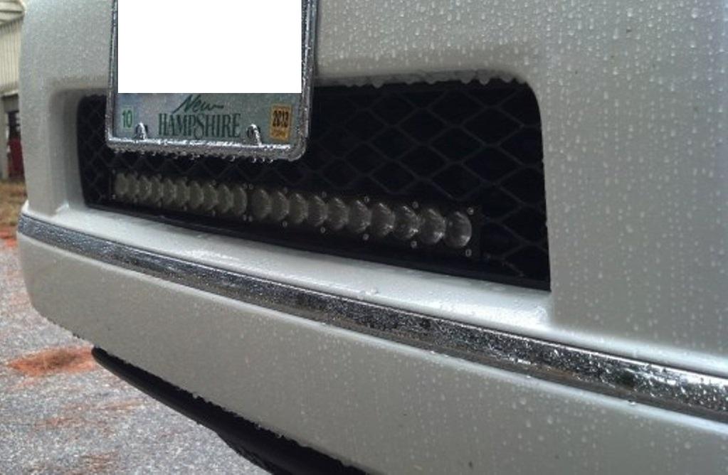

Thanks for the photo's. The light bar does seem to flood short distance pretty well, but I think it's getting diffused by the grill. I would tape it to the front of the grill and try it before cutting the grill. In fact, putting it outside and below the grill would be my preference before cutting. Seeing it in person may prove different cosmetically.
Thanks for that input, but I have no plans on hanging it outside the grill.
The only other choice would be to trim the grill IMHO!
My choice was to cut and mount flush for that OEM look. Hanging below doesn't work where I live.............one snow bank, say goodbye to that $$$$ light bar.......been there, done that :dammit:

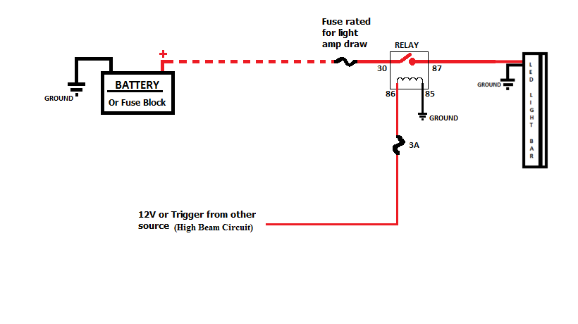

Here is a wiring diagram for connecting without using a switch:

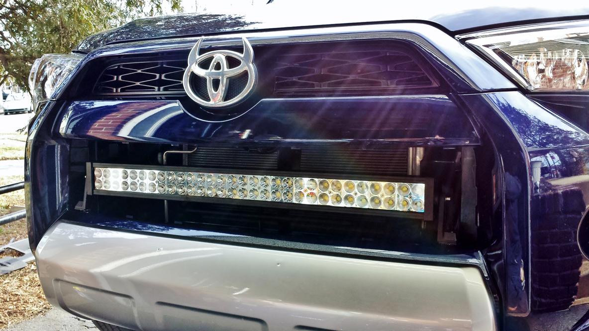

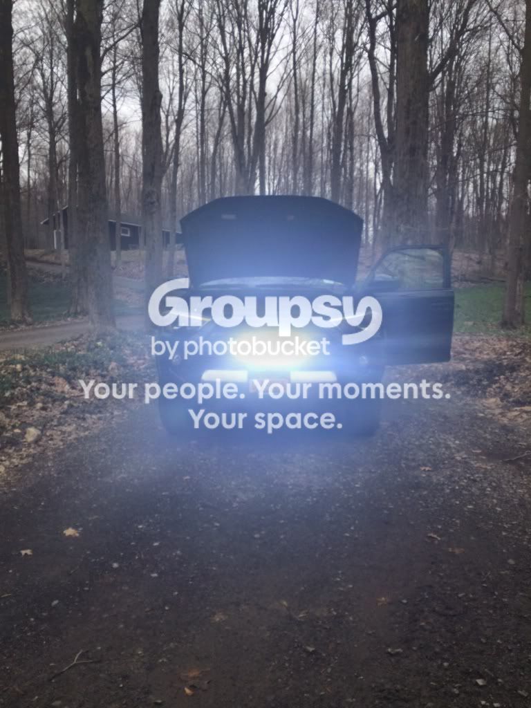

After much thought, I opened up my grill today....to let the SUN shine! :becky:
Was easy to do with a utility knife and a propane torch.
That sounded funny, so I better explain.....heat the blade with the propane torch and it cuts thru the plastic grill like hot butter.

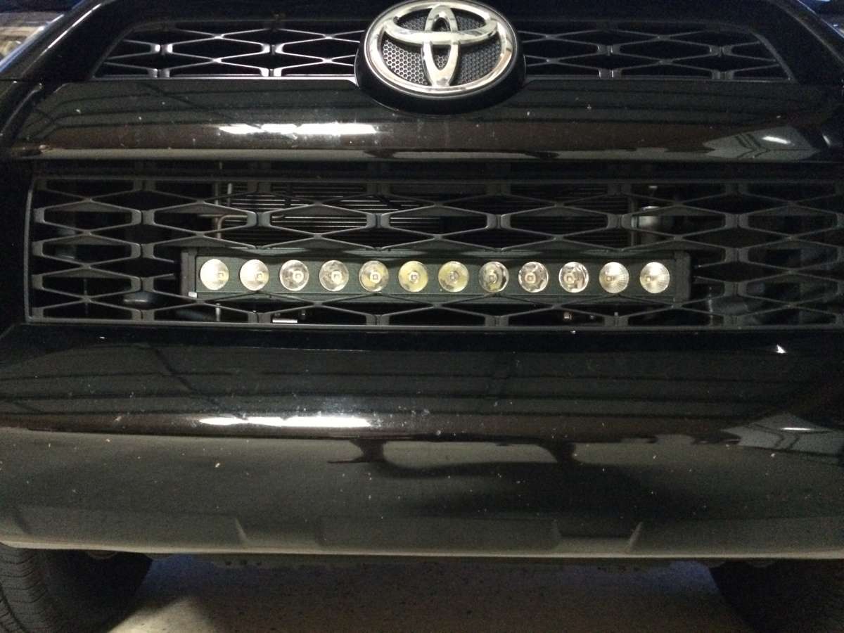

I had the same thought about location when i brought my 14 home but didnt want to cut that much grill out so soon.

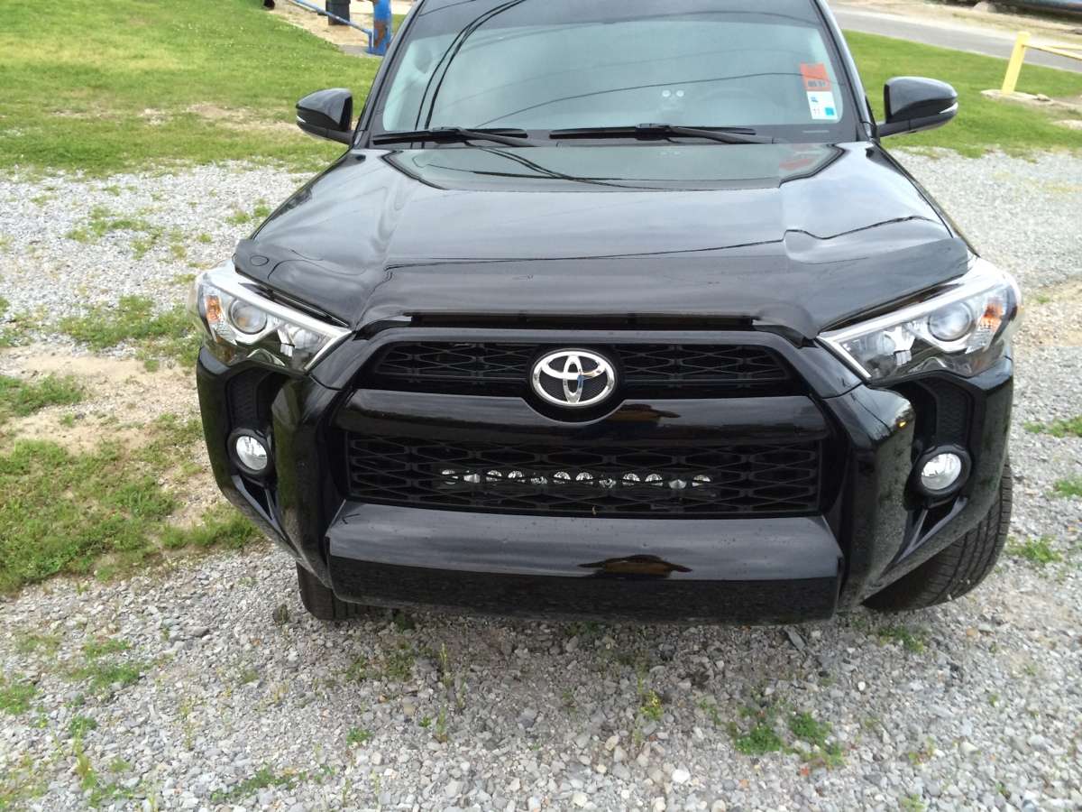

You guys spaced/drilled the bumper beam for this; are you able to fish a bolt up through the bottom of the bumper and then put the nut on from the top?
I just put in 20" bar on my '14, by running two 4" stainless bolts down from the top, and "hanging" my bar upside down. No cutting/drilling, and works fine on the road. But off-road it vibrates more than I would like.
image_zps069f80bd.jpg~original
I drilled and tapped my bumper, bolted it from the top. Didn't drill thru the bumper and fish as you described.
