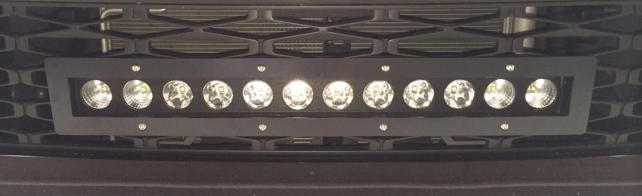

Completed and installed my Custom LED Light Bar/Grill Faceplate
I did this because I was not happy with the way just cutting the grill turned out. Thanks to [MENTION=106209]FloridaOccifer[/MENTION] for jogging my thoughts on this process!
Please excuse the horrible pic, its raining here and light is terrible.

looks really cool. looks a lot better then what you started with.

Nicely done sir!

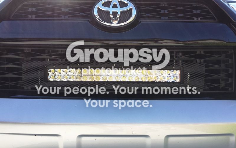

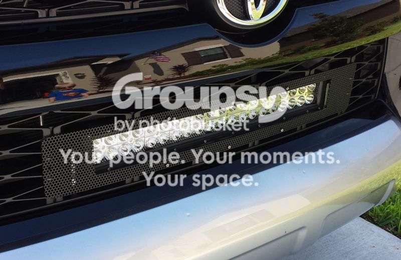

I finished my homegrown solution and mounted it up yesterday.
Saker, thanks for the boost of courage to move forward on this project. I took 10 times longer on this one than I ever have on my other vehicles just so I could make sure it was as close to professional as possible.
Awesome thread.
Please tell me all about your faceplate. It looks absolutely first class.
What material did you use?
How did you cut it?
How did you mount/anchor it to the grill?
Are those rivets or allen heads or torq heads?
Thank you!!

Starting at post #50, but not all inclusive...
:thanks: for the kudos GiGi's 1996
Material: .065 thick aluminum
Cut & supplied by: Waterjet company locally for 50.00. I supplied the detailed drawing for my dimensions.
Mount/Anchor: On the back side of the grill, upper and lower plate, there is a piece of same material with matching holes to cover. The grill is "sandwiched" between the outer faceplate and the inner pieces behind the grill.
Rivets or allen heads or torqs: I used these "#10-32 stainless button head socket screws, & stainless nylon insert nuts to fasten it with". I came back and used some #10 stainless flat washers on the outside, behind the head of the button head.
Hope this helps. I am thoroughly satisfied with the outcome!
