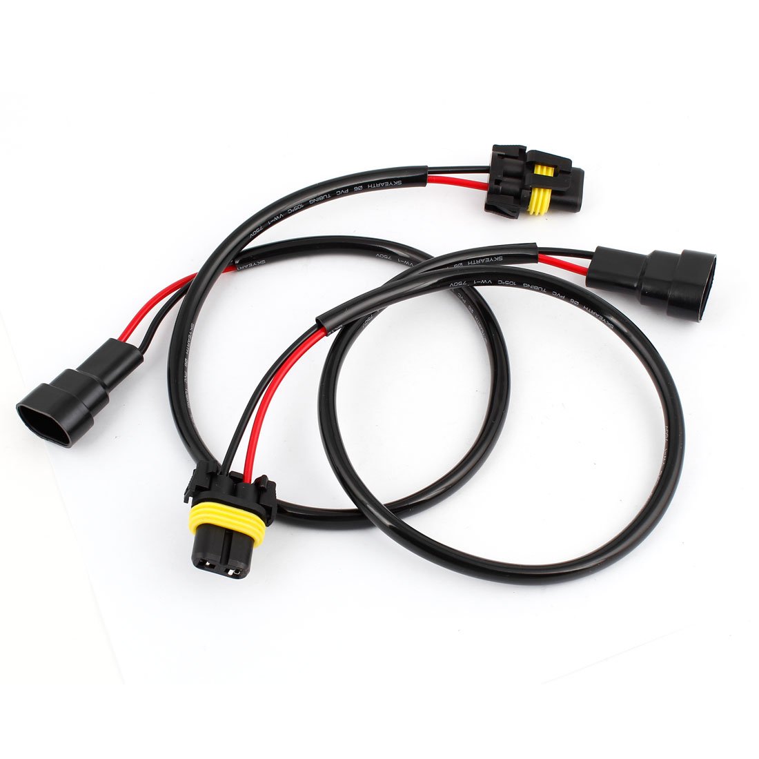

You can cut many of these in half and have a standard "fog light" connector:

I bought a kit of Weatherpack connectors to use for any wiring that is exposed to the outdoor elements. When I built my rear bumper and installed my backup lights I wanted some quick disconnects for the wiring in case I had to take the bumper off, and it's come in handy several times.
