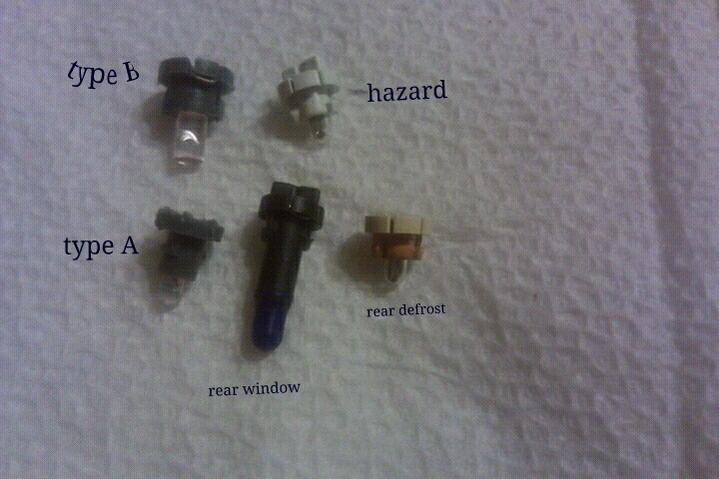

Anyone having issues installing the neo-wedges for the AC button, Rear def, Rear window button, and the Hazard for a 99 4R? I ordered a few type A and type B from Autolumination and they don't seen to fit correct. They looked different than stock bulbs. I even tested the bulbs before I installed them and then all light up fine. I was able to squeeze the type A in, but they are really tight and they still don't work. I might have installed them the wrong way, but I can't remove them without ruining the bulbs. Forget about the type B, they are just way too big to go anywhere. Is there any modifications that I need to do to make the work? Are the neo-wedge different from Vleds? See picture.
the Type A will work in the A/C but there is a green film behind the transparent letters so if you use white, it will still be green.
the type A's will NOT work with the rear defroster, those bulbs say TS on them
I did manage to get the A/C bulb out after I put it in, and turn it around for the correct polarity, but its tricky... have to have some eyeglass size flathead screwdrivers...
the Vleds " type A" or "t3" bulb is also larger than the original...
