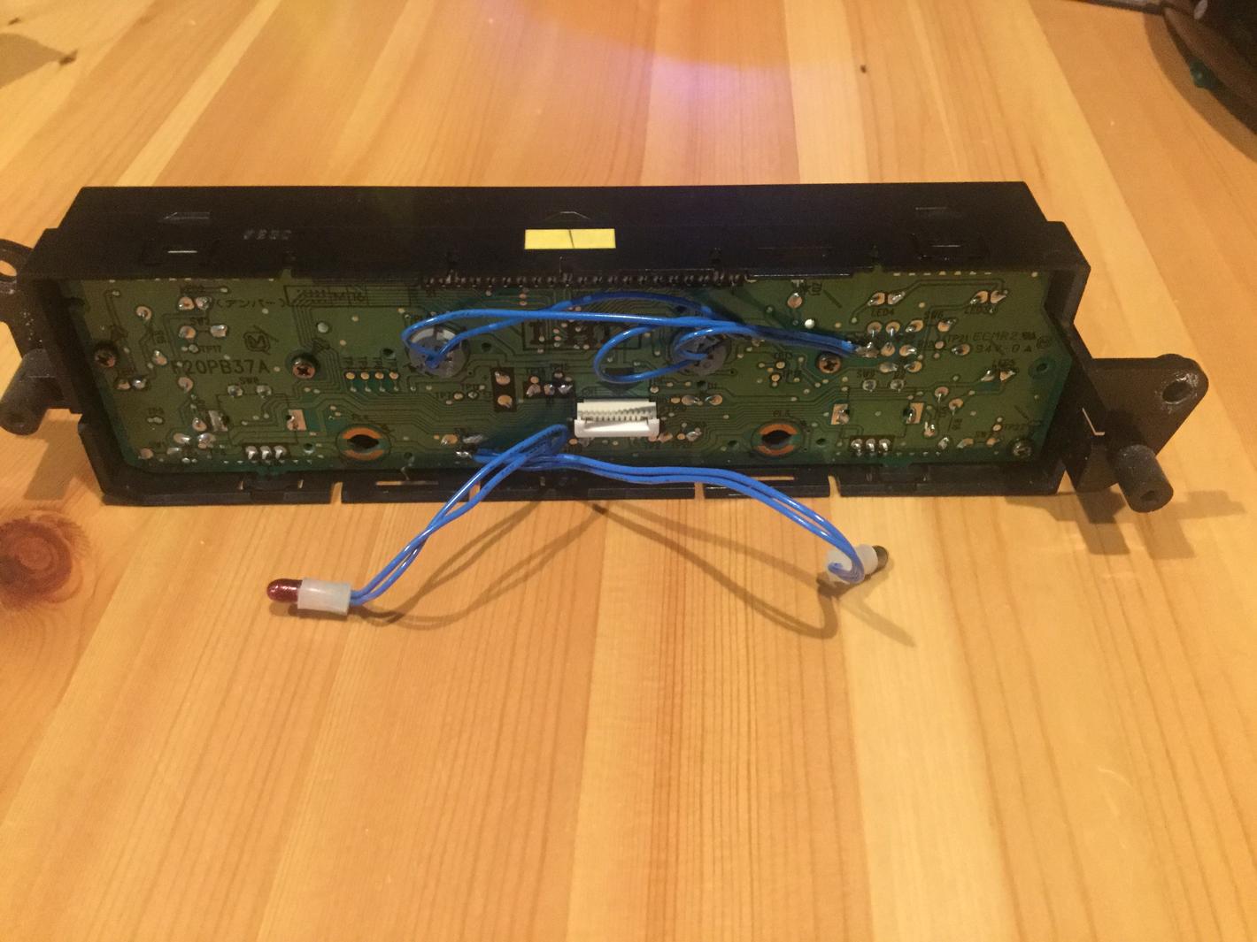

Sorry to resurrect a old one. I have been everywhere I can think of looking for answers and turned up nothing. Doing all the dash LEDs and when I got to the auto climate controls I find this. Any one else have the blue wires that are hard wired to the bulb? And know if the neo a bulbs will work if the wires are clipped?
Thanks for any help on this one. It's a 99 limited forgot to mention that

Wow, I've fixed hundreds of these and I've never seen a hack job like that. (I have seen some pretty bad hacks though) It's hard to tell whats going on but it looks like someone is tapping power for the bulbs off a different spot on the PCB. Normally you just put in T3 and T4 Neo Wedge LEDs in any color you want. Also, that ribbon cable holder doesn't look right. Does the control actually work?
works fine
Yeah i was really surprised to find that but it does function. i just find it hard to believe someone other than the factory did it because other than looking like a hack job the wires were all nicely taped down before i got to it and the solder points are not that bad. Also i ran a continuity test from where the wires are on the board to the contacts. I went ahead and ordered some neo's for it and going to test it before cutting the wires.
