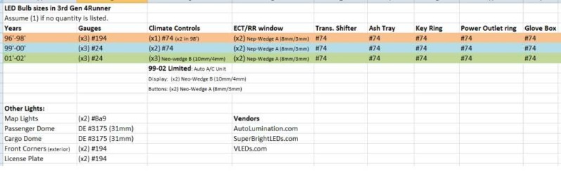

Have you seen this chart? http://www.toyota-4runner.org/736596-post17.html
Pretty sure the limited models need the following:
2 Neo Wedge 4MM (for the display background)
3 Neo Wedge 3MM (for the climate buttons)
2 Neo Wedge 3MM (for ECT/RR window button)
They are listed as NeoX -xhp where X= size of the bulb 3/4/5 and x=Color hp is hi power
Can be found here:
NEOx LED Bulb - High Power Instrument Panel LED | Subminiature | Specialty & Automotive | Universal LED Bulb Finder | Super Bright LEDs | Super Bright LEDs
I did my swap in my SR5 and used all the following:
2 BA9S-WHP9 Cool White (map)
3 NEO4-RHP 4mm NEO4-xHP Red (Climate Control)
2 NEO3-RHP 3mm NEO3-xHP Red (ECT/Window Button)
1 74-WHP Cool White (Glove)
1 74-RHP Red (Key Ring)
3 24-RHP Red (Dash/instrument)
Man I am so confused right now, I have a 2WD '99 Limited and want to change the Digital Climate control to blue and the gauges to blue as well. What do I need exactly? And how do I know which slots they go in? I've waded through 30 pages of this stuff and still can't seem to get a straight answer.
^^ TheemikeB beat me to it. However, I you only need 2 LEDs for the buttons on the digital climate control
This chart shows what you need. I went to LED Lights, Bulbs & LED Lighting Accessories - SUPER BRIGHT LEDS | Super Bright LEDs Get the high powered ones (designated HP in the part #)
Here's the # for the buttons:
Qty 2 - NEO3-BHP 3mm NEO3-xHP Blue
And here's the # for the display
Qty 2 - NEO4-BHP 4mm NEO4-xHP Blue
I did the blue also. Looks very cool. May want to do the ECT and rear window buttons while your at it. They use 2 of the 3mm ones. The only thing you cant change (unless you want to desolder/ resolder) is the little green LED's on the AUTO button and A/C button and the orange one on the Defrost button. If you need some pics, of what it looks like I can upload some tonight. Hope this helped. Good Luck!!

In [MENTION=57546]4-Ripcord[/MENTION]'s description he states he used "3x #74 (#24) Matrix 5-LED (Type 1; with 3 LED on top, 2 on sides)" on the gauges
Can some one explain the "#74 (#24)" portion. I have a 99 and according to his chart I need #24 for the gauges, is that right?
Can be found here:
#74
These not the same! They have different bases and different diameters. By gauges you mean the speedo, tach, and center light. Those three bulbs are #24. Your blinkers are going to be #74.
#24
