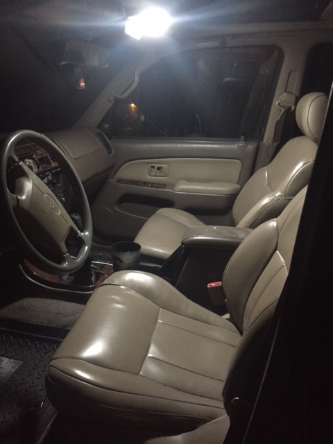

Here we go, I finally got my 25 LED Dome light from oznium. It had been back ordered since December 16. Got it installed today and it's bright as hell. I would definitely suggest this if you're looking for a light upgrade:

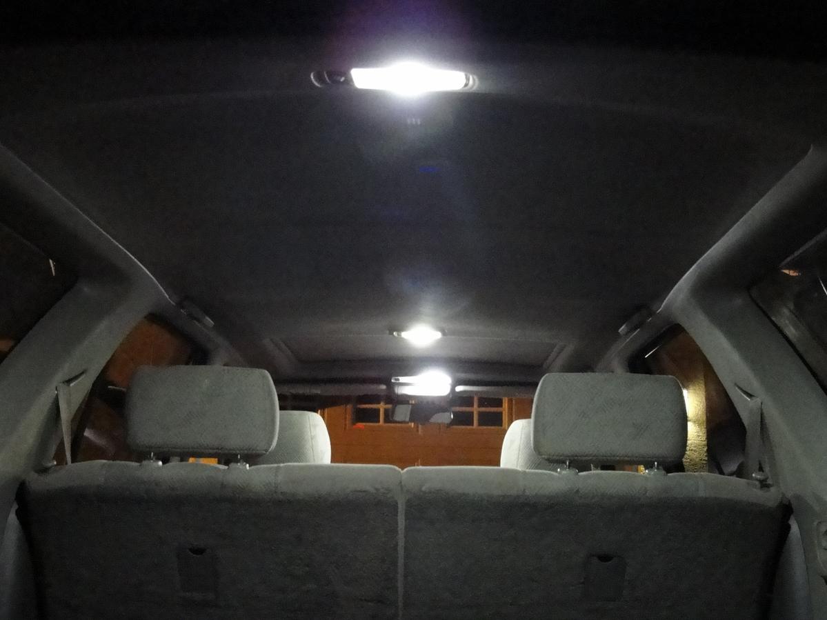

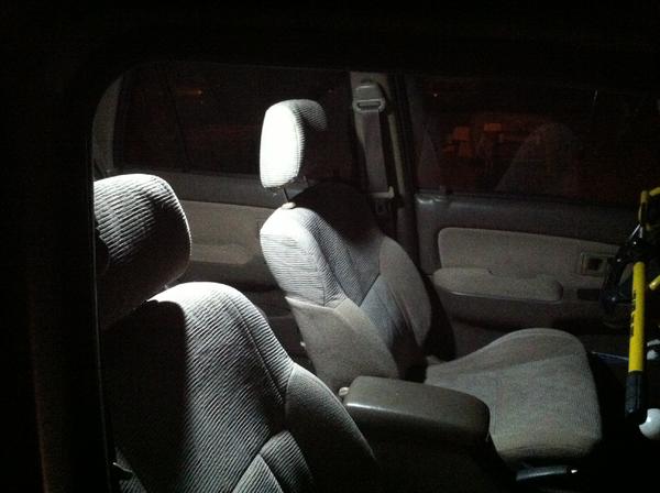

this is what mine looks like with 12 led panels in front and rear domes.

Where did you get those? Part number? Thanks.
ebay. they are described as "white 12 led interior dome map light smd panels xenon bulbs hid lamp #A1". i bought them from a company called fyreflys.com, who sells on ebay. well they did anyway when i bought these in july.

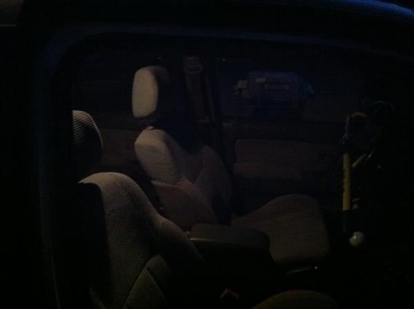

I went from this...
To THIS!!

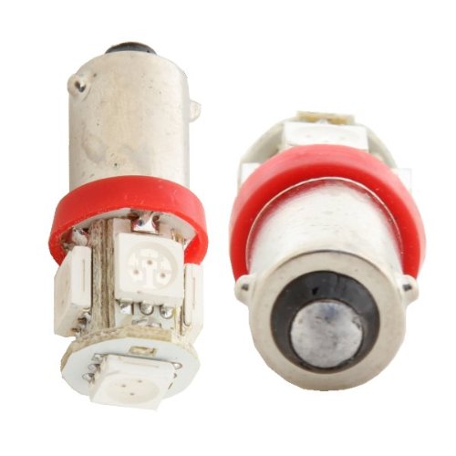

I also changed out the map lights to Red LED instead of white, to help with night vision. I'm not sure why I didn't get a pic of it, but I will tonight and post later...

Part #
What's the actual part number for the led front map lights. Everything I see says 3175 (Festoon style) but they have a regular style base like what's pictured above on the red ones. I have a 2000 SR5,

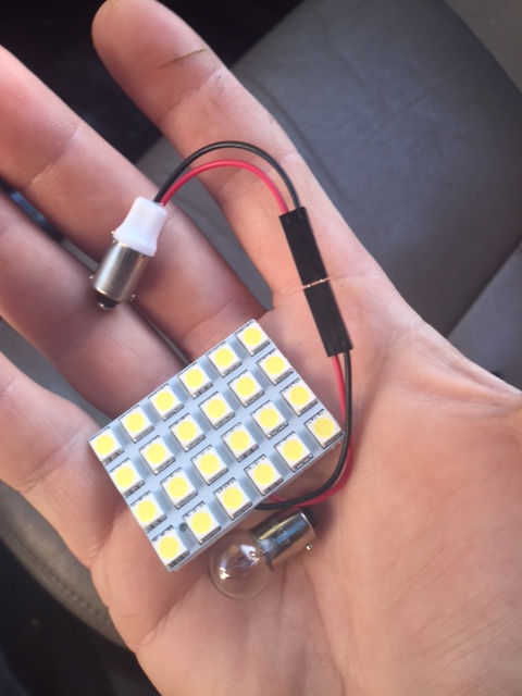

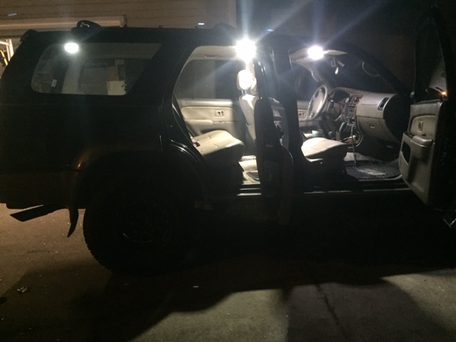

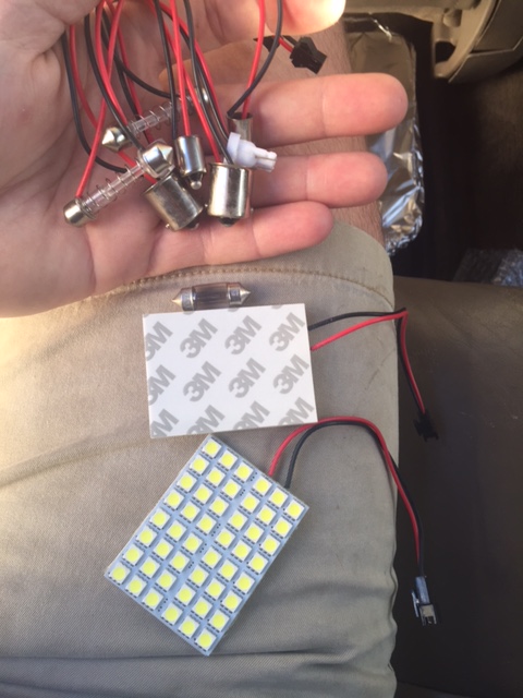

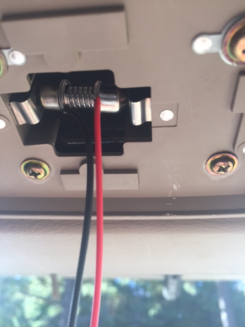

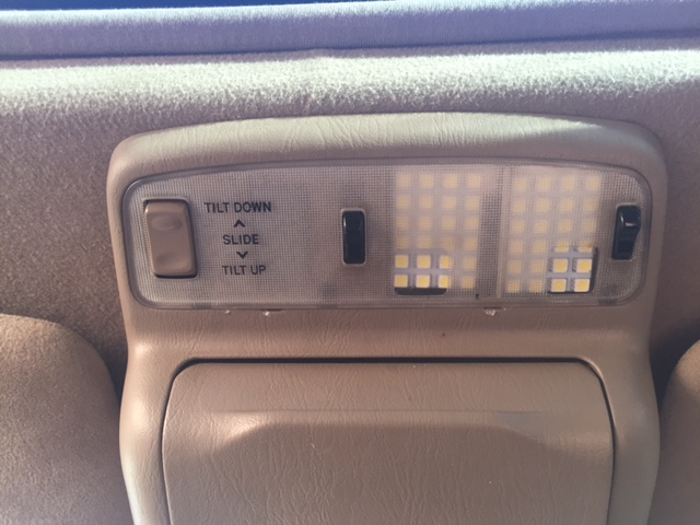

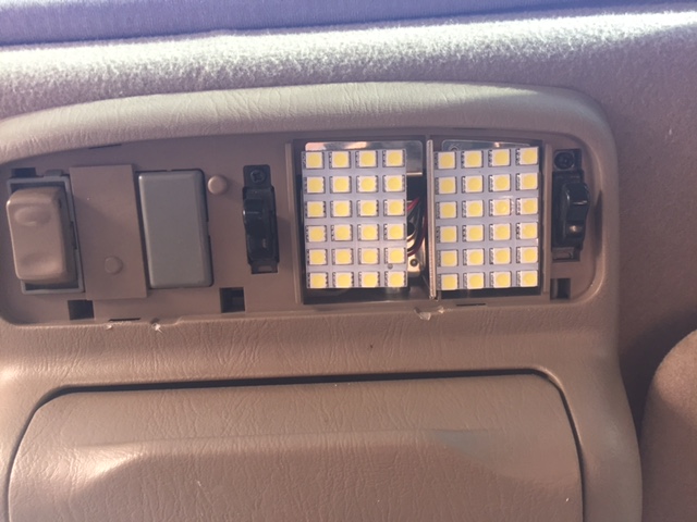

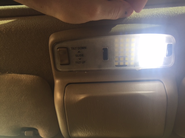

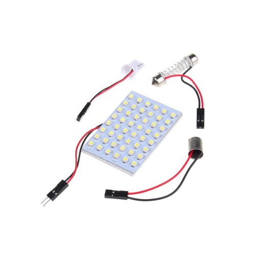

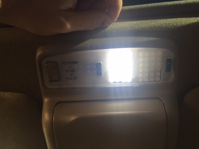

For the map light I used two 24-SMD Led white lights. This allows each switch to retain its function instead of having one big light in there hooked up to only one switch.

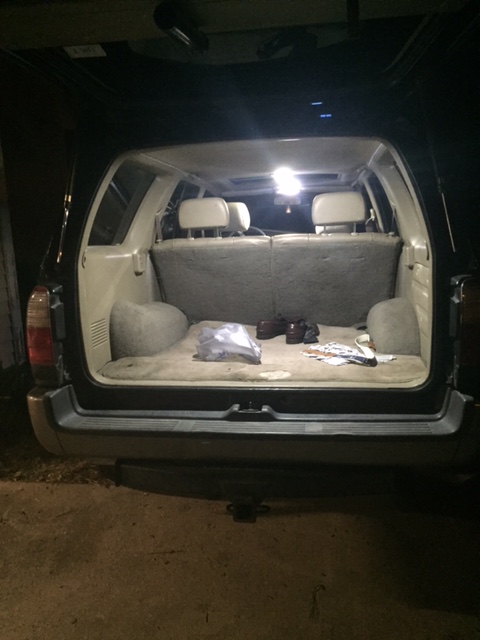

For the Dome lights I used the 48-SMD Led white lights.
The LED kit I bought on Amazon for $8 for a set of 24-SMD's and $8 for a set of 48-SMD's. Each kit comes with all kinds of connections. See my pictures for installation. Here is the link:
https://www.amazon.com/gp/product/B00FKPJJNY/ref=oh_aui_search_detailpage?ie=UTF8&th=1
