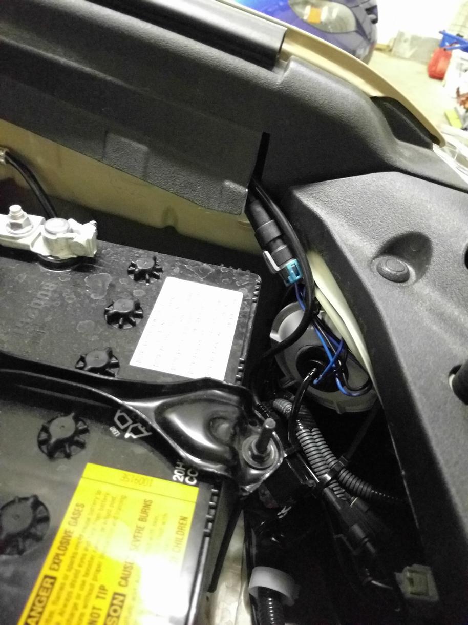

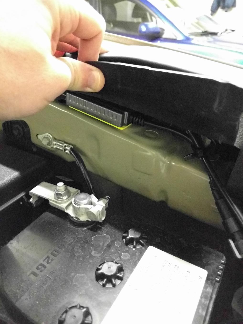

It really is not hard. If I can do it, anyone can LOL. I just put mine under the plastic lining on the sides. There's a semi flat surface there, and better covering.
Sorry I meant without using the 3m tape. I'm worried about the ballasts coming loose over time. I've used that stuff before and heat will start to weaken it. I like to screw mine down so I need to find some place I can get a drill and fit the ballast. Thanks for the pics tho :) I guess I could always try it and just keep an eye on it too.
