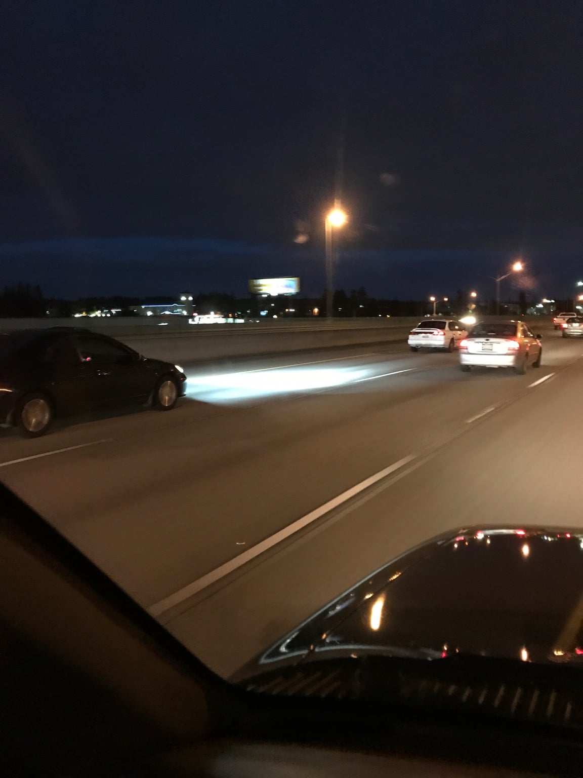

Brighter? Probably.
Light up the road better? Maybe.
Shine in other drivers eyes? Likely.
Light up the road well? Not likely, and definitely not well at a long distance. Where the LED is really falling short is the ability to throw light very far out.
I took this pic on the way in to work this morning, and it pretty much sums up LED drop in replacements-
Are they aimed too low? It sure looks like it, but I'll bet they have to be aimed about that low in order for the scattered light to not piss off oncoming drivers.
