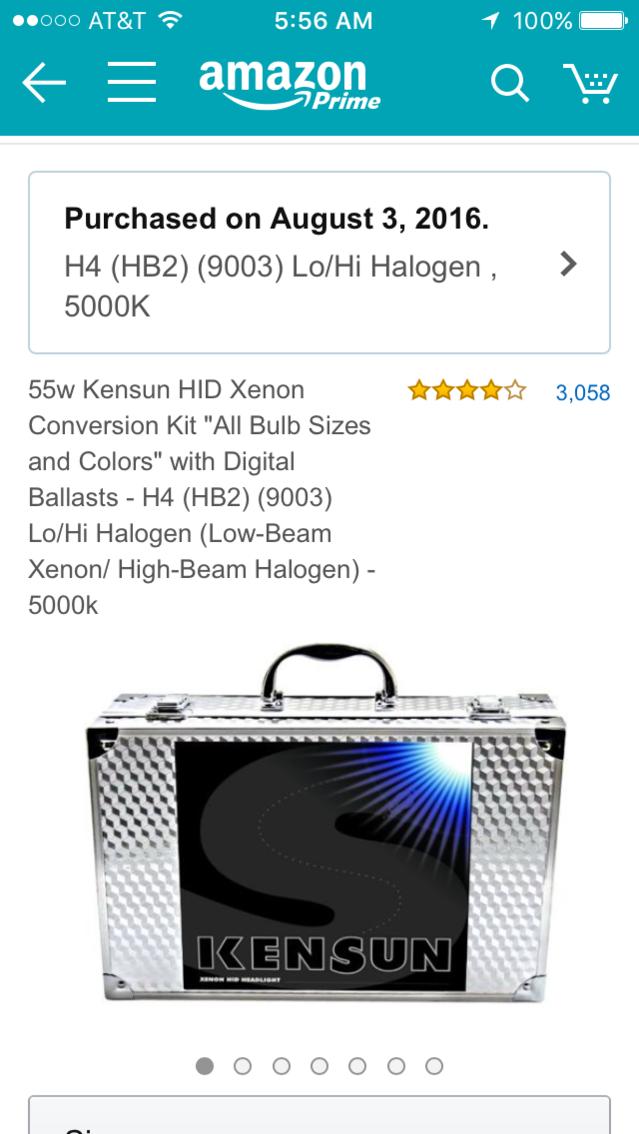

Hi! Can you please let me know if this HID kit could be used for this project? Thanks,

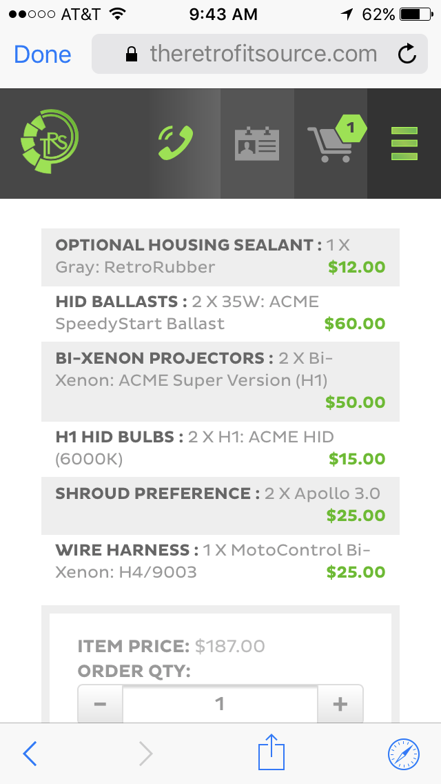

No, if you buy the one I put in the link, it comes with everything you need. The bulbs that the projector use are H1 bulbs. The harness from TRS you will select H4
Yes, I'm not sure you'll need any sealant, I didn't on mine. 6000k will be a light blue and 4300kbwill be pure white. I really prefer the 5000k, but I'm guessing they're sold out.
Exactly, apparently the 5000k are sold out. Thanks for your response.

Thanks, absalom! Could you please let me know why you recommend 3" projectors (D2S) with 55 watt ballasts? Actually I have this HID 55watts on my headlights and want to know if this can be used in conjunction with the 3" projectors.

Ok, since the shipping from the DDM Tuning is to high for my country (PR), I will go through EBay and think to buy the following items that are free shipping to my country; also I will to try the above mentioned Kensun conversion kit 55W HID (that I have already mounted on my 99 headlights) together with these projectors and shrouds. I hope that these projectors fit perfectly on my headlights without a major modification. Please I will appreciate your inputs and help regarding this project:
