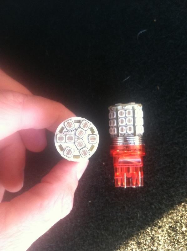

I know that with the turn signals, you need a resistor or flasher (if they make a flasher for the 5th gen. I have the 7443s (dual intensity) - part number 7443-R45-T and I don't need anything extra - just plug them in and go. After I installed them, I have had no problems. I took a pic of the lights I'm using. Did you order yours from superbrightleds?

Can you clarify with your set up. Are you saying with the dual intensity LED bulbs, you don't need the resistor or flashers to prevent the hyperflash on the signal lights?
I used your part number 7443-R45-T, on superbrightleds and nothing came up. Did you mean 7443-X45-T?
I have those same LEDs in mine. I have had them there for a year now. The visibility in day and night, and from all angles is better than the factory bulb. I have had no problems with the ABS light ever. You are correct you do not need a resistor for the tail lights, they are plug and play. I got mine through superbriteleds also.
