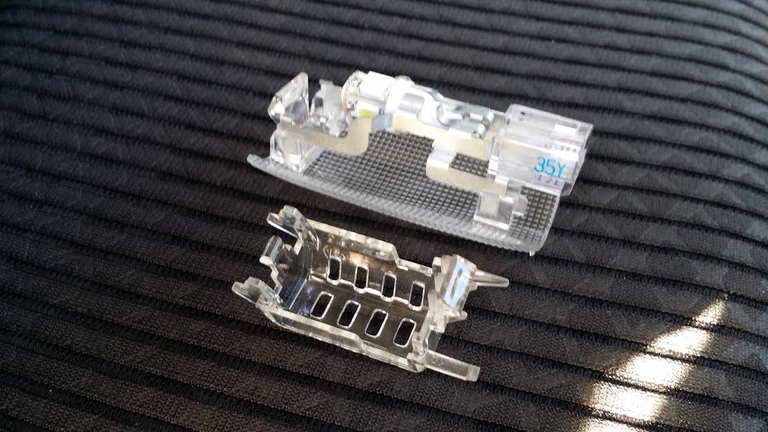

i will snap a pic of mine when i get off work today and post them up
Got sidetracked working on my mother in laws computer and building another and didn't have time to grab the pic. I will get one today, tried just a minute ago with my computer tools but don't have anything to pry them loose without marring the door panel.
Here is a pic of the housing separated into the two pieces. They do fit, its snug but the second piece will slide down over the bulb and you can reinstall. Just make sure to put the bulb light end side on first and then it will slide over easier. From the pic, the bottom part's shorter end goes toward the plug and the longer end has a circle cut out of it to allot for larger bulbs to bump up to it. Start that end first so the bulb will sit in the circle as the shorter end clips in. Hope this helps.
thanks for posting...looks like my bulb is bigger then yours. I think I will have to either leave the housing off or dremel it out...or get smaller bulbs
