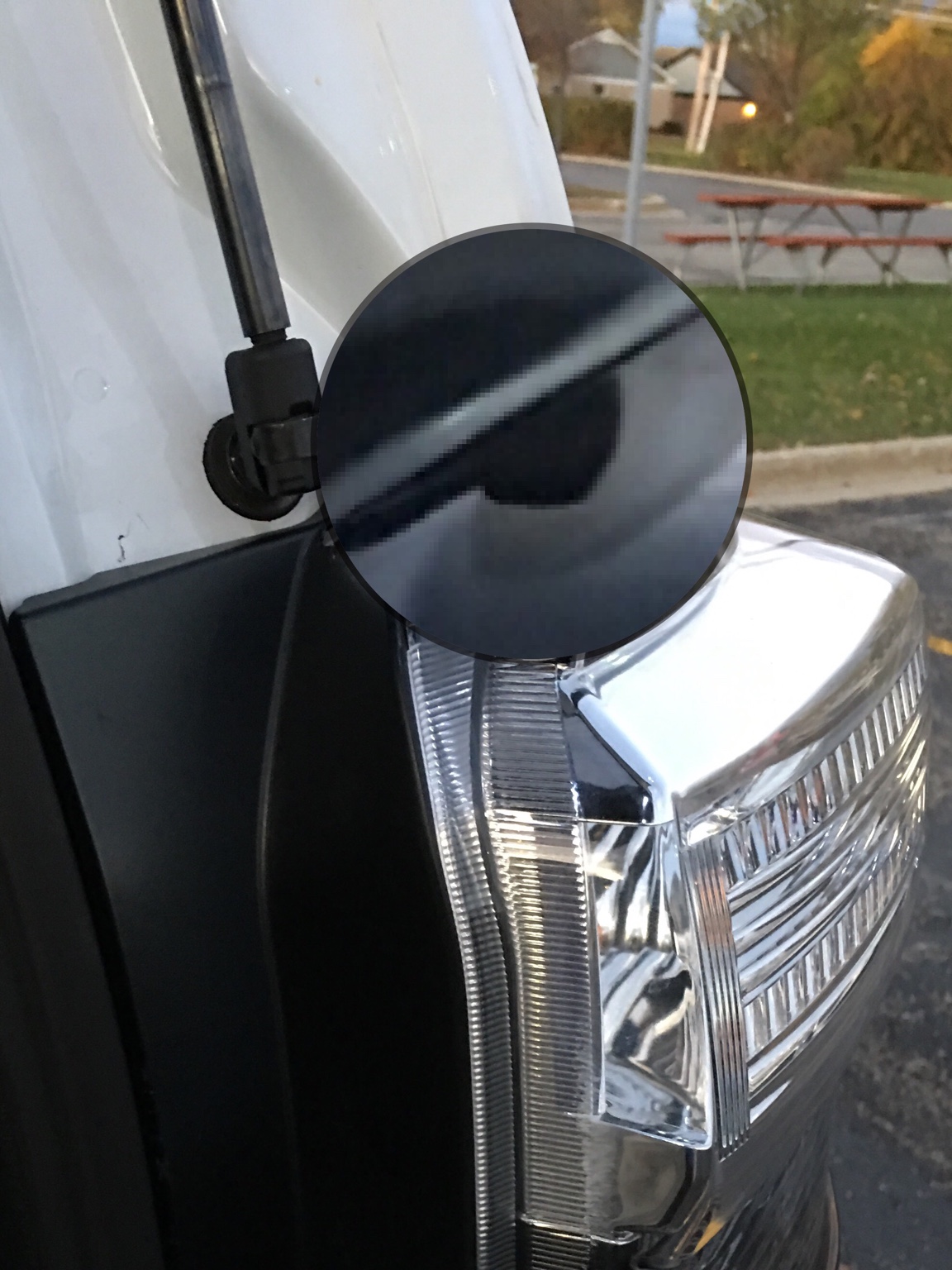

This forum is great: lots of inspiration for mods, cool trip reports, tons of great info, etc. (Goodness knows that some of posts have cost me some money after reading them :rolleyes: ) Sometimes the posts I get the most out of are the ones when the OP is willing to fess up to their mistakes. So, along those lines:

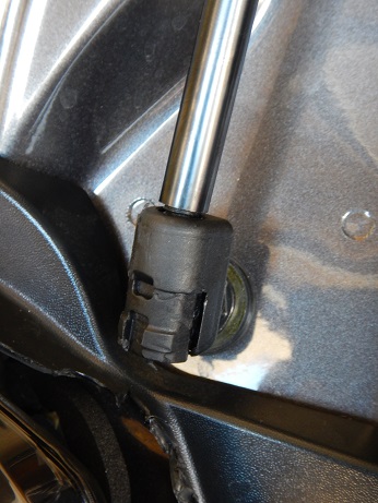

I purchased a new light bar, and drove to the shop to pick it up. Several days earlier I had my Gobi installed, and I replaced the hatch struts to a beefier version from Lift Support Depot. It seemed like they went in without any problem, but if I'm honest with myself, I recall fiddling with one of the retention clips a little more than the other 3. I remember pulling on the struts after I installed them, and they stayed put on their mounting points. Anyway, I put the light bar in the back of the 4Runner, and while I'm closing the hatch I hear a "PING" followed by a very loud "CRUNCH". Turns out one of the retaining clips had popped off and when I brought the hatch down to close it, the lower end of the strut released from it's mounting point. (Never found where the clip flew off to ) Unfortunately, the combination of the weight of the hatch, the strength of the strut and the positioning of the 2 caused the lower end of the strut to punch right through the driver's side tail light housing.
Missing retaining clip ^

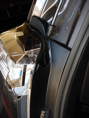

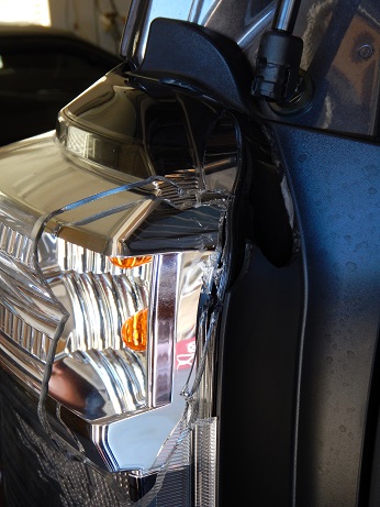

No Bueno ^

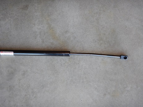

With only one strut holding up the weight of the rear hatch, it all came down on the skinny arm of the strut hard enough to bend it.

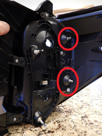

End result: new tail lamp housing (really needed to pull hard after removing the 2 nuts from behind the unit to get it out: 2 red circles show the where the tail lamp housing gets pressed into the body of the car) new strut, $250 less in my wallet and a lesson learned. I'm thinking it could have been worse: I could have screwed up the hatch, gouged the paint, a plastic shard could have poked my eye out, etc. Wanted to share this particular episode with the forum as I haven't seen this specific F***-up mentioned.

Sorry to hear about your unfortunate incident, could happen to anyone in my opinion. It takes heart to post all this, I like to see people be real about their mods/repairs. I strongly considered the TRD CAI until I read between the lines on a few posts and one member who flat out said "it was one mod he regretted doing."
In the end I'm sure anyone else that reads this and is about to replace their hatch struts will be very meticulous.

How ironic I had the exact same setup and same issue. Liftdepot heavy duty strut came off for me on both sides on different occasions. Also broke through my taillight housing.
I was so frustrated with the struts I just took them off and went back to factory installed ones. I will deal with the weaker lift capacity versus dealing with what I think are unsafe struts.
I contacted liftdepot and ironically they said don't return them and issued a refund after I said I would not use them.
Same repair costs. New tail light some paint scratches and bump on the head
Lesson learned not all Mods are good Mods.
Hehe, exact same thing happened to me a few months back. When I initially switched out my liftgate struts to the beefier liftsupport depot models a year or so back, I didn't watch the video and had no idea that you could just push and click them on to the ball studs. Instead I pulled the clips out with a screwdriver and pushed them back in once the ball was in the socket, drastically reducing the holding power. Earlier this summer one finally just let go (surprised they lasted that long). Initially the passenger side just let go internally and was just hanging there when I opened it up. A week or so later (while I was waiting for the new ones to arrive from the same vendor), POW!!! and right through the tail light. With USD to CDN exchange the way it is right now, it was more like $350 delivered for the new tail light assembly from go-parts.com, but found it super easy to install.

1. Do not ever take the clips out. Push the socket on to the ball stud until you hear a positive click in to position.
2. Use two hands closing the lift gate, one on either side to equalize pressure between lift struts (or one hand in the middle), as to not put too much pressure on one side.

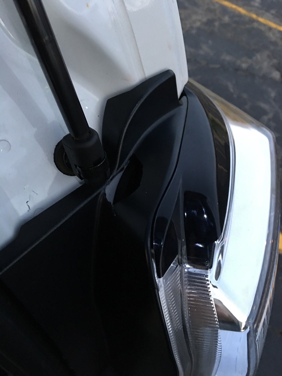

same here, let slip for a second and crack right side black plastic. super glued it back and putty weld.
