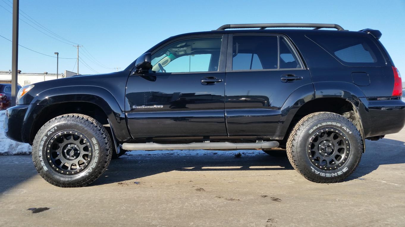

Here is mine...
Old setup with 1.5" DS spacer in the rear and 1" DS Budget Boost in the front.
Edit: [MENTION=119901]Kingkouie[/MENTION] , I'm getting that same wheel/tire combo soon (assuming your Generals are 265/70/R17). Hows the fitment? Are you running wheel spacers? Love the look!
IMAG0151_zps8176e68c.jpg~original
Yes
Front tires will rub when making sharp turns, but you will have to shave off small parts of the front bumper. Shave off parts of your mudguards. Move the front inside wheel well covers forward a little. Yes, I have Spidertrax Spacers on too. Everything will be worth it because it's an awesome stance. Many great comments from people that appreciates a clean aggressive stance.

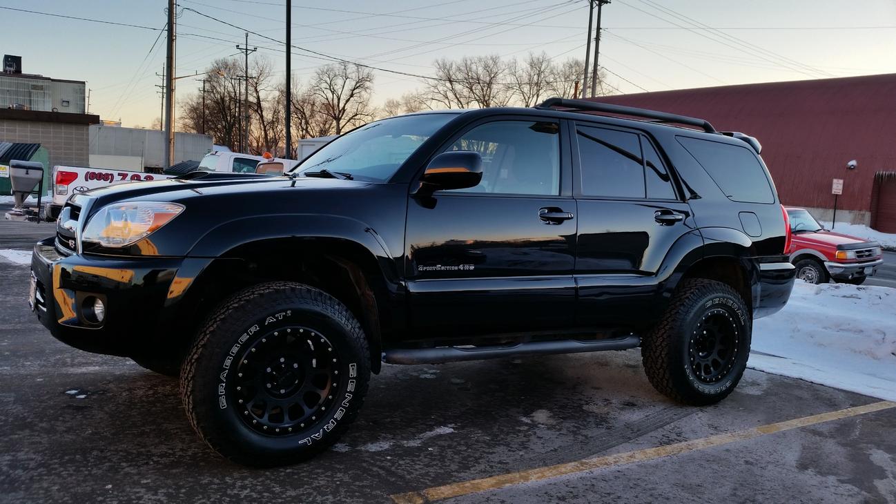

Here is mine plus a 1/2" body lift. My ride didn't change at all compared to stock. This is my 5th lifted Toyota (2 3rd Gen 4Runners, 2 2nd Gen Tacomas, all with new springs/shocks) and this one rides the best.
The ride remained the same, i love the clearance now, i'll be driving in the snow like its nobodys business, lol
