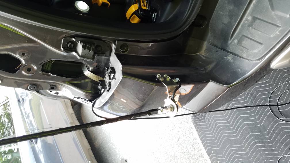

Did a rear jamb kit for cb. Ground strap off the back of the bracket to inside near where the light is. Swr is about 2:1.
Lip nmo for ham. I just have a cheap small antenna for day to day. Have a much larger browning for better range

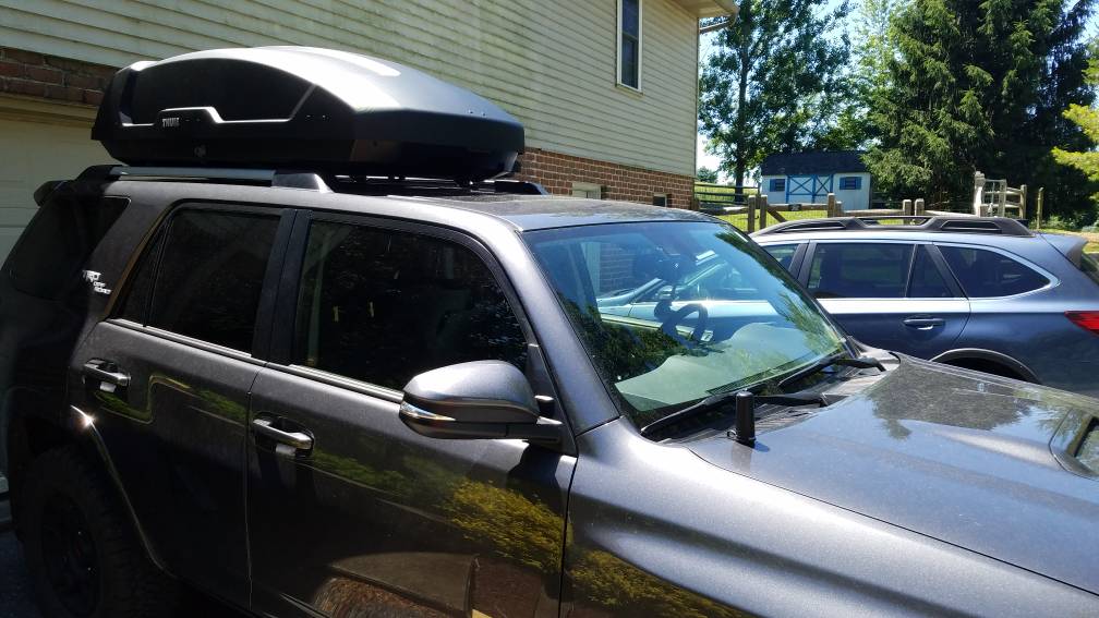

Wondering if anyone has used a clamp type mirror mount CB antenna mount on a factory cross rail with a ground wire going to one of the roof rack mounting bolts as a ground?
When I had a Jeep Liberty I had one mounted thatcway and it worked quite well.

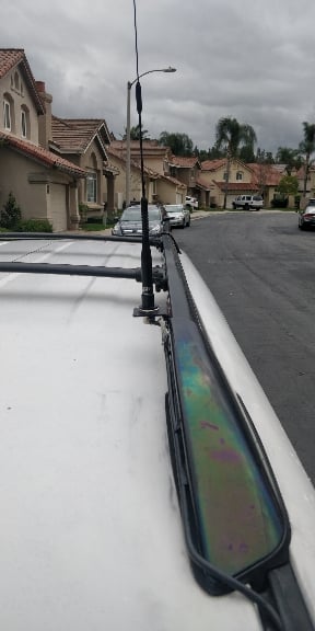

I run CB antenna cable through back hatch. There one spot in top of back hatch where cable can be pulled free when hatch is closed. Then I route it down the left pillar and cable enters inside the trunk at the bottom, soft hatch seals don't damage the cable.
I have my antenna attached to Thule crossbars and I remove crossbars and antenna during winter so it's on my roof somewhere from April to November. For last 5 years that setup worked good, cable doesn't have any visible damage.
And antenna attached with mirror clamp mount, but I have to use some bending and longer screws since Thule crossbars have not exactly same profile as mirror bars. I think I spent few hours trying to mount antenna the way it's stays in place even after I hit trees with it (I got spring mounted antenna of course). So when I remove crossbars for the winter I keep antenna mounted on crossbar.
But I run my antenna mostly for offroading, and since I didn't want to make any holes I picked no-ground plane Firestik kit. It work well for me on trails and on highways I can hear trucks I don't see, but I would assume that grounded antennas work better.

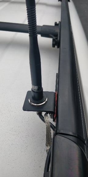

anyone have a mount idea for the side rails of the 2010-13 TE roof racks? I want my cb antenna to be on the roof level, and be able to fold it down when im not using it. i cant tell if the mirror type mount will work or not.
also im looking at ham radios (gonna study for my test during quarantine) and are those little stubby NMO's are all you need antenna wise?
