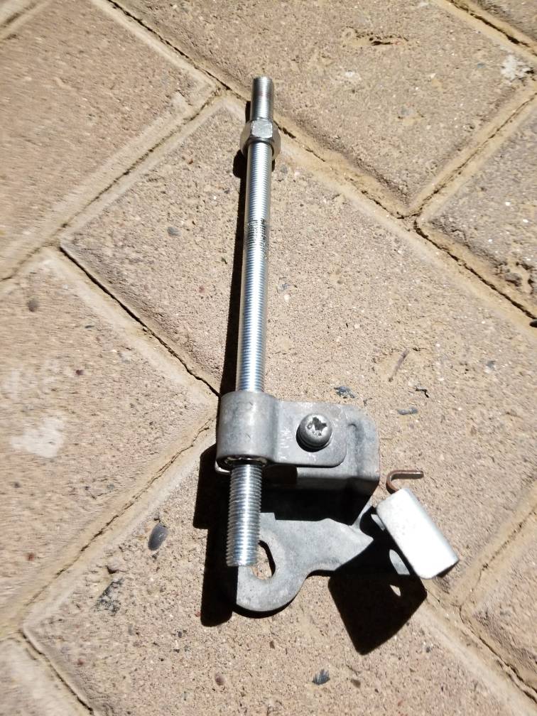

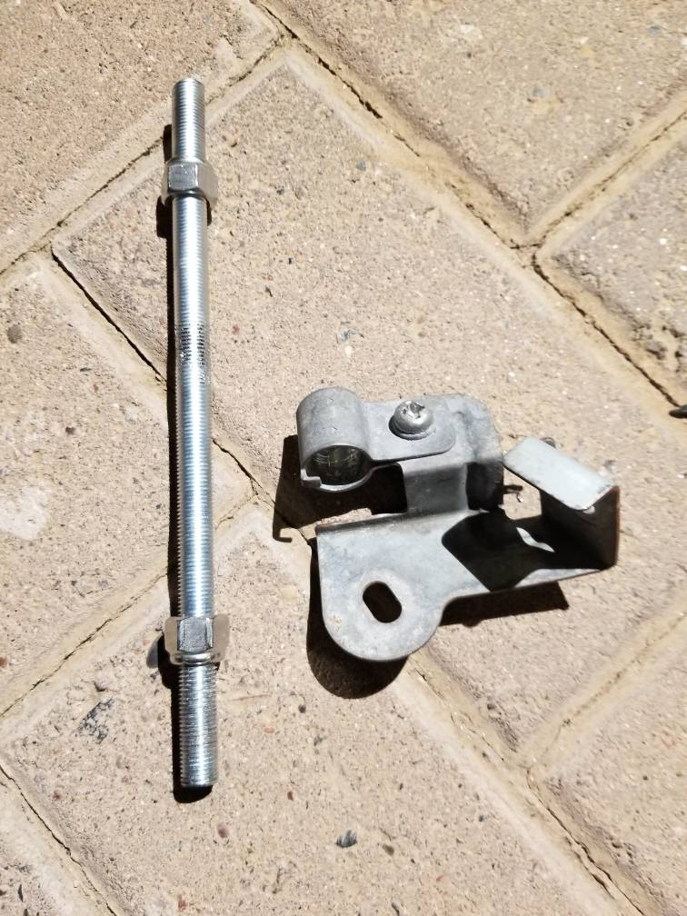

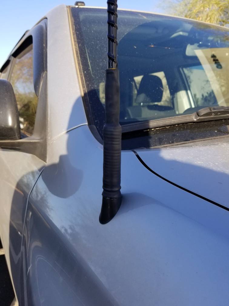

Honestly I think changing the OEM antenna out is the best route. I did it and love it.
Sent from my SM-N950U using Tapatalk

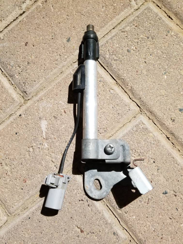

Can you please be so kind and post what is needed to swap out the OEM part? Any tips/tricks?
I'll do a write up on it tomorrow or Friday. I'm at the hospital right now waiting for this kid to pop out. For now here are some pictures of what I took off and used: Pic1 - OEM antenna mount in driver side fender. Pic2 - threaded rod cut down to height, took a couple trimmings to get correct (factor in that you need enough thread exposed for the antenna spring to screw onto. Pic3 - this is a temporary fix untill I redo the setup this weekend (installing new fender and snorkel), this has been installed for a few months now though and has been on plenty of 4x4 trips with zero issues.

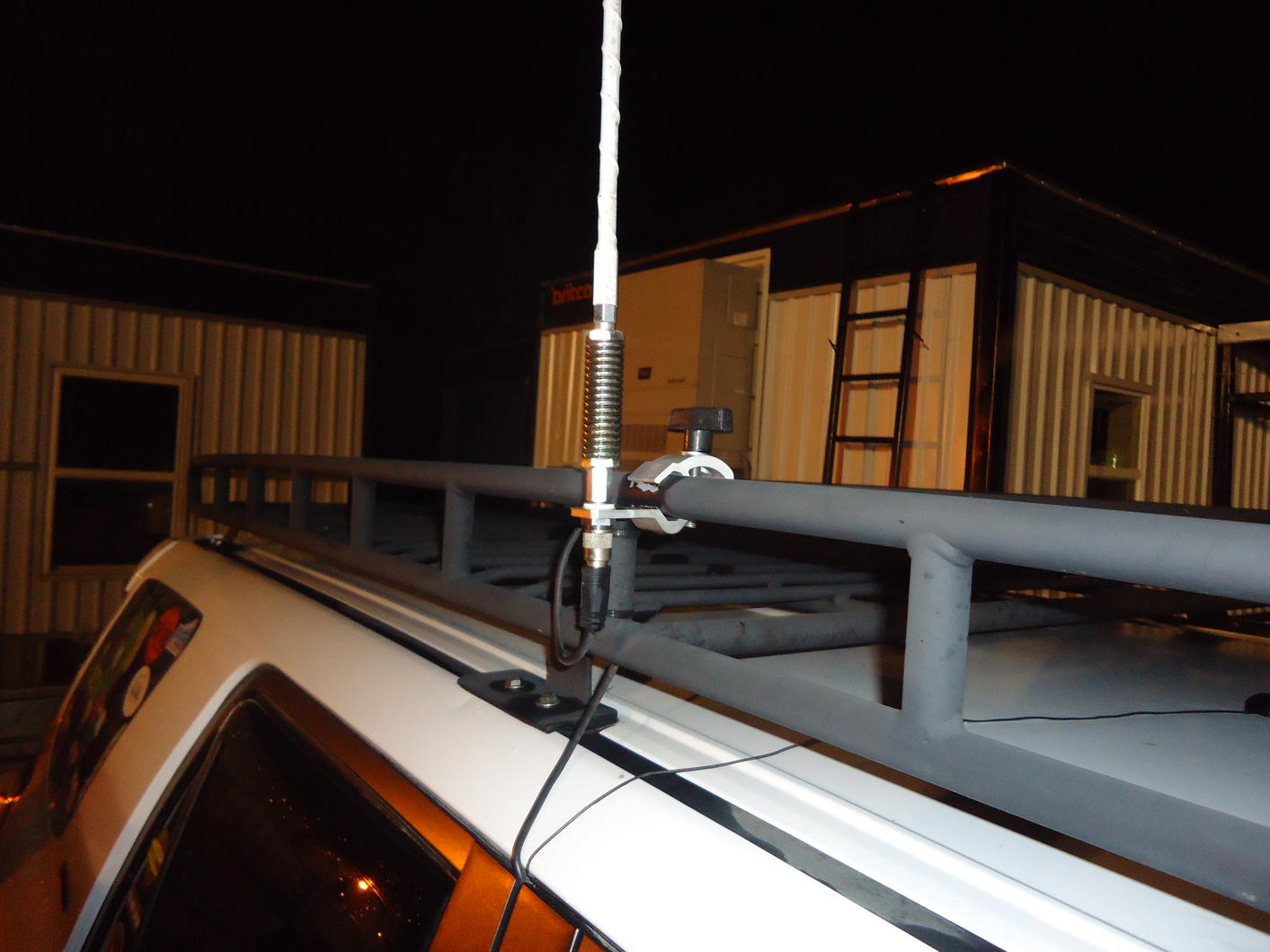

Firestick antenna on a trucker's mirror mount that bolted right over my Baja Rack tubing. No ground run, but it works fine for the distances we use off road. No complaints from other drivers.

Thanks for the picture. I can't really tell, but did you purposelessly rub off the powder coating where the clamp sits? I am wondering if that is how you are getting your ground. I had read that you needed a ground to get good reception, but you have proved that wrong.
I am still deciding which route I want to take, but if I do it like you, I was going to run a RF ground to the mounting bolt that attaches the rack bracket to the roof. I tested those bolts and it appears they are grounded.
So grounding the antenna is only for getting better reception? I'm pretty sure the distances from the other rigs can be done one 2 ways. I just didn't know what the reason for grounding the antenna was for.
I'm actually running one of these now. The one pictured above moved around the tubing too much and caused the powder coat to peel.
https://www.amazon.com/MIRROR-MOUNT...2&sr=8-2&keywords=cb+antenna+mounting+bracket
This one can be tightened better but you should still expect some damage to the powder coat unless you run something soft between the mount and the tube. A ground is still a good idea and one I had eventually planned to do, but the CB has worked better than I expected on our group runs. So I just never got to it. Your roof rack bolts will go into steel threaded sleeves in the roof so a ground like you describe should work. I have transferred the antenna to an all aluminum SSO roof rack now and only use the 90 degree side of that bracket bolted to a crossbar. Still no ground. During a recent trip to Oklahoma we spread our convoy out to see how everybody radios did. They told me my transmissions started getting a little fuzzy at around 1/2 mile from the nearest vehicle. I'm sure it could do better, but again I only use it in groups and that distance is acceptable to me.
One thing I would recommend if you go with a roof mount is a spring at the base of the antenna. It's going to see a lot more hits higher up. Several people in my group get quite entertained watching mine flopping all over the place in our dense woods.

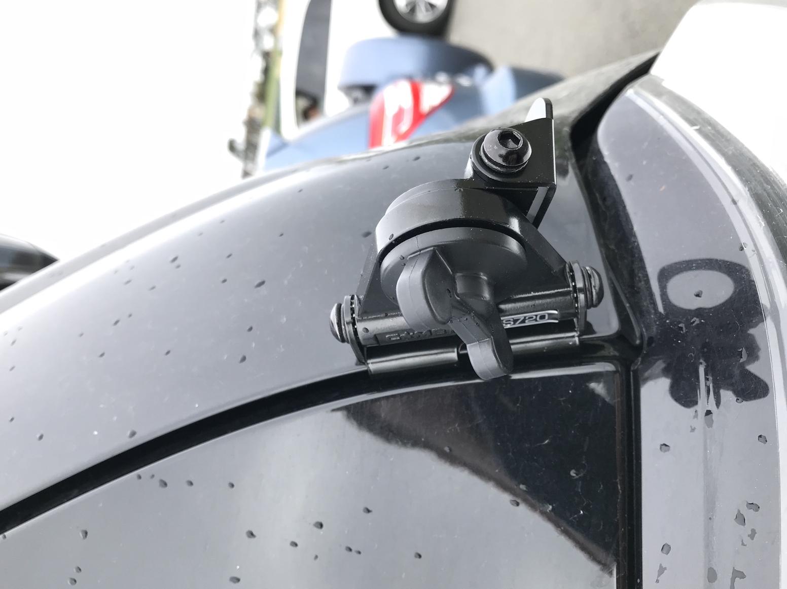

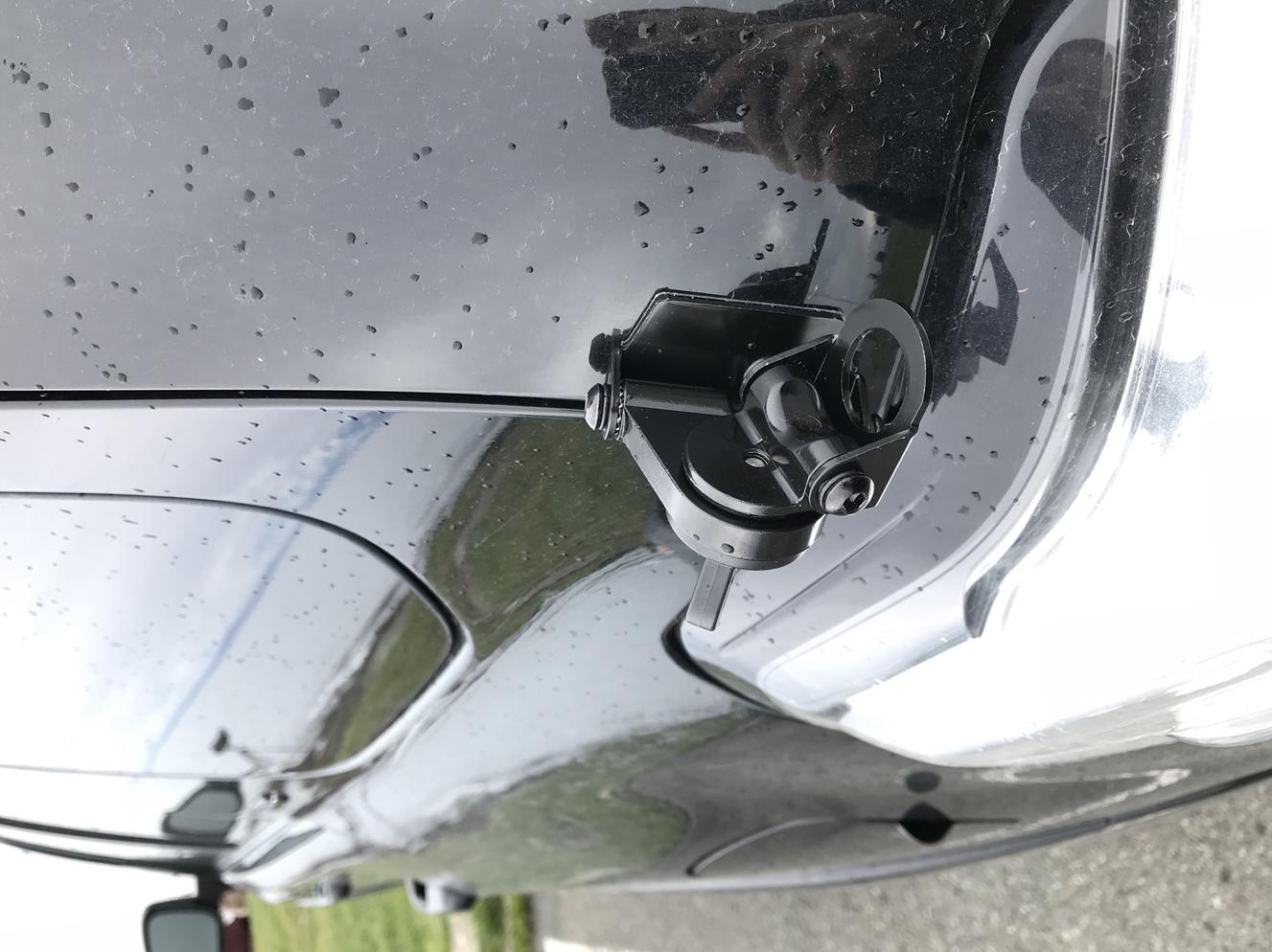

Picked up the RS-720 from DX Engineering. It’s a clamp that fits perfectly on the side of the rear hatch. I liked it because it wasn’t permanent, no drilling, height and angle adjustable, and lifts with no issues on the gate. Still have yet to wire it up to my CB but I’ve seen the final product from a guy on instagram - [MENTION=141062]sponsoredbywifey[/MENTION] - and it looks great!
Where is your cables running into or around? I believe I am going to get the same one and just curious how you ran yours. THANKS
So I have seen some pretty creative wiring, & you kind of have to be with this one. As for the ground wire, I drilled a small hole in the bumper above the bracket & just ran that wire to the frame (if you're already drilling 3 holes, why not do a small 4th?). The actual coax got zip tied back up the mount & ran thru the same hole as the ground wire (used a rubber gromet to clean up the appearance & small amount of silicone to ward of unwanted water going in it). Then I ran the coax thru the side panel, via accessing it thru the jack location pannel & then pulled it thru with a wire hanger thru the hole in the panel where the rear seat adjustment bracket thing is. Then just ran it up front under the door kick panels.
Good luck, it's a fun one!

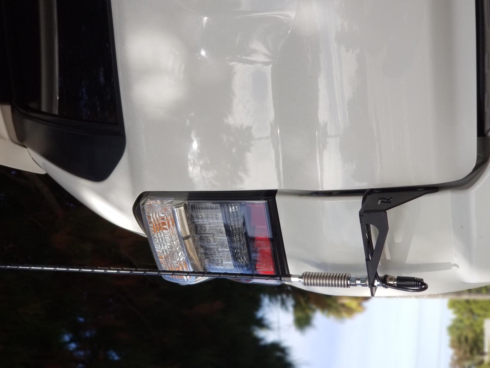

*Edit, don't know why the picture came out sideways...
