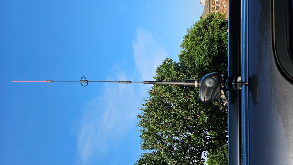

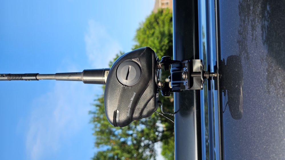

No CB here but HAM radio and GMRS.
Currently mounted to the factory rails until I can replace the roof rack with something nicer. Antenna is mounted to a motorized folding mount which works great in parking garages or in areas where you need to sneak under a tree. Hope to mount the motor portion a little more hidden once the rack is replaced.

I'm not a firm believer in that either. I use antennas that don't require a ground plane so mounting in the center of your vehicle is not necessary. I had dual antennas mounted behind the cab of my 05 Tacoma on the bed rails and attached to motorized folding motors for parking garages. Just posted above my current setup on my new to me 2023 4Runner.... Taco got totaled by a teen not paying attention. 19 years of service and 303k miles. Ugh. Not fun wiring everything up again on a new vehicle.

a lot of old crusty hams will say you must mount dead centre and you must drill. of course that will be the BEST solution. but really a mobile unit in a vehicle is a compromise in the first place. there is so much electrical noise from a moving vehicle and line of sight impeders for vhf and to an extent uhf that you can't get perfection in a mobile mount. I had a ground independent antenna from comet, it was the sbb5. had SWR 1.7 or lower on both VHF and UHF FM bands. pretty impressive antenna. also had an ss680 which technically wasn't ground independent but still had good SWR as well. with that on the roof you should get good reception and broadcast

That's cool, I didn't realize motorized antenna mounts were a thing. Very neat!

Diamond(R) Antenna ~ K9000LRM Motorized Luggage Rack Mount
Here's a link if you're interested. I had dual antenna's on my Tacoma before it was totaled and parking for work was in a parking garage. Loved these and they worked perfectly. Since my OP I replaced the switch it comes with with one from OnBoardAir.com and a relay. Fits where the seat heater switch would go.
For the Tacoma I modified the mounting bracket so I could attach them to the truck bed rails. For the 4Runner I just used it as designed. If you have an aftermarket rack like a Prinsu or Sherpa it's super easy to modify the bracket for your needs.
