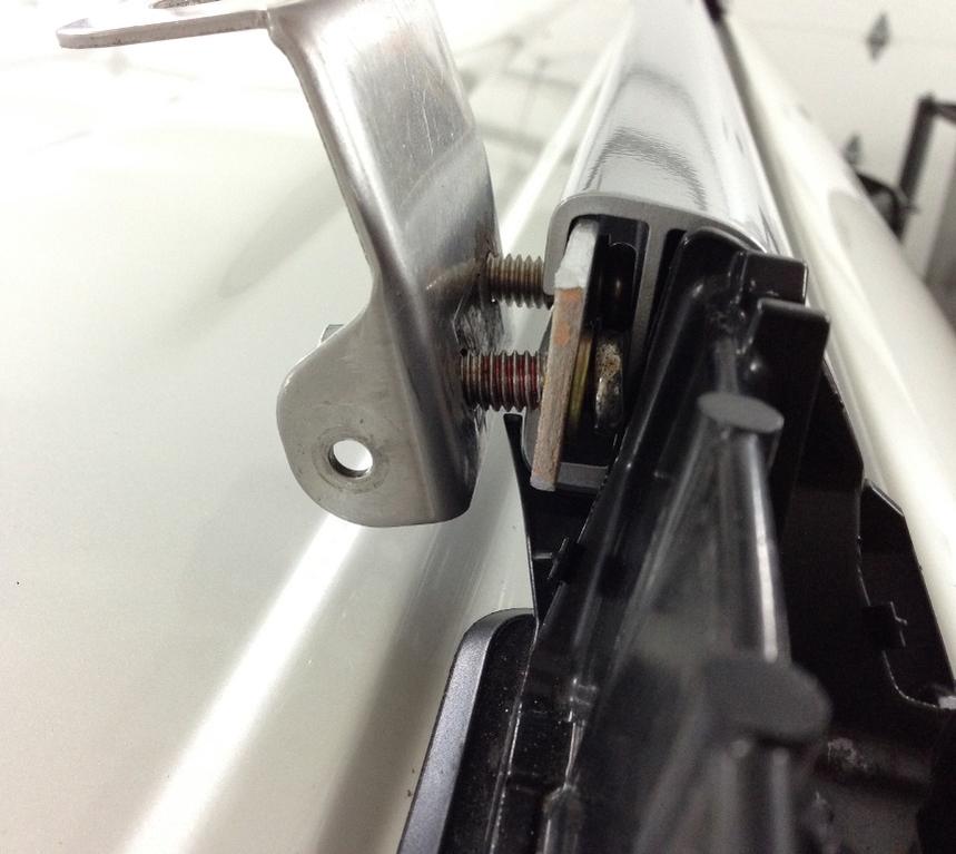

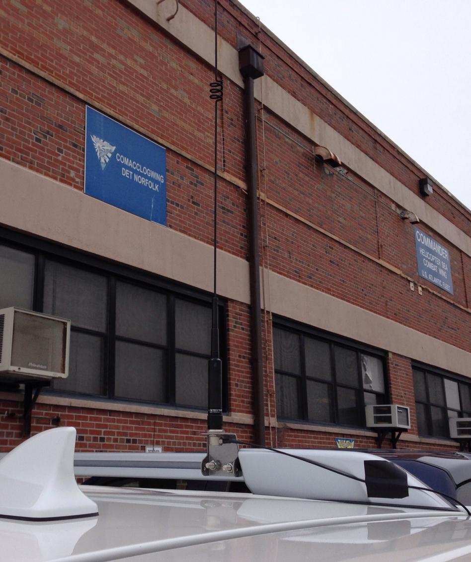

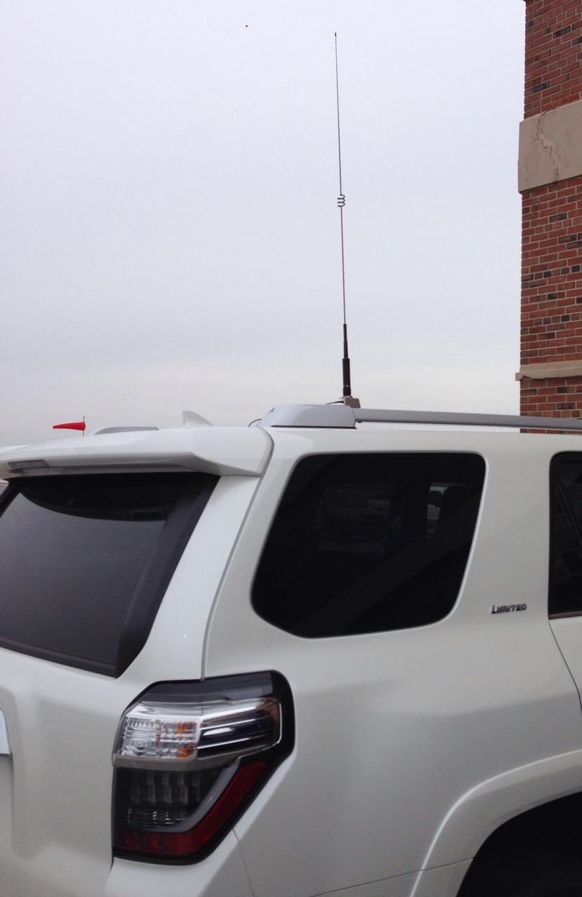

I just installed this last night and still on its "shake down" phase :) VHF/UHF antenna, home brewed mount right onto the OEM rail.
Although this is anV/UHF (2mtrs/440) but small to medium CB antenna like ones with quarter waves with loading coils, could be installed in a similar manner. CB freq (27-28mhz) though will need a good grnd for this base.

Does OEM rail provide ground for the antenna or how did you ground it ?
I know this thread is " CB" but jst want to show this mount for ideas. This is a VHF (146.500MHZ) and its not necessary for that freq. for CB which is in the HF Band 27.205MHZ +/- it is vital. On my other truck where i have even lower bands i connect a stainless braided wire from the bottom mount of the antenna base and onto a good grnd contact on the roof.
Gents, just sharing my experience. Ive been in ham radios since I was 12, am now 49 :(..
I see some antennas that are butted againts the body of the trucks. Not good at all as it will either detune the antenna and definitely block your signal on that side of the propagation for long range coms. Few miles distance or caravan/convoys is fine to get your signal out.
Center top of the roof would be the best. The roof acts as your ground plane.
BUT I know its hard to find a compromise spot for a 9 foot antenna specially when your trying to get to garrages & drive throughs. Foldable units would be my suggestion. Just my humble opinion.

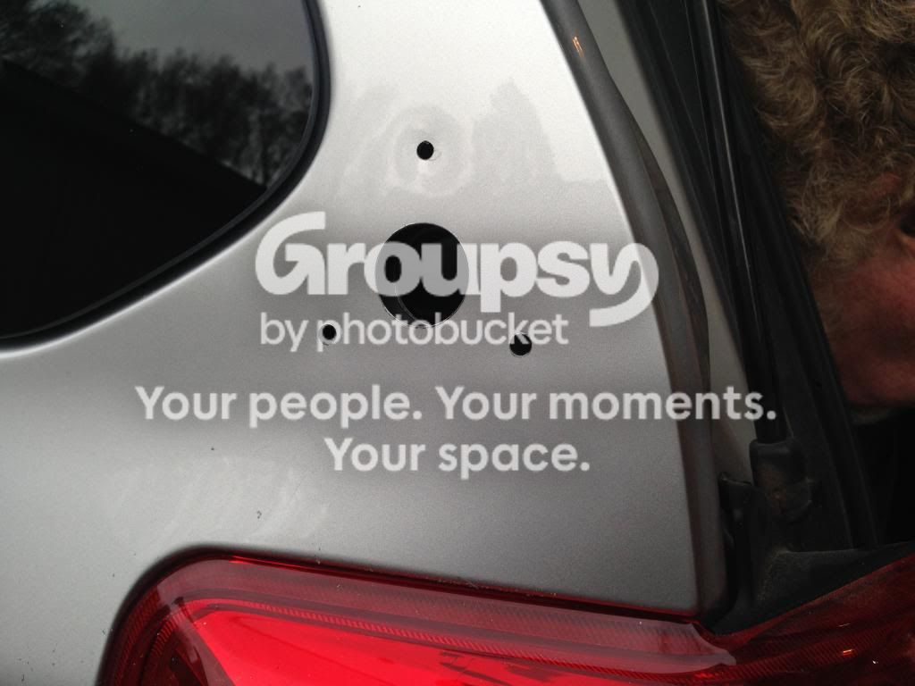

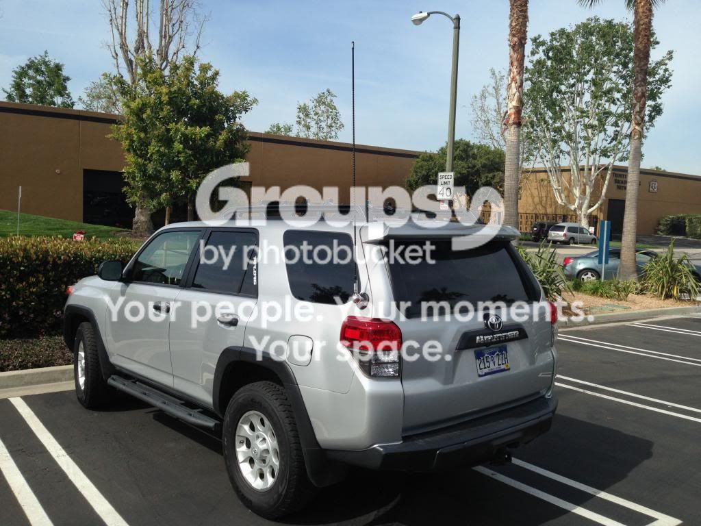

After perusing as many mount locations as I could find, I settled in on left rear by gas cap door.
IMG_2867_zpsc90f967a.jpg~original
It's a PERMANENT installation.
IMG_2852_zps0cba81e4.jpg~original
I followed closely the threads about how to install an antenna at the rear to route the cable from inside of body forward to go into console just to right side of driver's side. Hardest part was getting the cable through the molding at rear of rear passenger seat.

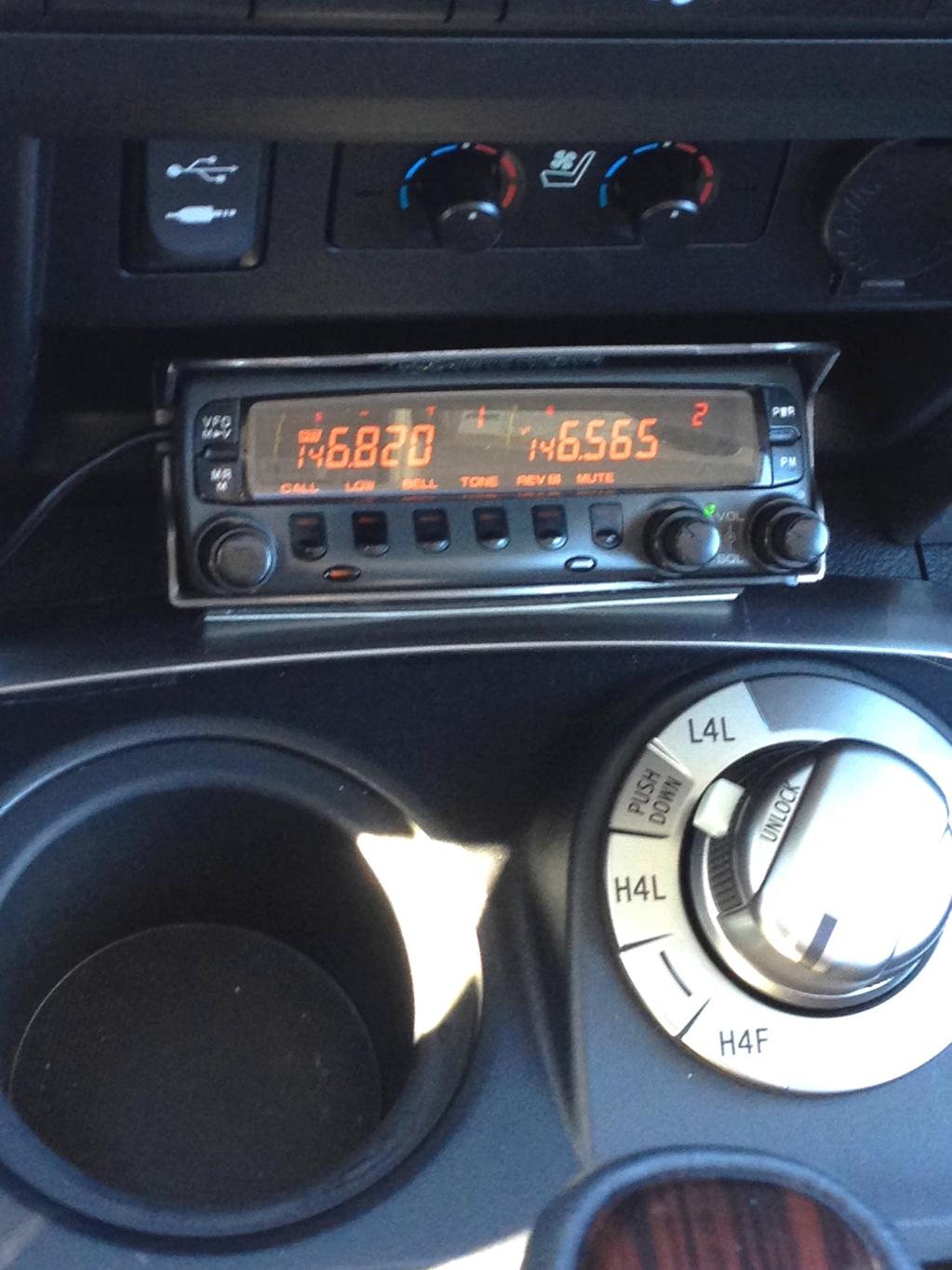

A Uniden CB is mounted on outside of console next to my right leg.
IMG_2874_zpsab0b44f6.jpg~original
Power wire was run under dash, through existing grommet and wired to battery with an in-line fuse.
