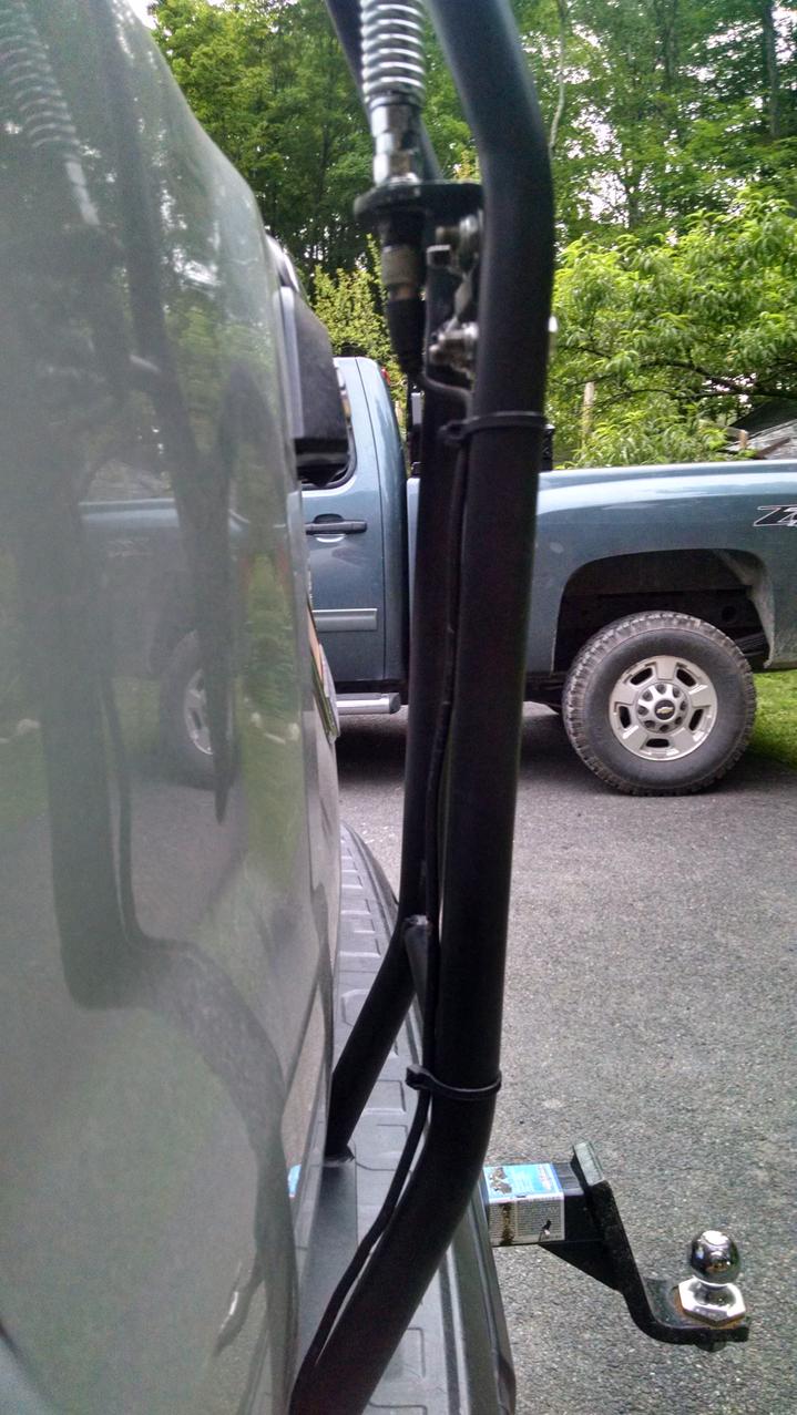

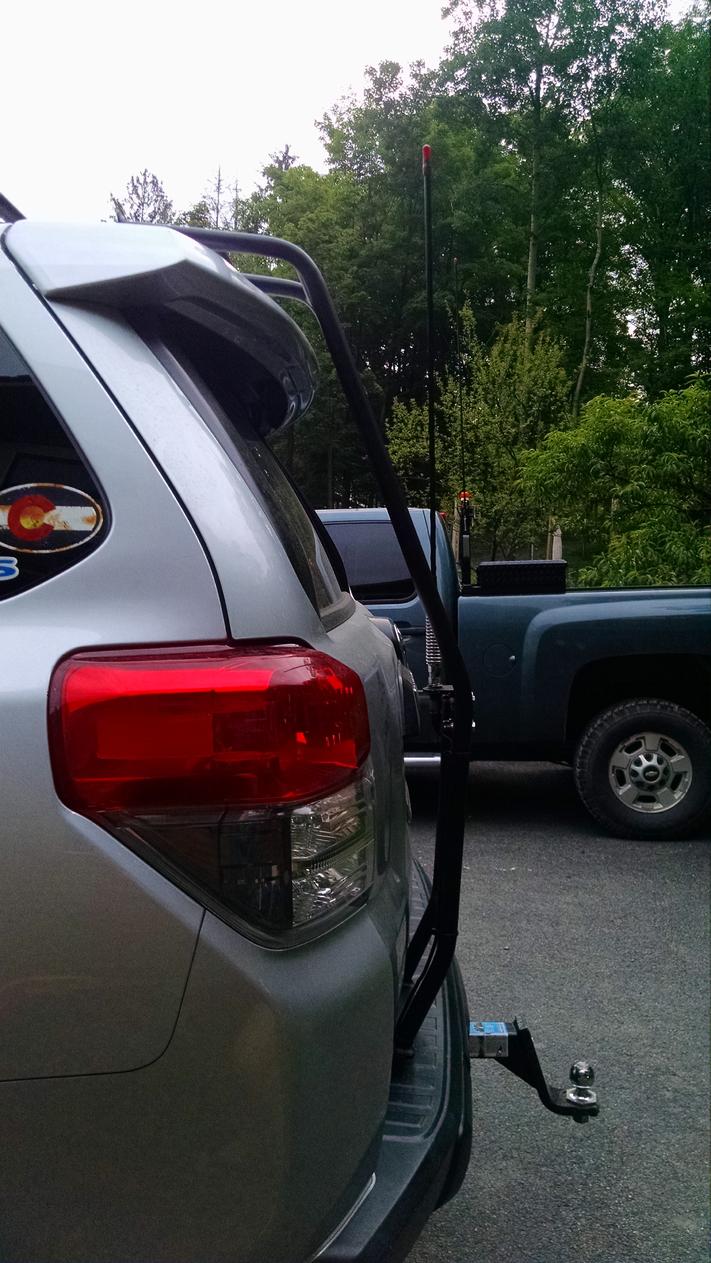

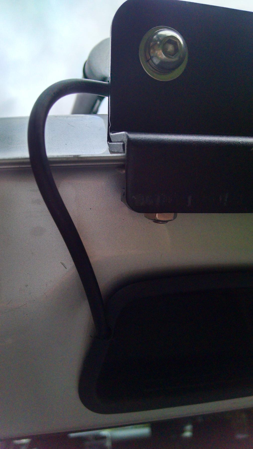

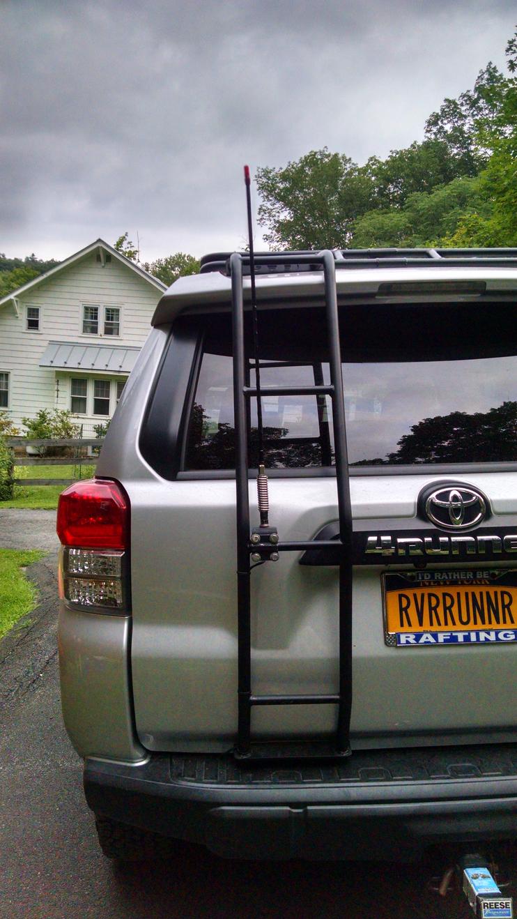

Antenna mounted to Gobi Ladder
OK, so I originally had this mounted to the back of the liftgate, but the bracket my husband made started flexing backward, and so did the antenna.
This is his next idea. Will need a longer antenna, but I'm really happy with how clean it looks. He picked up the bracket at a truck stop. I climbed the ladder and it was fine; on the way down it does help to have the antenna on the left side of the ladder.
Next up: [MENTION=65614]Antman[/MENTION] cb surgery to lower the housing an inch!!!

i don't know how half of you guy get a decent ground. you must not be using your CB to communicate further than the line of sight
