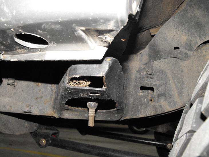

Here's the front, it took alot of work but I managed to cut back the frame work surrounding the body mount and weld an concave chunk of steel in place to give some clearence. Looks like I didn't clean it so well before I took some pics, whoops...

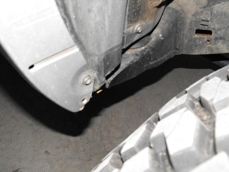

Here you can see where and how much plastic was cut out to ensure no rubbing. Also, I drilled a pretty massive hole so that I can clean out any mud/dirt that gets up in there by spraying high pressure water in from either the hole or the wheel well side.

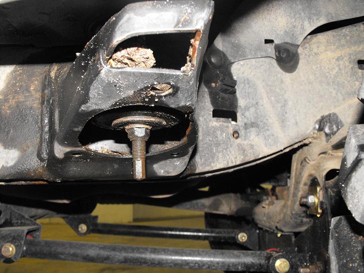

Here's a view from above to give a better idea what the tire is dealing with.

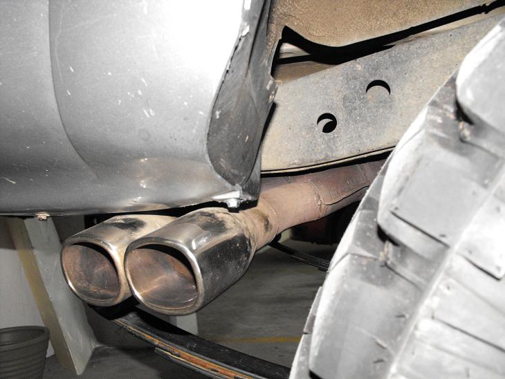

The back end was alot easier, I simply cut back the bumper plastic, leaving the wheel well as it is and then folding it back and bolting it on the bumper.
At full flex I dont rub anywhere, regardless of where the steering wheel is. Neither wheel well requires any trim on the forward end as I have a front bumper that is far enough away and the rear leaf springs pull my axle aft when flexed.
