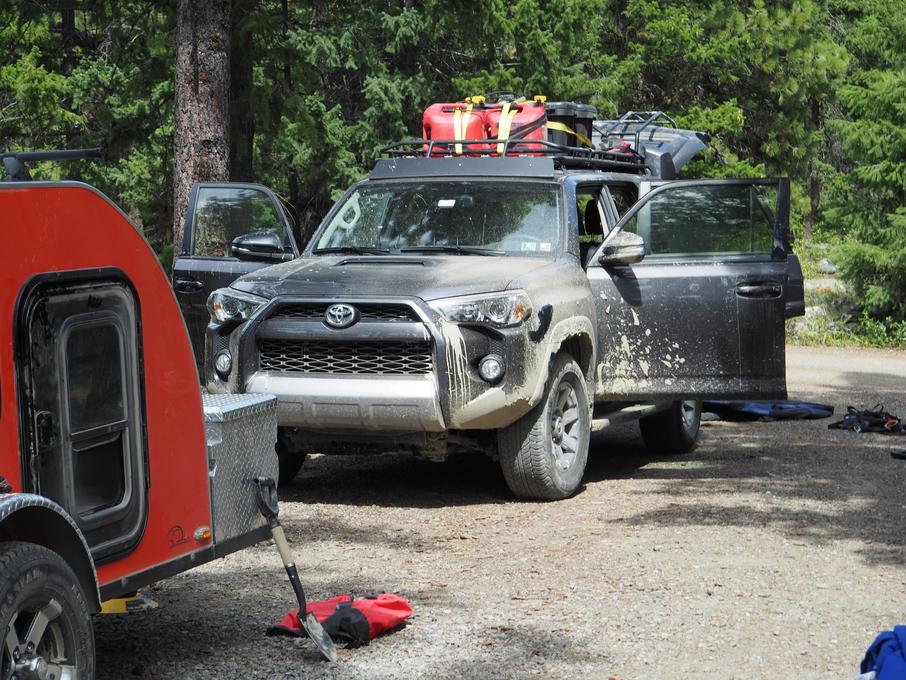

A few quick (?) questions:
(1) Would you go 5100's all around? (This summer towing I'm towing a ~2000 lb off-road teardrop from PA to UT to Alaska and over to Newfoundland before making my way back...maybe 12-15,000 miles...and I definitely plan to get lost!!!) I was planning to add some TTORSEQ Timbren Rear Suspension cushions to pick up the extra tongue weight, but maybe the 5100s are a better solution?
(2) I've got KDSS, which I suspect may complicate the installation. Is this an issue?
(3) During my normal life, the truck is the family daily driver (compromises!) so I'd like to avoid any lift other than whatever's necessary to keep the vehicle "level". From what I understand, a front set of 5100s can be adjusted for lift, but the rear set cannot...can an all around setup be rigged to that the truck "appears" as before (i.e., stock) in both rake and lift?
(4) Any reason to consider 6112's?
(5) Any winch suggestions...the Smittybilt seems great, but I'm kinda seduced by the wireless Warn (not that I have the cash)...what's so much better about it that it costs so much more?
.....OK, wow, I hope I haven't exhausted the forum's patience!
Many thanks for any help!
