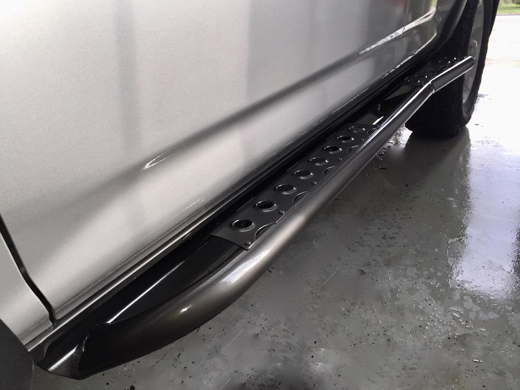

Personally I just ordered the RSG sliders, they will be here in several days. My decision was mostly based on aesthetics. There is also a $100 off code floating around.

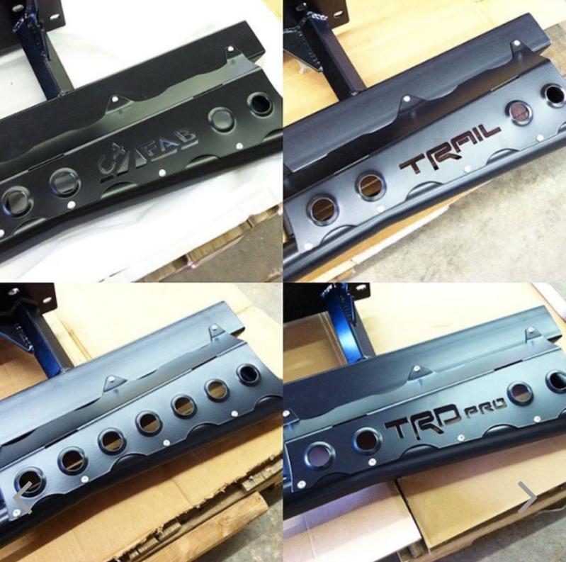

I love the C4 sliders. I got mine when they first started making them and they have improved the design and robustness since then. They protect well, angle up for clearance, are strong enough to to lift the vehicle, and have step plates so I don't have to worry about my dog catching her leg between tubes when jumping in and out. I didn't have to remove the plastic trim on my Trail when installing. Also, you can get the TRD Pro logo in the rear step plates and DOM tubing is an option. I spray painted mine, which I like, because they are easy to keep touched up and I wanted them a different color than black.

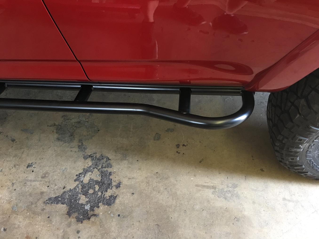

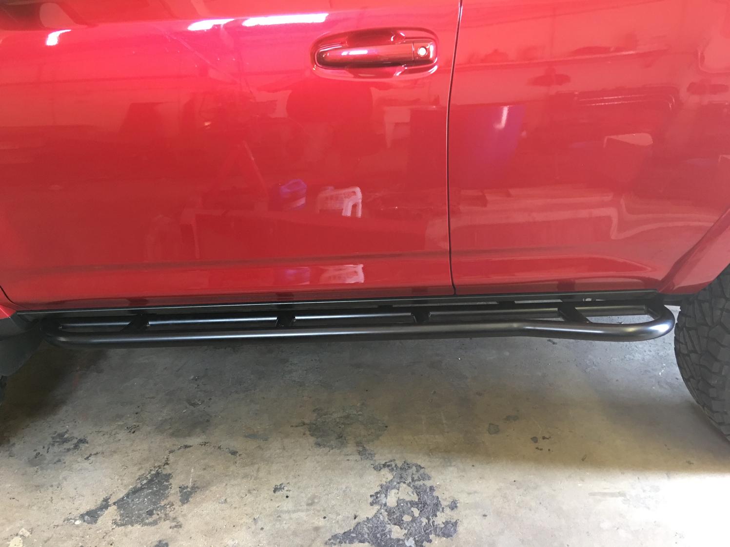

I'm running Avid Off Road sliders. I love them, they are a simple design but look badazz!

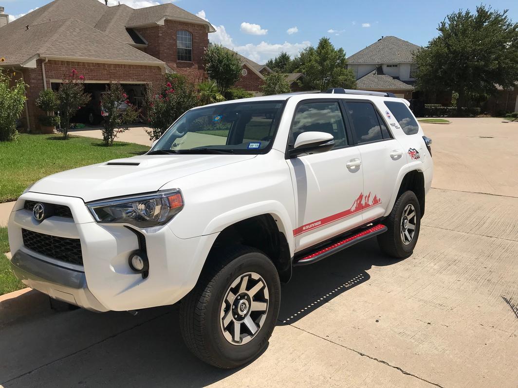

I run the RCI 5 degree sliders with the step plate. Perfect for me. I ordered them directly from RCI with the black powdercoat, then painted the step plate red. High quality.
post a pic please! I was considering these but went with hem running board which look great as an interim solution
Here you go. I'll get a better shot and post it after lunch.
