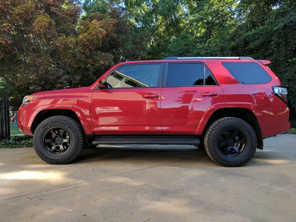

Just had mine installed today. 17x8 ET 0 with 265/70/17 Falken Wildpeak AT3 on stock suspension. I did have to remove the front mud flaps to remedy some minor rubbing at full lock. Loving them so far.

Looks great! Mine is the same color and trying to decide on these same wheels in black or gray. Also trying to decide on offset. Do you have any side shots?
he sent me some, i will forward you the message. check PM. I think i decided on -10
